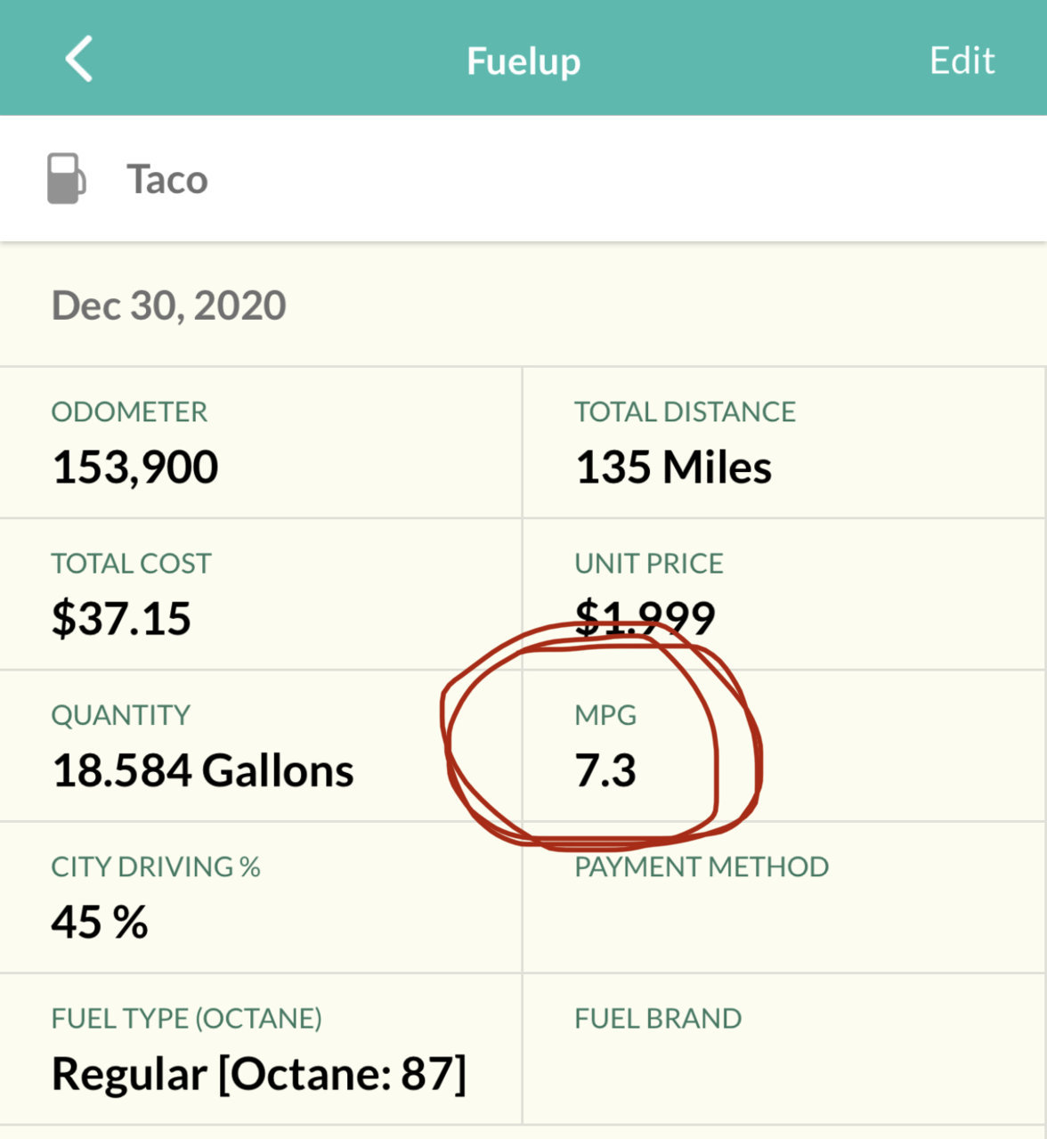

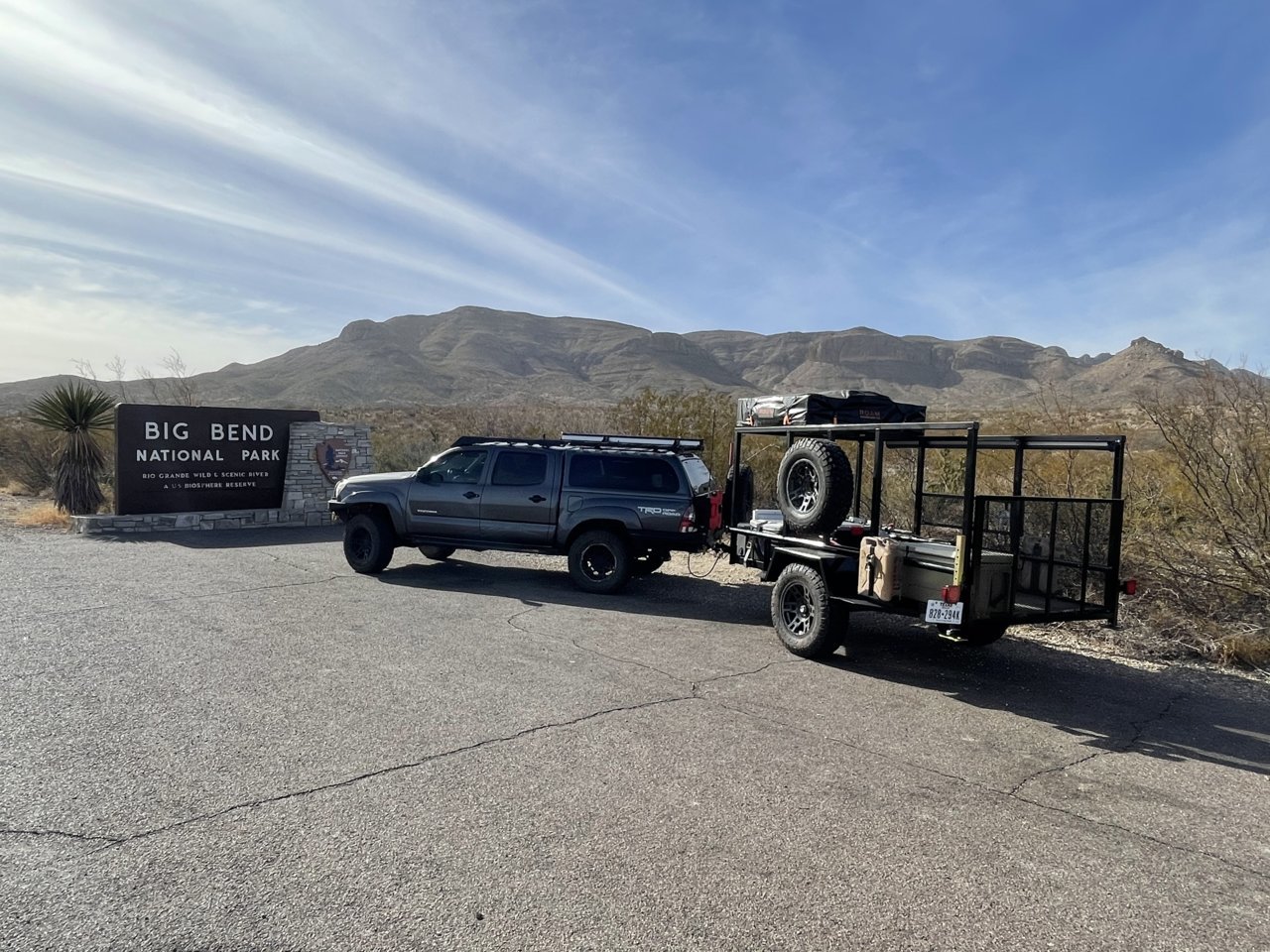

    Looks great man. I would look into options to lower and raise it. The height is probably great at camp but 8.5mpg is killer. Since its slimmer than the width of the trailer it makes me think about ways to have it move down towards the back of the trailer and then back up at camp to be opened and used at its current height. Could use locking pins so it doesnt move from the desired location for travel/camp.

    Agreed. I could even mount it on 4 arms so it moves rearward and down toward the axle, rather than just straight down.
    We have options.

    I don’t like the idea of having to modify it, but I also can’t take road trips at 8.5mpg.
    And I won’t want to lower everything; the rack with the cooking table is at a great height.
    Arguably, with the raise/lower setup, we could have the tent at “full” height when setup to fully use the annex.
    I don’t know. Just brainstorming.

    Could try an air bag setup possibly to raise and lower as needed?

    I've seen some of the trailers where they "sleeved" the posts and used lift struts for the assist and pin them at top.

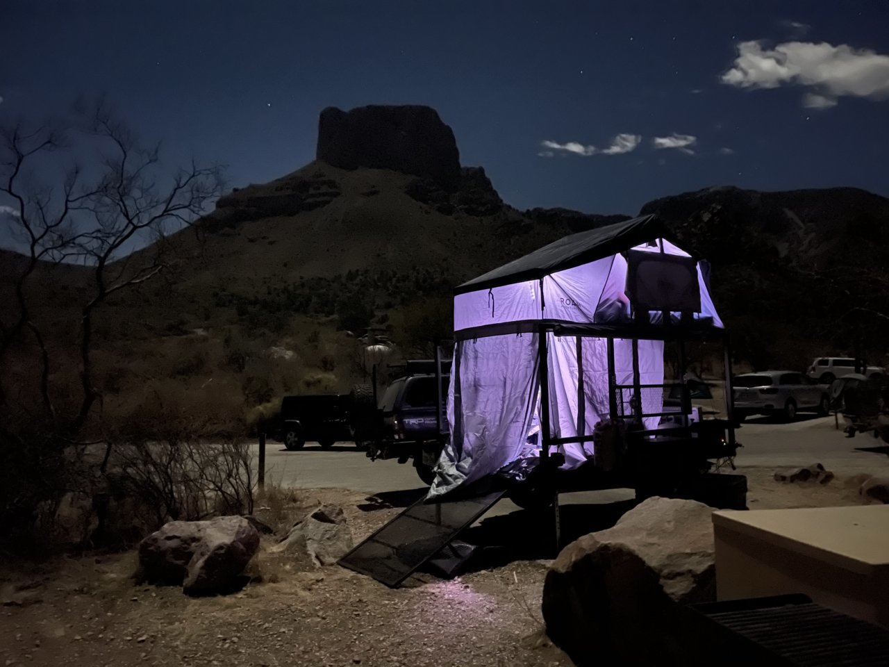

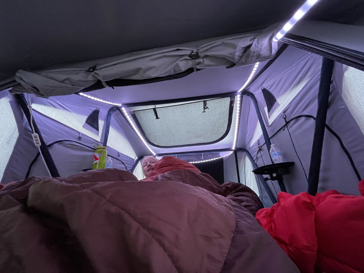

    LED’s work great in the tent at night. Wife highly approves.

    Tent Looks great with the lights on.

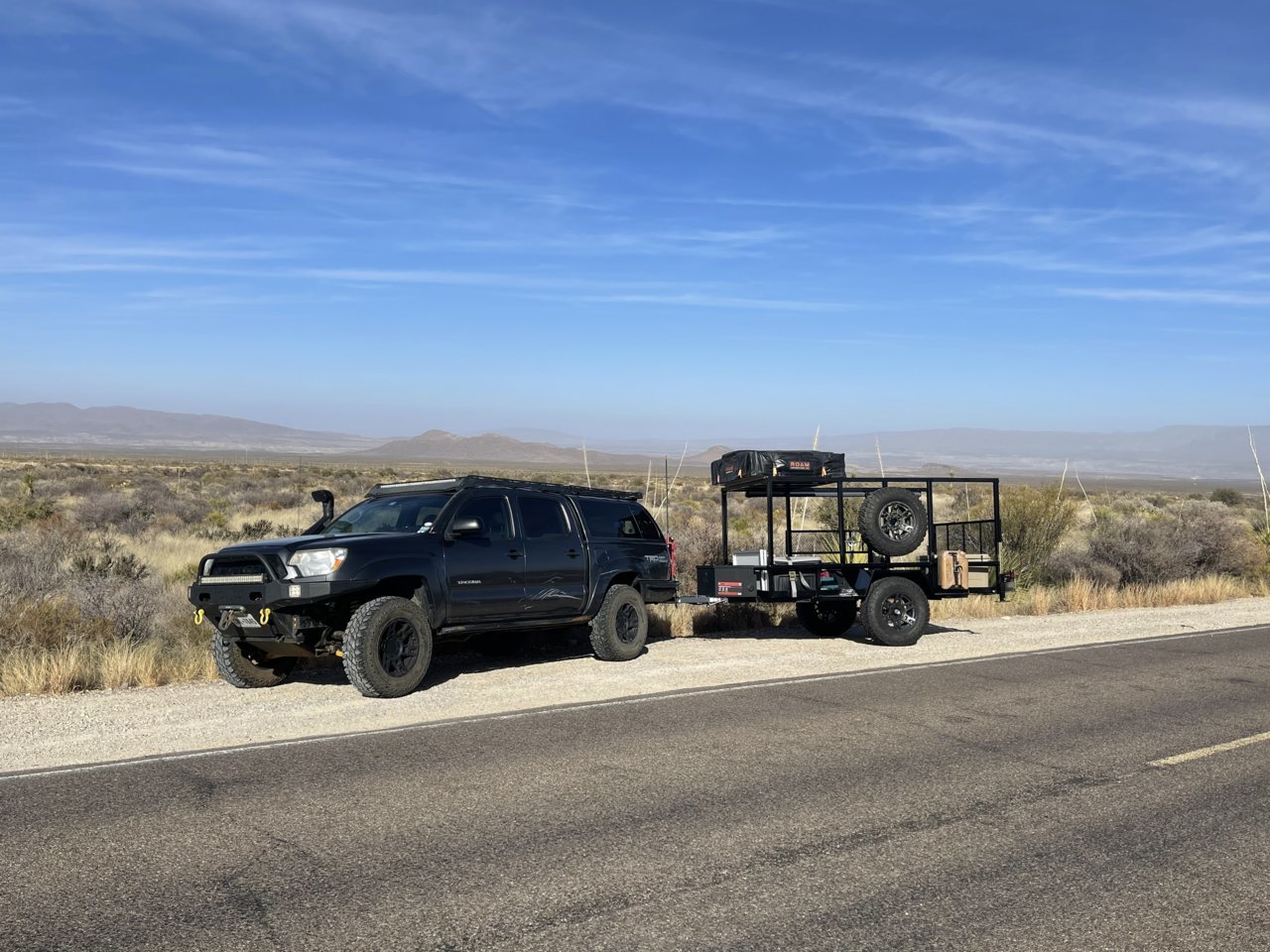

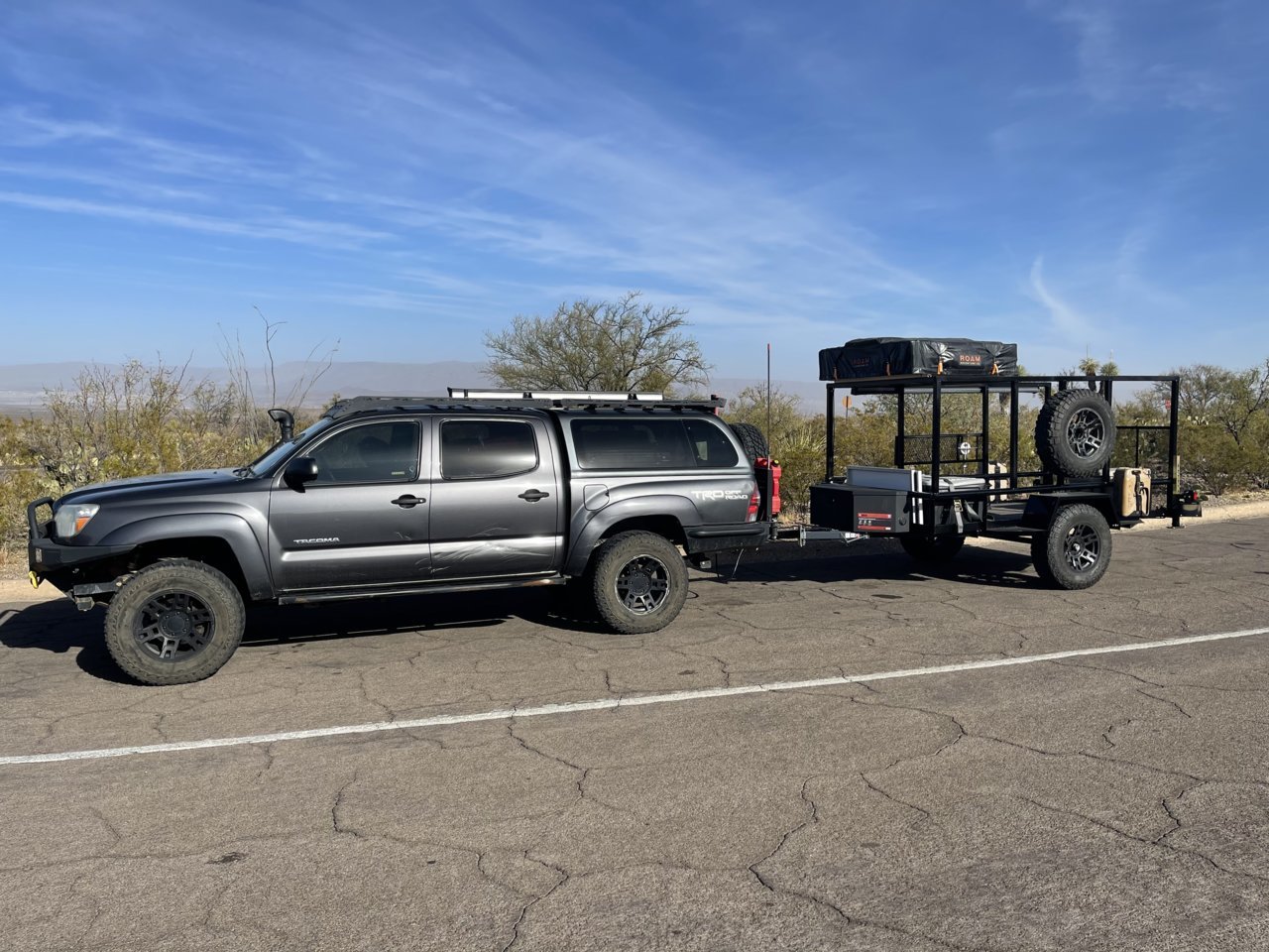

    Tent ride height is too tall for going down the road, but great for living once parked. I’ll have to design a way to raise/lower it.
    Need a wind block for the burner
    Backsplash for the burner to prevent grease from splattering onto the tent
    90° elbow for burner gas line to replace the stock one I broke
    Diesel heater because it was cold and Mrs. said she’d pay for it. :spending:
