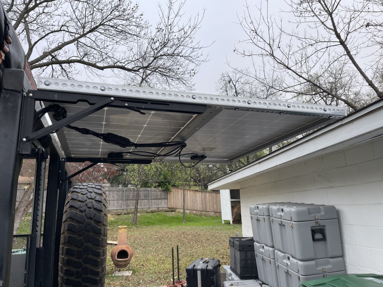

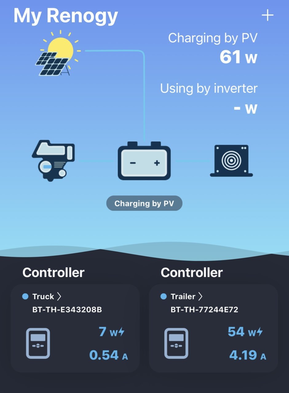

  5. Jul 15, 2022 at 11:23 AM
    #165
    Naveronski
    Naveronski [OP] Well-Known Member
    Sep 14, 2013
    #112501
    9,517
    Fort Worth
    2014 MGM DCSB TRD:OR
    Solar panel installed and working!
    Here I’m close enough to pick up Bluetooth from both truck and trailer solar systems.
    trekker, Slashaar, Vmax88 and 4 others like this.

  9. Oct 28, 2022 at 8:16 AM
    #169
    Naveronski
    Sep 14, 2013
    #112501
    9,517
    Fort Worth
    It’s already setup and working, but I’m replacing two 100ah lead batteries with 300ah lithium. The aging lead batteries are giving me less than half their rated capacity, so this should be a substantial upgrade.
    Solar panel is Renogy, as are the controller and Bluetooth module.
    The photo above shows a single panel; I’m adding another to help balance the load from the Dometic 75DZ fridge and diesel heater.
    Slashaar and trekker like this.

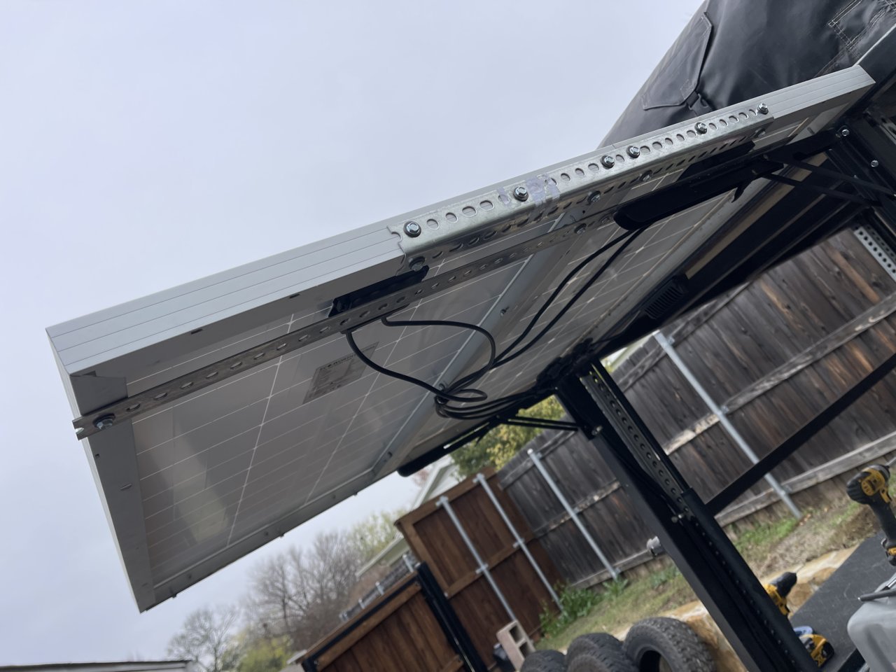

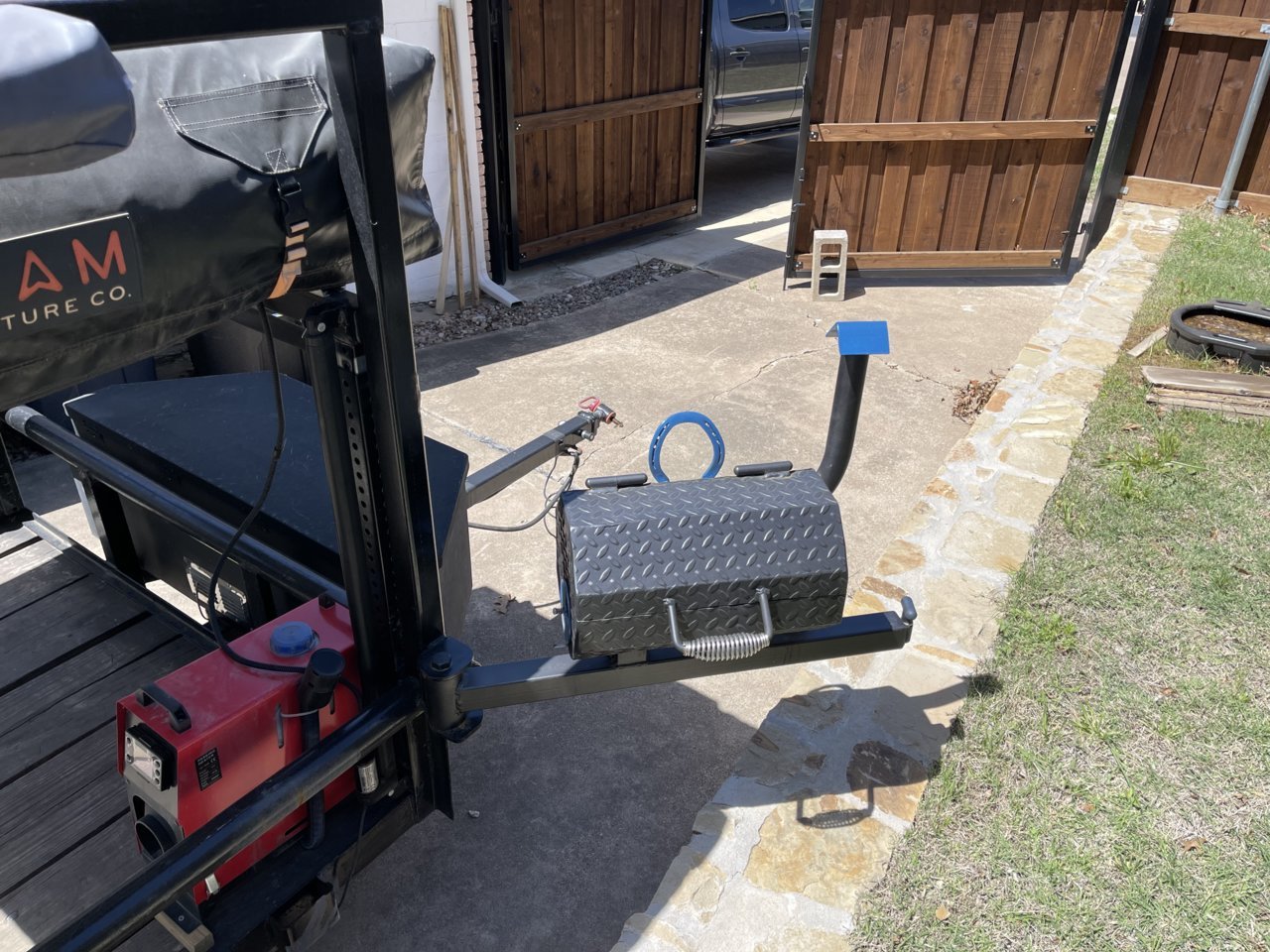

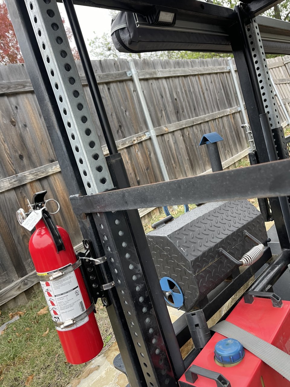

  15. Dec 9, 2022 at 2:28 PM
    #175
    Naveronski
    Sep 14, 2013
    #112501
    9,517
    Fort Worth
    Mounted a fire extinguisher and rewired the lights.
    Then added a second solar panel to better feed the upgraded batteries.
    Drainbung, Slashaar, Vmax88 and 4 others like this.

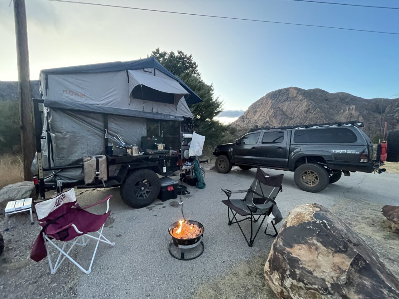

  20. Dec 24, 2022 at 7:50 PM
    #180
    Naveronski
    Sep 14, 2013
    #112501
    9,517
    Fort Worth
    Made it to Marathon for our annual trip to BBNP.
    Solar panels are charging the battery even when “stowed”.
    Slashaar, Vmax88, SuperBad and 3 others like this.
