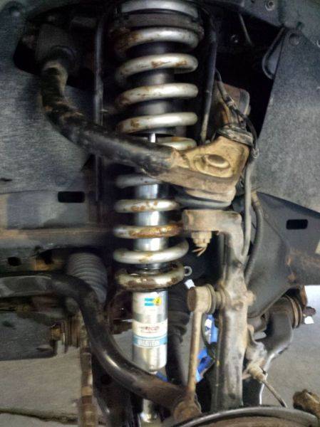

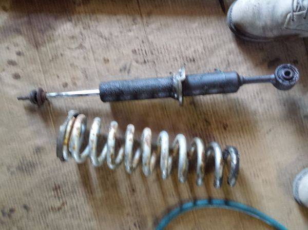

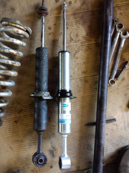

    Changed out my blown 5100s last saturday:
    Good LORD how different new ones look!
    And a finished shot:
    Ride is much better. Also moved the 1/4" spacer I had on the driver's side to the passenger side and added a 1/2" spacer to the driver's side. Still haven't measured to see what kind of lift difference I got but I think a good chunk would be offset by the different spring seats they use now. The new ones are MUCH thinner.

    Rust cancer! Spray some fluid film on there

    Negatives of the salt belt. Gonna start working on it soon

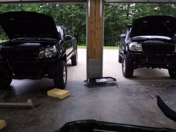

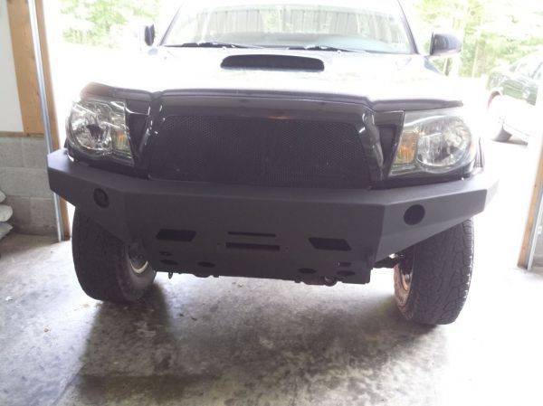

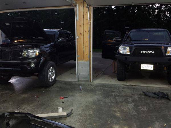

    Sold the Pelfreybilt last week to PantherTaco.
    Last pic on my truck:
    Mid-swap:
    End:
