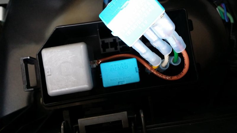

    Fixed.
    1) The tab on the inverter relay was pushed in due to the tightness of fit with the jumper in as well. With this tab pushed in, the connection for the jumper was a little loose.
    2) Removed the jumper. Pulled the tab out to regular length with need needle nose pliers and put the inverter relay back in by itself (inverter still works so I guess the relay was ok).
    3) Drilled a hole in the cap that goes over the relay bank and ran the jumper wire out and to my BlueSea fuse box. Now I have constant power to my fog lights at my stock switch and can turn them on whenever. Done!

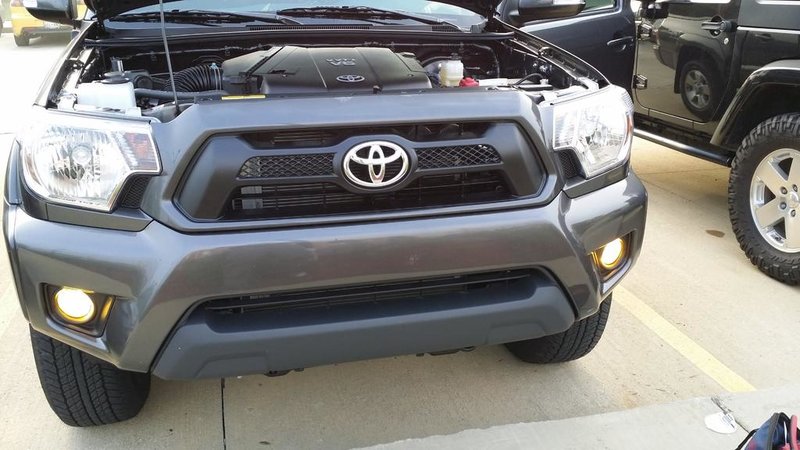

    I guess I've got to start this very soon....
    I didn't do anything different put hook everything back up like I had it and BOOM. Worked like a charm. Hoping this time it lasts.
