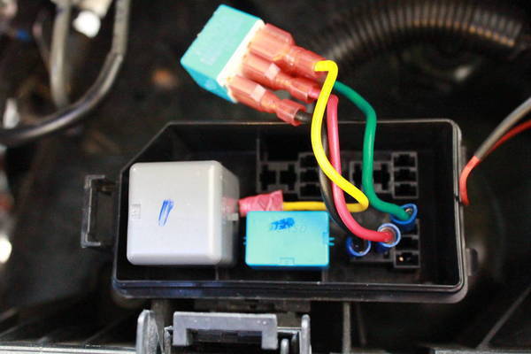

    First off, Thanks to the author, great write up. Clear, simple and easy to follow. Nice job.
    I did this mod this evening and here's how it went for me.
    Took me all of about 40 minutes, and half of that time was spent running down parts in my shop. I took my time like I do with most of these mods. Just want to get it right the first time.
    This is how mine is laid out. 06 DCSB Pre-Runner, 4.0L.
    Simple enough. Made up the jumpers and installed them on the relay. And I taped these up before I buttoned it all up;
    And because mine has the AC inverter, I was able to just run to it, at least I believe that's what that is. Bada-bing, bada-bang.
    Thanks again. Love this mod.

    there ya go! yup i wanna say it was in 2012+ models where they put the fog light relay in that lil auxiliary box.
    Just want to double check but you either taped up the exposed connectors or put some heat shrink over em right?

    Yes I did. I taped them up.

    I decided to go ahead and shrink wrap them. Better for the long term.

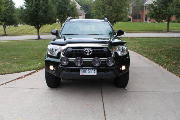

    Did mine over the weekend. Thanks ND4! :D
  10. Aug 19, 2014 at 7:51 PM
    #270
    Tacomio
    Tacomio Member
    Nov 1, 2013
    #115656
    19
    Dave
    Southwest OH
    Spruce Mica 14 DCSB OR 4X4
    BFG AT KO2 265-75-16 Level 8 MK6 Matte Bronze TRD center caps TRD exhaust tip ND4's Foglights anytime Pop n Lock power tailgate lock BAK Roll-X Gentex mirror N-Fab light bar Hella 700's Husky Liners CVRV Mirror mount Redline struts Underhood LED Weathertech Vent Visors Santex organizers Ultragauge OEM roof rack Cabela's roof basket Extend a bed Automatic Android
    and they work :)
