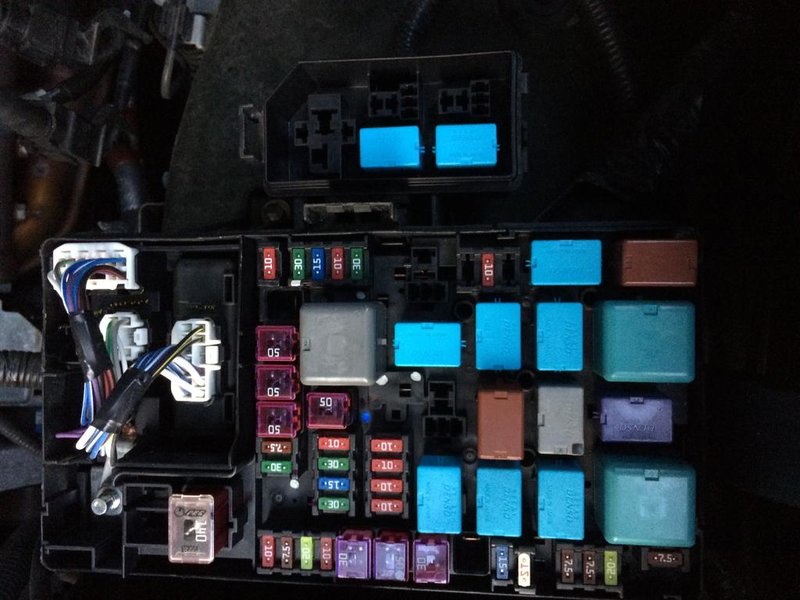

    Here is my set up looks like the 12v relay is in the main box

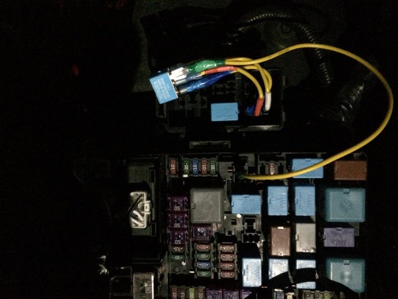

    Did it up this way. Works for me. Wish I could have done it like everyone else. Cleaner. Thanks ND4 and if you have any other advice is gladly accept.

    hey man w/e works glad you got it up n running.
    That other relay that looks like the AC/DC relay is likely for something else
