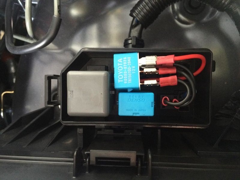

    Awesome thread, thanks!!!! I used the Towing Tail relay (pin 3) on my 2011 TRD Sport and it works great. With the lights on park, low beam or high beam, I've now got fog light options. Can't run the fogs with only the daytime running lights using this method, but I wasn't looking for that option personally.

    Nice!! I would like the same. How about some pics of how you did it? thanks

    [​IMG][​IMG]
    Pretty straight forward - if I can do it, anyone can!!! I was initially a little concerned about the wire colours and making sure I got them in the right place, until I realized that other than the brown wire, the rest just go straight into the same place the pins on the relay went... On mine, the Towing Tail relay was easy to access as there was no other relay directly below it. The brown wire jumps from the #1 pin on the Fog Light Relay to the #3 pin on the Towing Tail relay (closest to the bottom of the image).

    ^ Pics are worth a thousand words!!! thanks for that contribution!
    (note the above picture is on a 2011 that does not have the external relay box that the 2012+'s have hence why his fog light relay was within the main fuse box but same mod can be applied without issue to 2012+'s)
