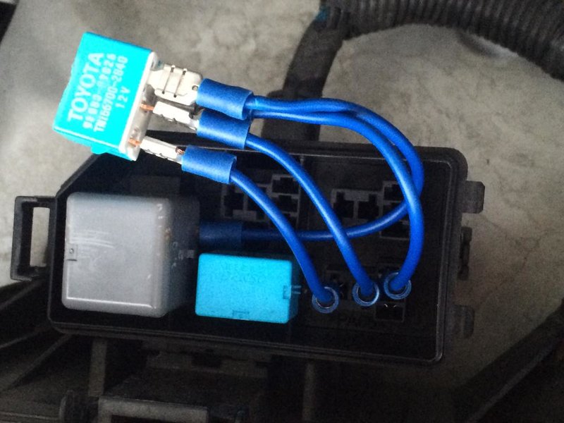

    ND4 I tried your fog light anytime mod today and when I hooked everything up my fog lights didn't work. So I took it all off and made sure everything was seated firmly and again my fog lights didn't work. So I put everything back to stock and my fog lights won't work anymore. I looked at the 15 amp fuse and it was fine , but I replaced it as a precaution. Any ideas what the problem could be?

    maybe it's the relay? perhaps try and swap in a relay from a different spot to test.

    Probably borked the relay when you took it out. Like stated try using one of the other relays in its spot as a test.

    Replaced my relay and fog lights are working again but couldn't get the mod to work so I think I might try switching the wires underneath. The pic below is how I hooked it up and I had my keys on the acc thing and didn't work.

    its likely that your not wire that goes to the AC relay is not actually in the proper socket, it doesnt look centered like the socket is in reference to the relay.
    Also, insulate the connectors at the foglight relay!

    Thank you ND4 I will redo it later and see if it works then.

    Got the anytime fog mod to work. But blew a couple fuses in the process
