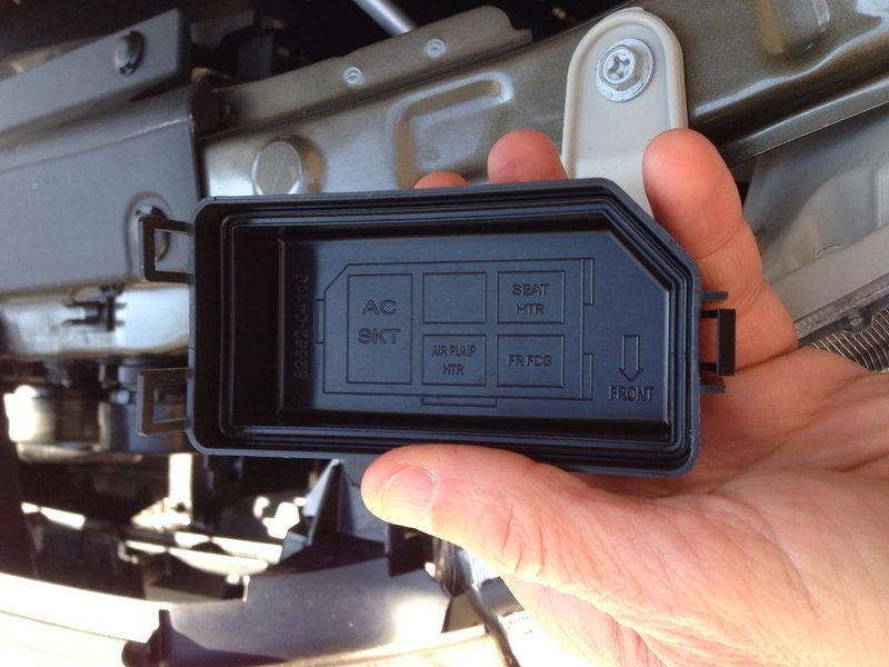

    So my 2015 has the relays labeled as shown. Safe to say the "AC SKT" is still the relay for my inverter?

    Well, mine didn't work so hot. When I finally got all the wires hooked up, as per the first post, fogs didn't work at all. Put everything back to factory, fogs still didn't work. Checked the fog fuse: blown. Replaced fuse, everything fine. So something I did blew the fuse. Not sure what. Unless it had something to do with hitting the switch for the inverter, for the bed 400w outlet.

    I probably should have disconnected the ground. I knew better. Was just lazy. I kept all the wires and clips. Except for one that pulled off when I was disconnecting it, that is. I'll probably try again once I can get another fuse (I case I blow it again!), and clips that are closer to the correct size.
