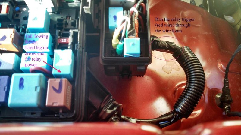

    I also give all credit to nd4spdbh, as he had the original Mod and credit to everyone here connecting the lead to the TAIL TOWING relay to the trigger power when just my parking light are on.... Thanks.
    One thing to note the wiring/relay layout is different from year to year as my 2011 double cab 4x4 with TRD off road package has all the relays inside the main relay/fuse box.
    That aside - This works perfect...

    Thanks OP. finally got around to doing this. The part that took the longest was stripping the insulation off the male blades. Now I have fogs with high beams! Thanks again!

    Well it turns out that when I pushed the pin into the relay, that it was damaged. (post 403)
    I didn't notice untill I tried to use my Inverter.
    Bought a replacement at the dealer (Uggh).

    Thanks for this mod! I did it last week while on lunch, I have a 2011 so I ended up getting power from the EFI relay. Same outcome :)
