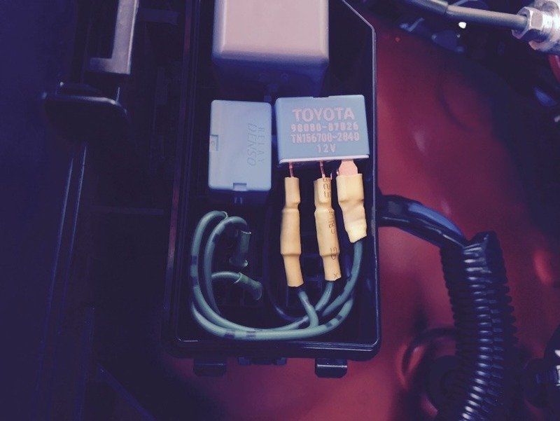

    Finally got around to doing this mod. Got it done today. Thanks ND4

    Awesome guys! glad everything worked out great.

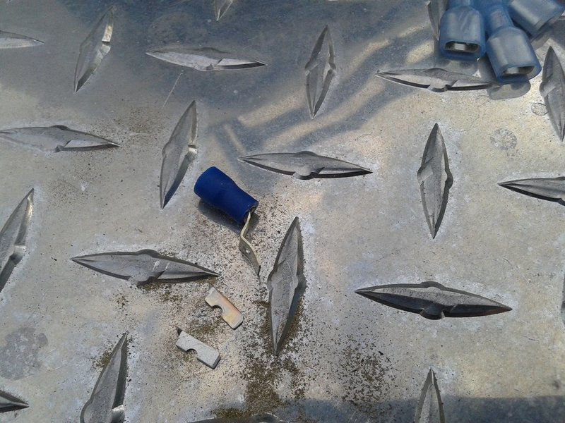

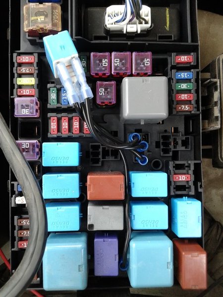

    So glad I found this mod! I never liked any of the other methods. The hardest part was getting the DIM relay out of the socket. The cover popped off the relay at one point and I used my SwisTool pliers to carefully grab the metal to rock and yank it out. Then I put the cover back on. Popping the cover off made it so much easier but I'm not recommending you do that. ;)
    Instead of cutting, I filed the edges of the male connector until the pieces that were folded over fell off. That is how I shaped the connector that went to pin 1 of the DIM relay and it worked perfectly.
    The completed job. :woot: Tested to verify it works and buttoned it all back up. I didn't see a need to color code anything since the male connectors simply plug into the same spots the relay blades would have.
