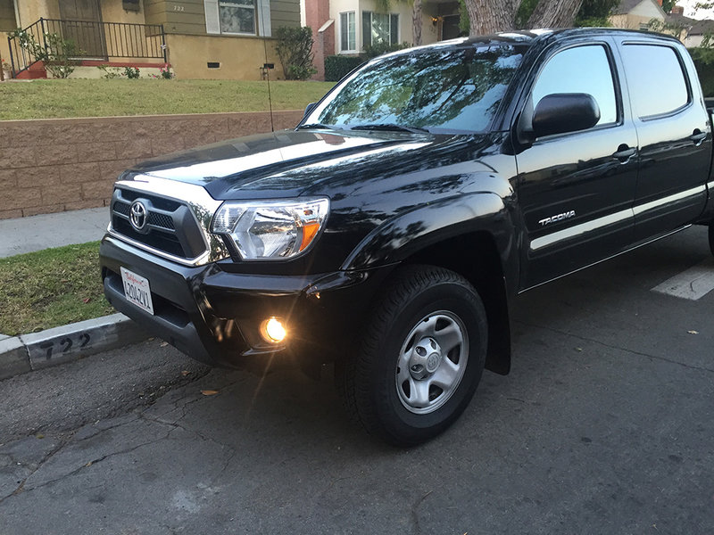

    Twice today, I noticed that the fog lights on my truck were on after using the EFI relay for power. Before the second time, I checked to make sure they were out when I parked. That's not gonna work for me, so I'm gonna put it back to stock until I find a workaround.
    Anyone know where I can get a copy of the wiring diagram for a 2015 DCLB?
    This is what I saw this evening when I looked out my front window:FogLight.jpg

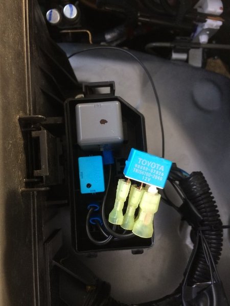

    You've got the inverter relay on the top of the right fuse box. You can follow the OP's original instructions!

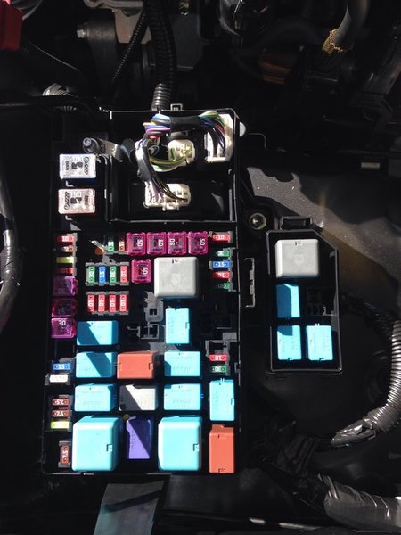

    Here is a picture of my fuse box with this mod completed. Not as pretty as the OP's, but it does the trick.
