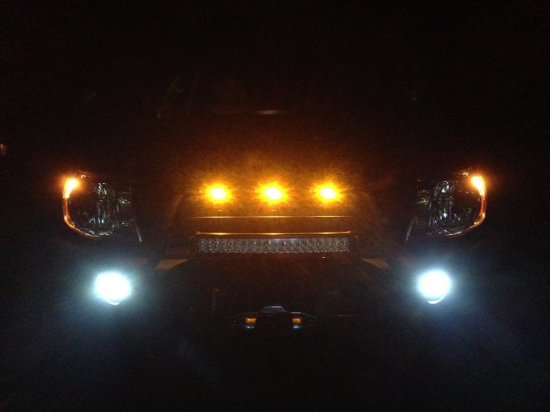

    I have a 2008 Trd Off-road. My Foglight relay is in the main fuse box under the hood. I had recently added LED "Raptor" lights to my Satoshi grill. I wired them using a fuse tap placed in the "taillight" fuse receptacle under the dash, then ran the wire from there thru the firewall to the LEDs.
    I decided to use that source of power to do ND4's Foglight anytime mod. Works well. Fogs can come on with just the parking lights, low beams or highbeams but not by themselves . I like the idea of being able to "kill all lights" with just a twist of the headlight knob on the end of the directional stick.

    looks good man! what are you using for bulbs in the stock fogs?

    Not stock fogs. Rigid Industries SAE/DOT fogs.

    thats a sexy lookin setup. always have loved red accents like that!

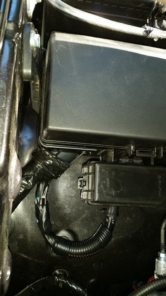

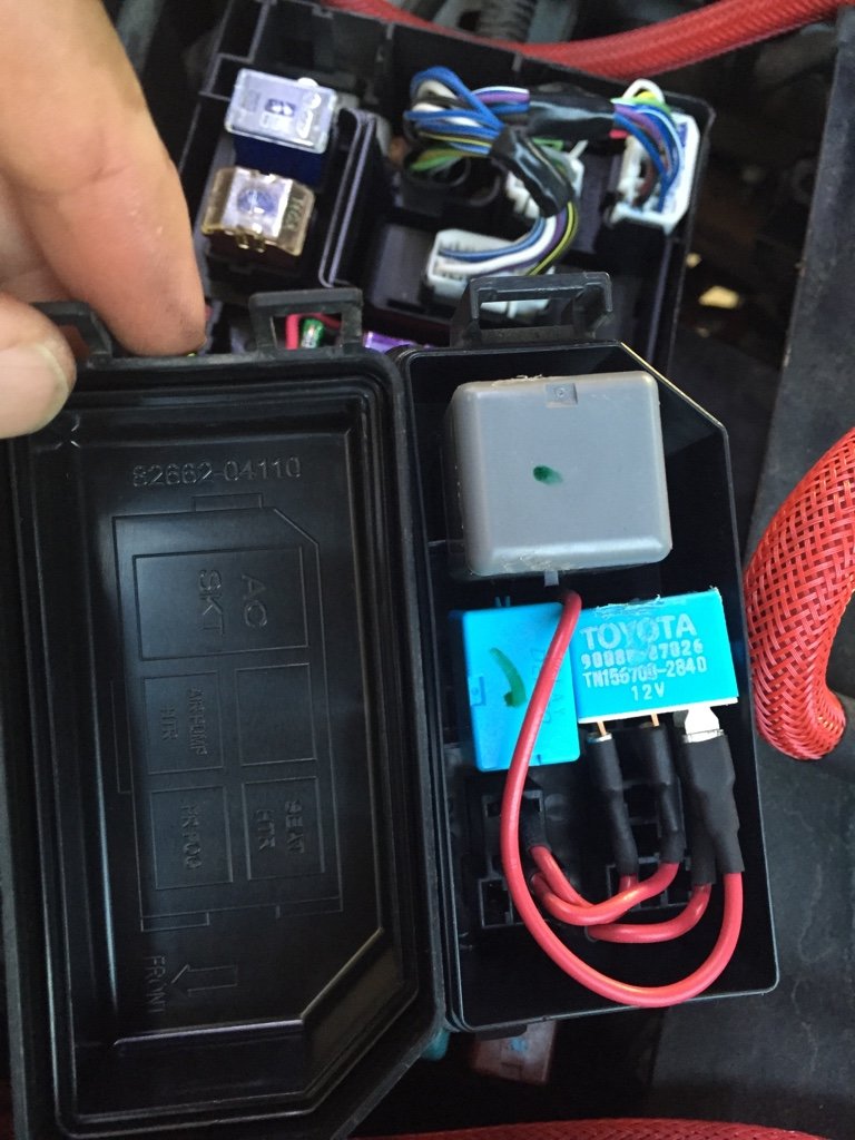

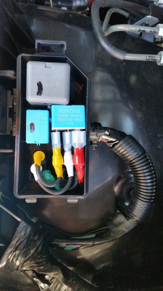

    A huge thank you to the OP. Had the truck a month and hated that the fogs went off with the high beams. Did the alternative method in post #39, running the wire through the looms so there is nothing obvious from the outside of the boxes. Very happy to have this working as I want. Thanks!

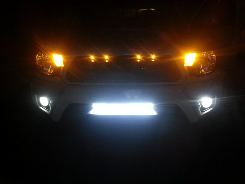

    S.O.S bolt-on sliders, XB Morimoto fogs, bumper mounted 20" led bar, amber leds in grille("raptor" style) and Relentless fab hi-lift mount. Plastidip?
    Thank you nd4, mod was quick and easy. Looks great too! Did it over the weekend while installing the light bar.
