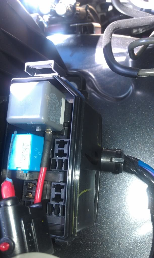

    What does the lid of the little box say as far as the single relay thats in there? Is that the AC relay? if so you can grab the connection off that like in the OP and put the wire into the main relay box.
    If you pulled the connection off the DIM relay you would have foglights that could only turn on when headlights were on.
    Or you could pull the connection off the ignition relay (which is in the main box) like described in post 15 for more than likely a similar experience to pulling off the dc-ac relay.

    OP: what's the OTHER green relay (the untouched one)? I don't have it. My taco doesn't have DTRL. is that for it? Thx.

    I believe the lid on the external box say's AC so I guess it's for the inverter. I think the only need is to have the fogs stay on when I flick to high beams. So I guess I'm good to go to go with the dimm source. Can't think of any reason to want the fogs on w/o headlights.

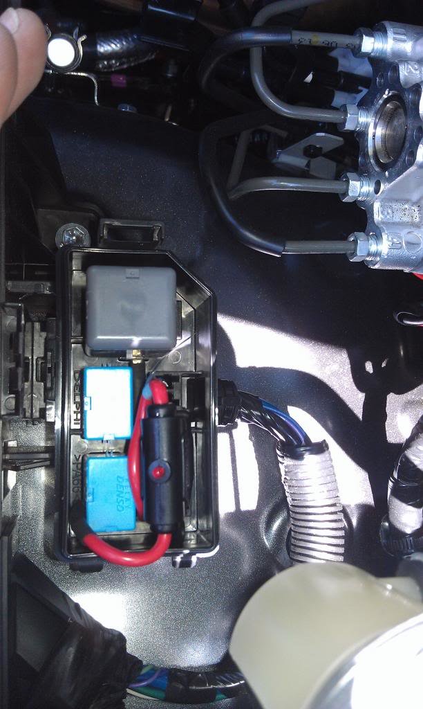

    what do you think the OP did in the thread in my sig!
    its a fog light mod…. its not that hard! fuse or not fuse…
    "no fuse needed"? the fuse its not hurting, its very simple, MY method uses "ONE" in-line-fuse wire and yours DOESNT but it uses 5 wires insted of one…. and as far as i know, both methods are reversible
    55e165f3-d874-4b57-9515-673314c1ca6b_zps_54753cd011d1256fbc8e7aaf96a7526ad8021da3.jpg
    Full step by step/w more pic at the link in my sig!

    Which relay are you talking about?

    Don't see the need to bent relay back, and if there is the need to so so I don't think it's going to break that easy...

    The one you did NOT touch.
  19. Jan 19, 2014 at 9:40 PM
    #59
    nd4spdbh
    nd4spdbh [OP] Well-Known Member
    Oct 7, 2013
    #114055
    14,626
    SoCal
    13 DCSB TRD OR v6 Auto
    are you talking about the middle one of the 3 in the external relay box?
    thats for the smog air pump relay.
