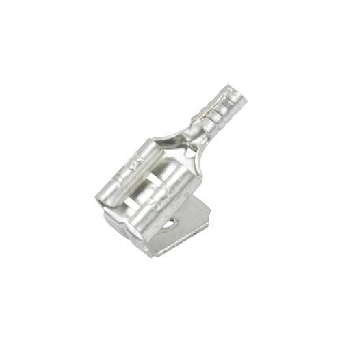

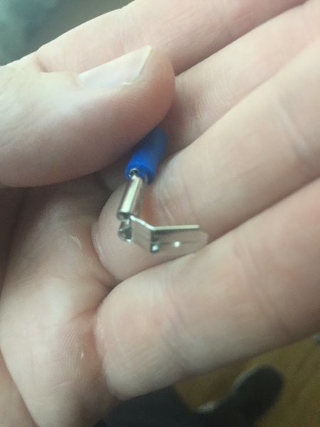

    Not sure if anyone posted this yet but I went to the hardware store and picked up a "piggy back terminal" to use for the bent leg portion. It was uninsulated so I just used heat shrink. Cut off the female portion of the terminal and bent the leg down. Gave more working room and the large relay sits flush.

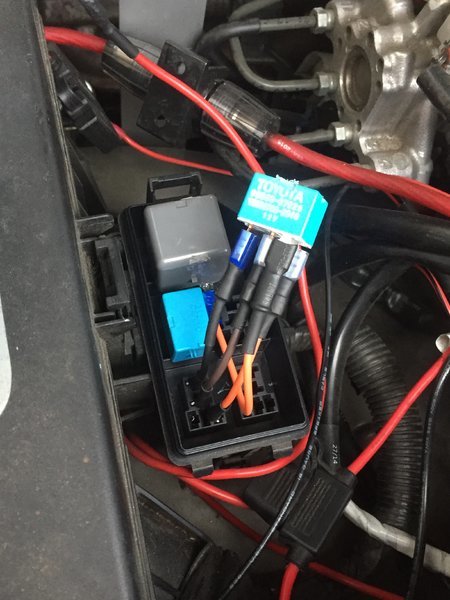

    Finally completed this!

    Where'd you pick this up? Looking for one but can't find it

    I just went to the hardware store and looked in their little electrical assortment drawers. Or Google piggyback terminal or something like that

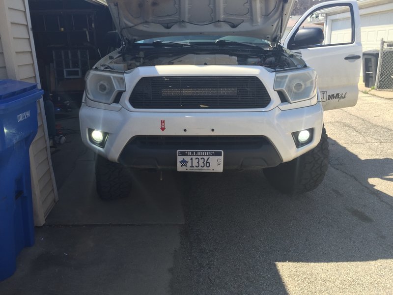

    Finally did it Saturday. It's awesome. Again if anyone needs the piggyback connector I have a lot of extras
