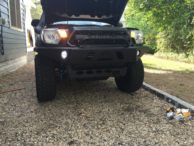

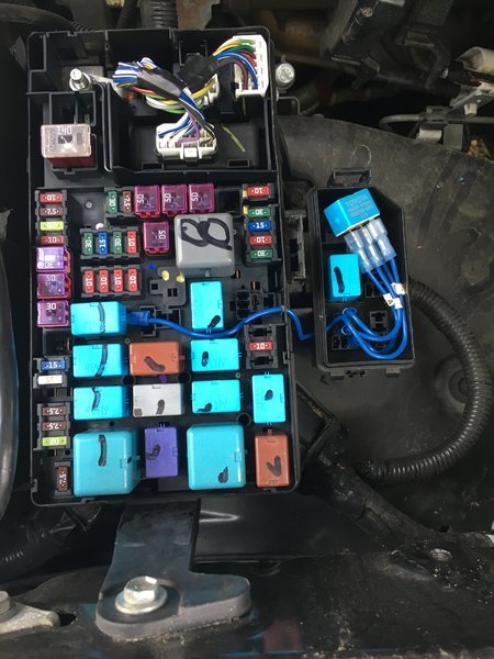

    Did the super stealth mod., took about 30 min.
    No DC relay, so I went to the EFI relay, I notice it stays energized for about 40 seconds after I turn the engine off, so I get driveway illumination as a bonus.
    I ran the wire out the main fuse box through the wire loom hole into the small relay box through the wire loom hole.

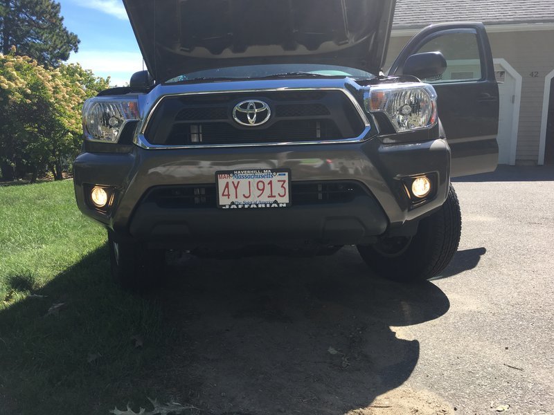

    I did this mod this past weekend. Easiest and quickest mod to date for me.
    The only odd thing was my DRL's did not work after doing the mod, but they worked in the corner/parking light mode. I drove my truck home and tested again and they were working. I'm guessing something is reset when you pull those relays?
