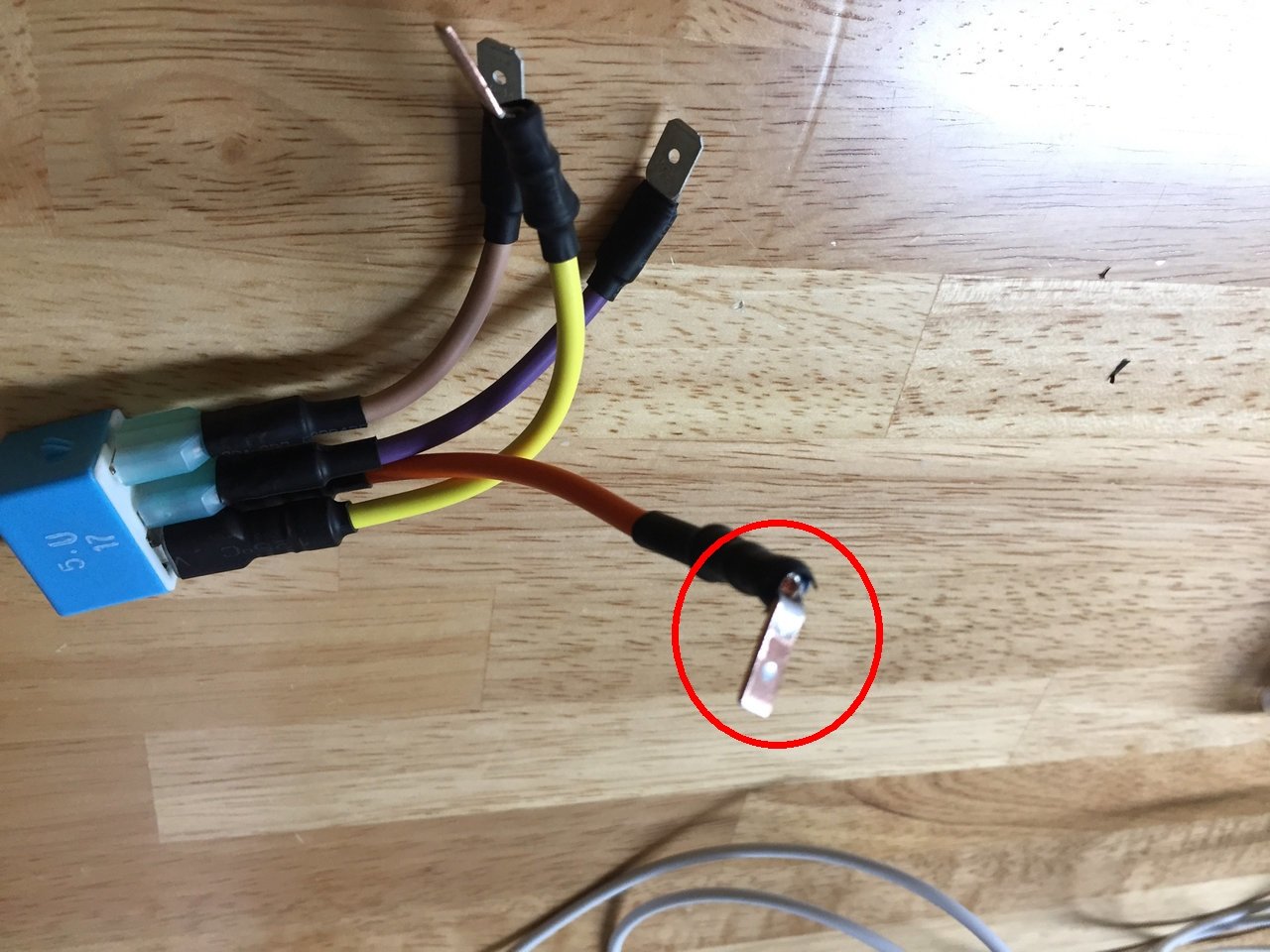

    Has anyone run into the issue when installing the "Brown Wire" male space into the AC/DC relay slot where it pushes the relay pin back up into the relay?
    Had this issue last night when trying to do this mod. The fog lights work great but now my bed outlet doesn't work because of this. Would it be safe to shave down the bent male spade connector?

    I filed the blade of the new bent terminal down so the width was narrow enough to fit into the slot in front of where the relay leg goes. I do not have a picture of that location, all I have is a picture showing the terminal after it was bent and files down. It is circled in red.wire.jpg

    This is not my picture, but was in a previous post, hopefully it helps show where the bent terminal goes. But yo will probably have to get / file the terminal to fit in the front slot.
    Tacomoto23 likes this.

    I've been trying to shove the standard width blade connector in the back with the relay and it does nothing but push the pin back up.

    So I tried grinding down the width of the bent connector and placing it in front of the AC/D.C. Relay but it still didn't change anything...
    The mod works but my Bed Outlet button still lights up only when it's held down but doesn't stay on and supply any power like it's supposed to.
    Did I blow a fuse?

    Probably not, but you may have ruined the relay. I had this happen on mine and it would show the power lights but no power to plug.

    You mentioned previously that it pushed the relay "pin" up into the relay. You destroyed the relay.

    Yes. I wasn't doing this mod when it happened. I have done this mod since in a little different way and all is good.
