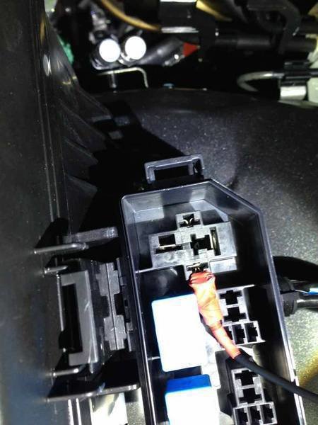

    You have to pull the relay out of the socket then it will all become apparent what you have to do with the bent leg extension.

    Thanks, explored it earlier but the damn thing is tough to move. Didn't want to pull it out if it wasn't supposed to. Thanks again.

    Yeah best thing to do is to pull the positive on the battery and use a plastic pry tool and pry between the socket and relay, Dont pull on the top.

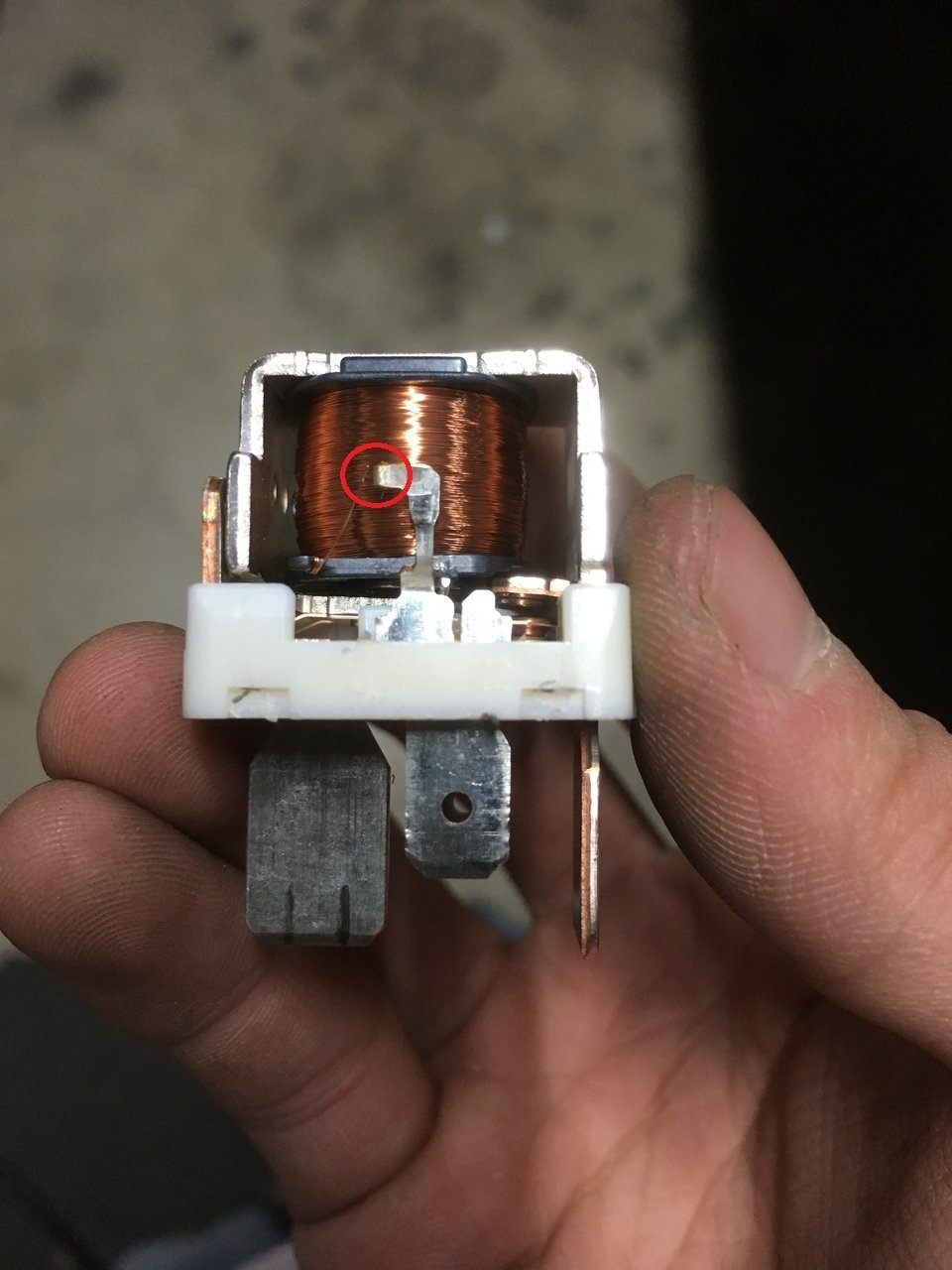

    Tip for anyone who's Bed outlet stopped working at the time of this mod:
    Problem: Its caused by the male pin on the AC/DC relay being pushed back into the relay itself by trying to shove the "brown wire" male blade connector in the same slot as the relay pin. That causes one of the wires to snap as shown by the red circle.
    The solution:
    Shave down the width of the "brown wire" male blade connector that goes in the AC/DC slot, but put it in front of the female slot so that it still touches the connector.
    Purchase a new relay and it works again with the fog lights anytime!

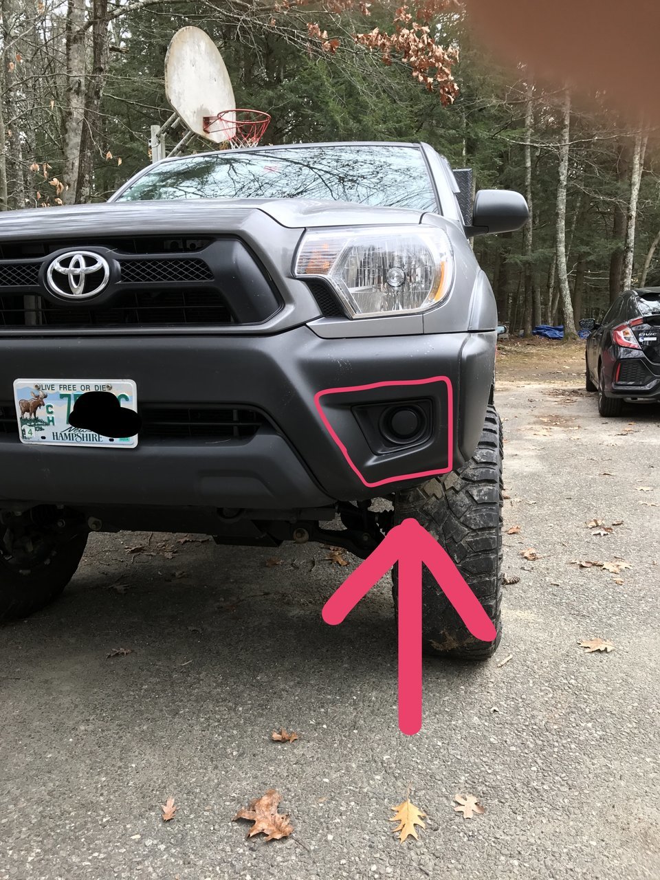

    Has anyone ever seen a fog light that fits this shape?

    All of them
    Best bet is to just buy Baja designs kit, and new bezels with the fog light hole.
