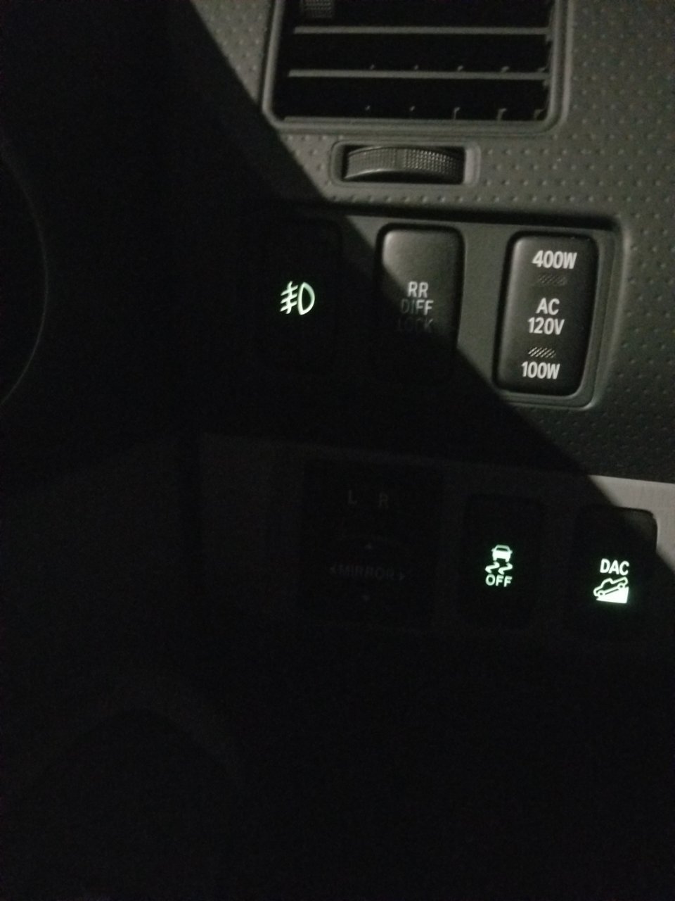

    i am very lost, i did the always on fog light mod, worked out perfect thanks again op. my question now is, my fog light switch never lit up before and even after the mod until today. anyone else with a 2013 tacoma trd offroad fog light switch lights up?

    Mine is illuminated when the parking lights are on or the headlights. Not DRL. I haven't done the MOD yet but plan to knock it out soon.

    okay i just find it wierd how it never illuminated before and not even when i did the mod, but today it does. it illuminated when i put it on park light or full light, but turns off when on drl mode.

    you are just noticing backlighting because the switch is pushed in. The mod has nothing to do with an activated light or the backlight of the button.
    FYI stock there is no activated light only the backlight of the dash when the headlights are set to parking or headlight on.

    no even before mod when fogs were on with my regular headlights the button wasn't illuminated, i know it haves nothing to do with the mod. just weird how it turned on out of no where today. and just wanted to know if originally turns on other tacomas

    Im telling ya, you are seeing things. Stock light was always backlit with the rest of the dash.

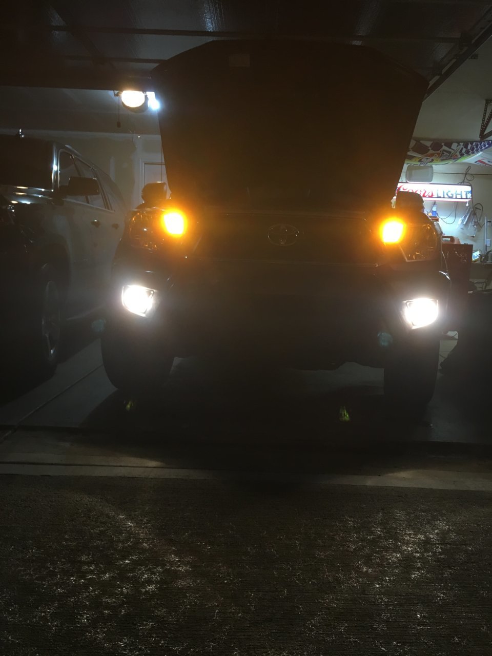

    Knocked out the anytime fog mod using this method. Oh and all these TW members talking about state vehicle inspections really makes me appreciate the old Hoosier state. I can walk into the BMV and title a VIN plate with out any questions. hahaha :)

    nice!
    yeah its funny, living in california, we only have smog inspections. No actual vehicle safety inspections what so ever.... you should see some of the clapped out vehicles on the road.

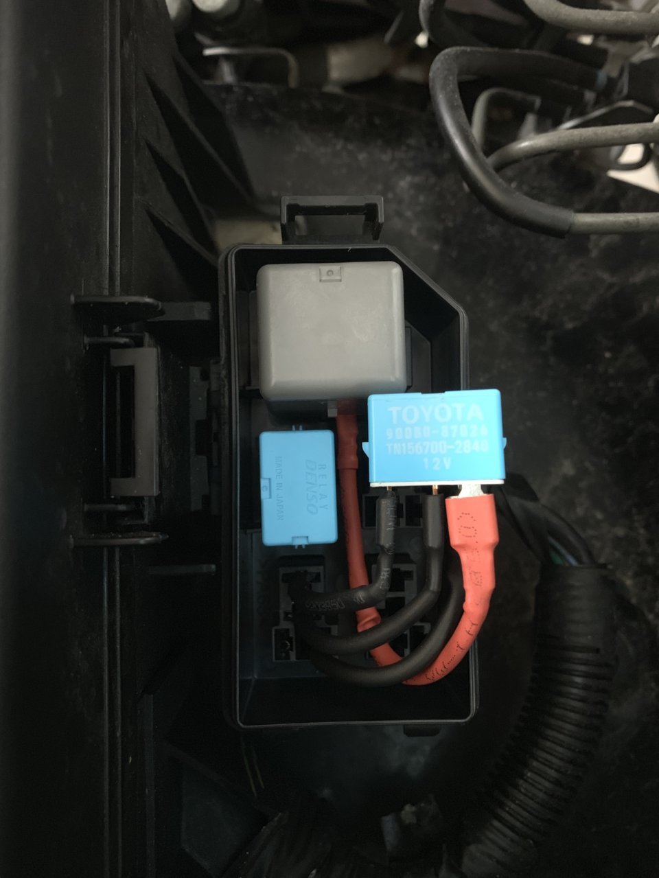

    Thanks to the OP, I just completed this mod on my 2015. I decided to take off the plastic on the connectors and heat shrink the entire wire/connector. I was afraid of any loose wire lol.

    Super Clean!!
