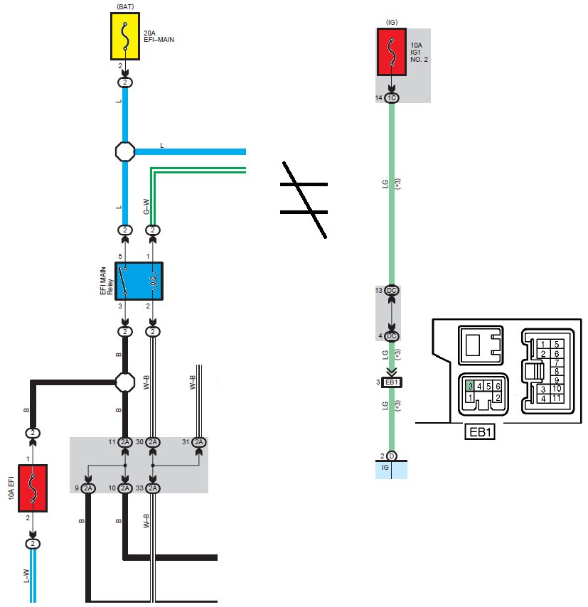

    is there a way to make this a permanent mod? had to tap into the efi and do t like having the lights turn in sporadically.

    Permanent?...
    Tap this wire, you won't have them turn ON sporadically..

    yeah, right now i have it set up like this via efi relay:
    ND4's Fog Light Anytime Mod... NO splicing, No Bending, 100% reversible
    but i don't like the fact that the lights turn on every x hours. and, i'd like to make it permanent so i don't have to worry about those plugs coming loose. i'm ok with splicing/soldering. i don't see myself wanting to change it back to factory.

    I used an add a fuse. Ran from inside fuse box hot with ignition on.

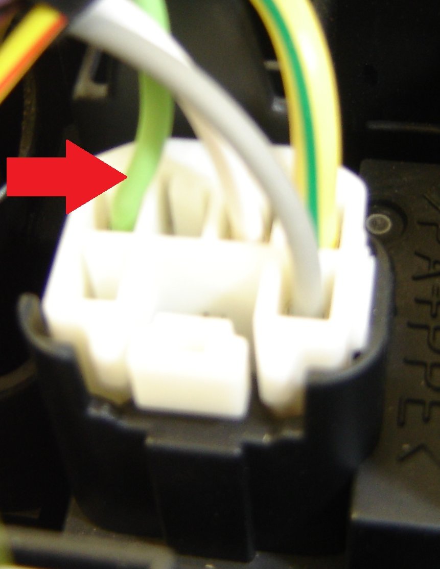

    @nd4spdbh just did this mod, real nice write-up! I ran into a minor snag with the connector that borrows power from the AC relay, I didn't pay attention to why the bend in the picture is where it is and it wasn't connecting 100%. Re-bent it so it could seat itself better and viola. Now I just gotta figure out what lights to replace my factory fogs with!
