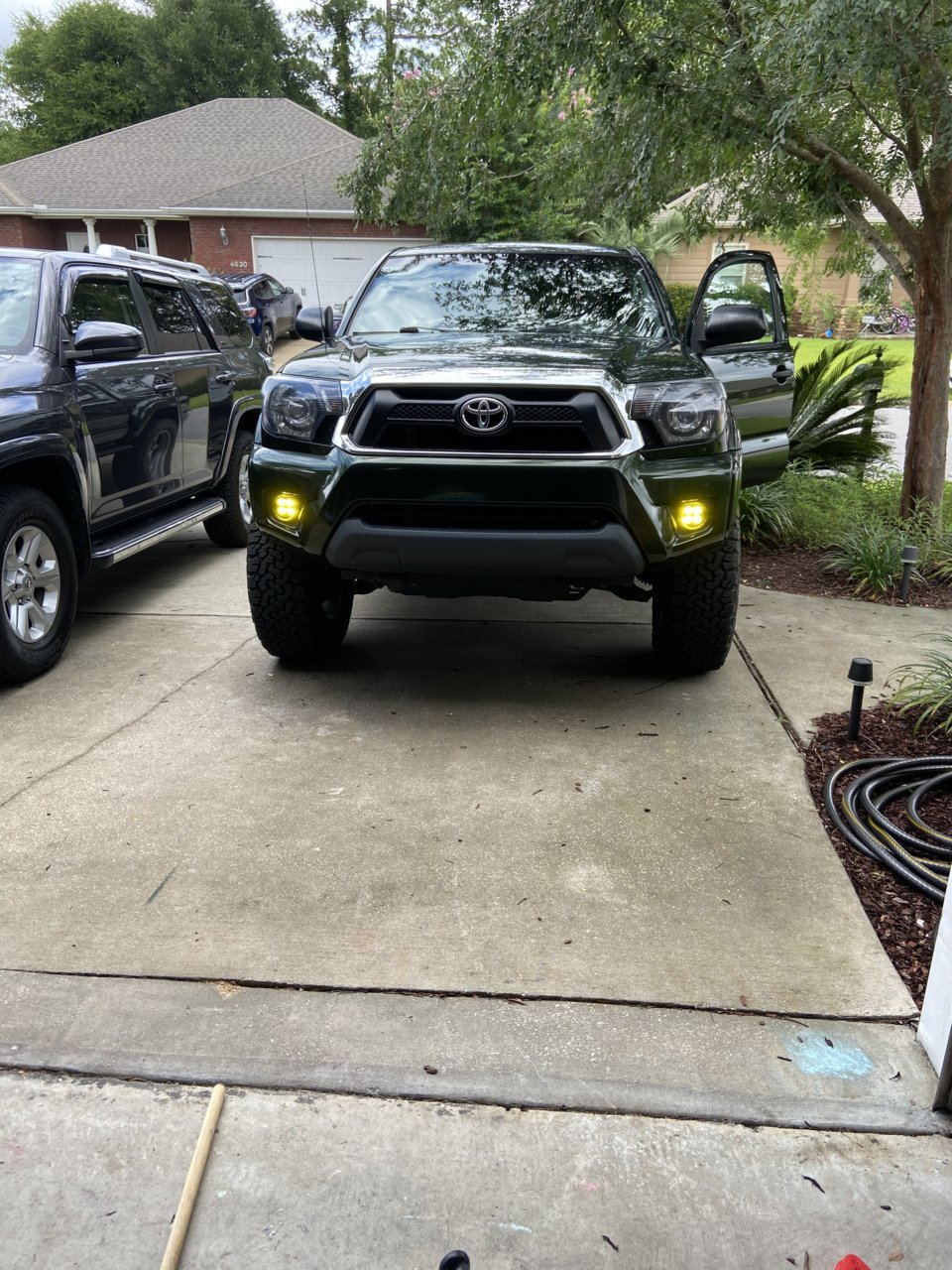

    whats the trick to pulling out the relays?
  18. Nov 7, 2020 at 5:54 PM
    #918
    srspicer
    srspicer Paint it black
    Jul 29, 2017
    #225326
    1,590
    Lower Bucks PA.
    05' Black DBLC short bed
    Painting things black
    Wiggle them slightly while pulling straight up. I assume you are in the main box under the hood.
    hmsailor likes this.

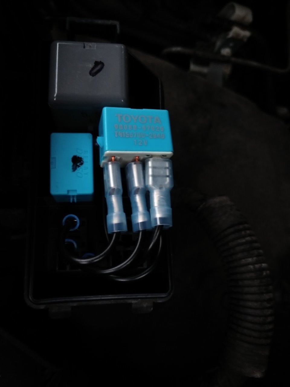

    just finished mine. u da man nd4! also, i used the smaller 3/16 size male spade connector so i wont have to do cutting.
