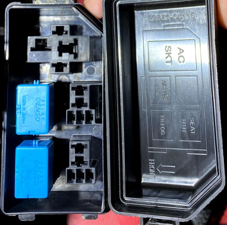

    First thanks to @nd4spdbh . Threads like these make this place absolutely invaluable. I've got some SS3's on the way and wanted to do the mod in anticipation. wouldn't you know: 2013 AC SR5, no AC/DC relay.

    Hard to tell in that pic but is the AC/DC socket have its pins inside it or are they blank?

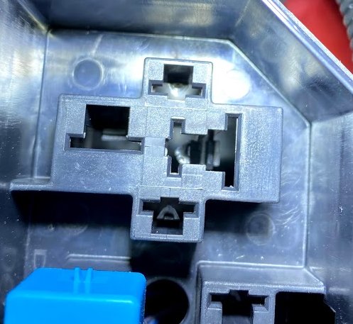

    there's something in there, but I wouldn't call them pins.

    Have you shoved a 12v tester down there to see if there is power?

    Job one when I get home. Until this moment I assumed no relay/no outlet/no pins.

    Yeah looks like its blank. Hmm.

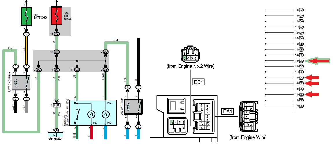

    There has to be a switched on with key 12v that we can grab that doesnt come on at random times like the EFI. Let me dig into wiring diagrams.

    Yeah that light green wire i believe is what turns the trailer charging pin with accessory/running

    So in that case you should be able to grab of pin 2 of the batt charge relay!

    I'd be willing to be that guinea pig. I can see it in @caribe makaira diagram, I'll see if I can identify it tomorrow in the truck. If you've got a pic from your '13, I'd welcome it.
