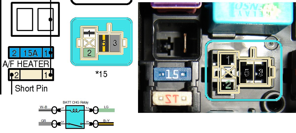

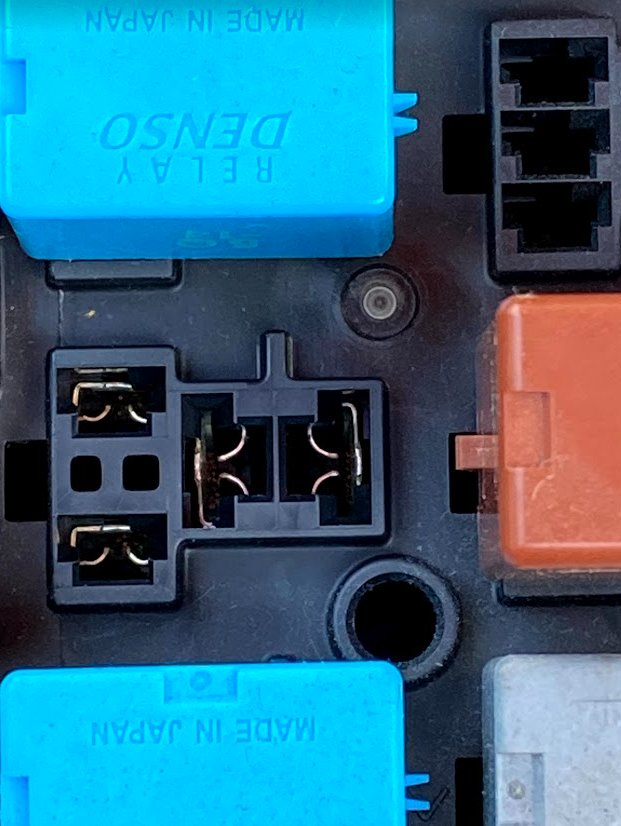

    Yup that would be the one, Pull it and take a pic of the socket.

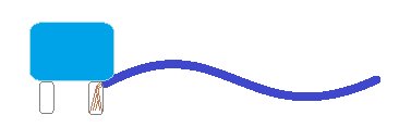

    ok. So using your original scheme, simply run the brown/bent tab lead to that narrow portion of the channel, replace relay and boom. And this will be switchable power, off with the key out?
    Simple enough.
    So what purpose exactly does the batt charge relay serve. (prepared to feel really stupid when you answer this...)

    "Charges" your camper/trailer battery while in tow and connected.
    Leave the relay removed, since you don't use it. And place a male spade terminal in #2.
    If you decide to keep the relay in its position, then (I suggest) use a 20 awg wire without a terminal, just the stripped wire flared out and the same length of the terminal.

    Thanks for the support sir! that makes things easy.
    Correct yes. You will run the "brown" wire in the OP to pin 2 of that socket and replace the relay (be careful when inserting as there will be 2x the things in that pin now) or like stated you can leave the relay removed if you dont have a trailer that needs that charging function.
    That relay is responsible for 12v charging to the 7 pin for trailers that utilize it. It connects the charging system of the truck to the trailer so the batteries can be changed on the trailer.
