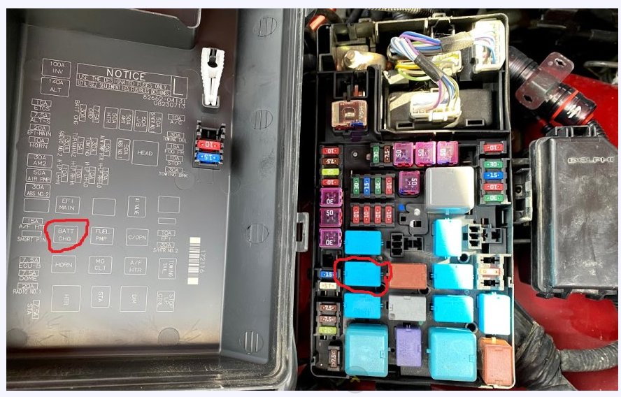

    My 2013 SR5 doesn't have the AC relay, so what can be tapped into easily that will allow the fogs to work independent of everything else, and only when the key is turned on? I don't want to worry about them coming on every 4 hours (possible with EFI) or something else funky.

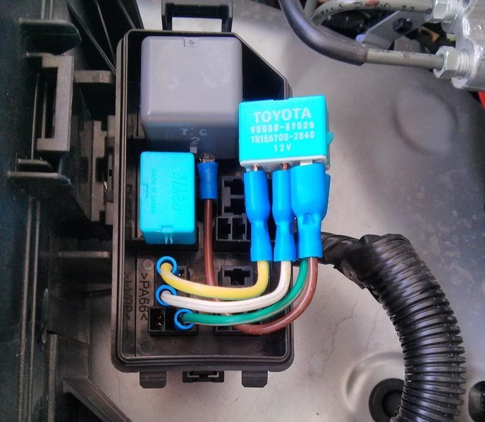

    Im in a 2013 SR5 as well. I did this and it works exactly as you suggest. Do you have the tow pkg?

    As pictured, and described in the post I linked too, this works perfectly. The switch on the dash is on/off, not tied to anything else. Im not the sharpest chisel, and this was totally straightforward. The only 'negative' is the way the jumper runs between boxes.

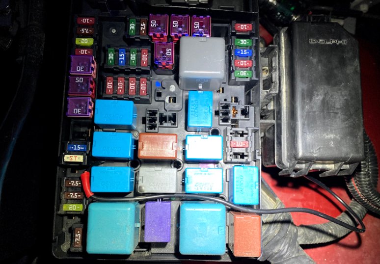

    Did the anytime mod today. I made jumpers like everyone else and tapped into the "Batt Charge" relay that's beside the EFI. So far everything works perfectly and my DRL's (Switchable on the stalk) have not been affected. Now I just have to swap out the factory housings for some selective yellow SS3's!

    hey man. Sorry to leave you hangin’. Busy weekend.
    this photo is from the first post of this thread, still the best reference for this.
    The brown wire in the photo is tapping the AC relay. All we’re doing is running that sole wire from the BATT CHG relay instead. Everything else should be as pictured

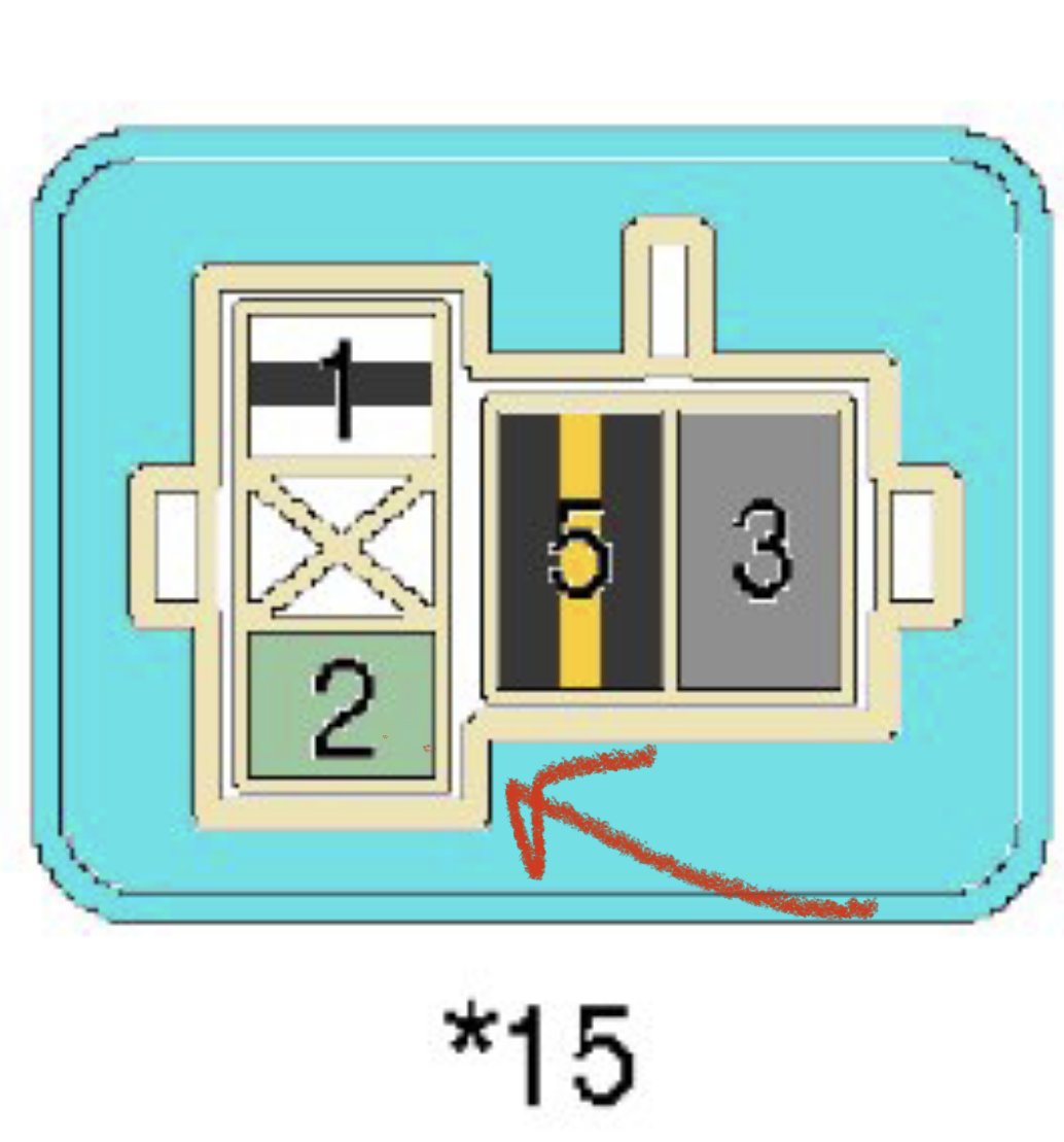

    Yea that's what I've been reading too, but I don't have the AC relay because my truck is an SR5 without the inverter. I tried to tap into the Batt Charge relay in the main box but it threw a CEL. Is there a specific wire that I need to attach into or just any one under the relay?
  19. Jan 10, 2021 at 1:36 PM
    #1039
    kidsmoke
    kidsmoke Well-Known Member
    Mar 14, 2015
    #150859
    2,702
    Flyover Country
    '13 BR AC SR5 4x4 AT
    Yes Pin #2

    That's the same one I tied into. I'm not sure what happened. The lights worked this way though.
