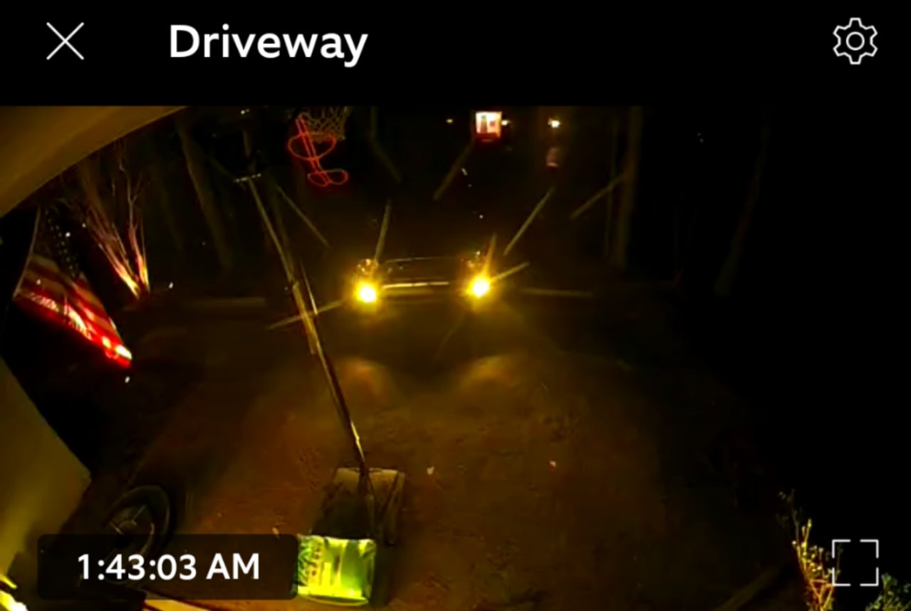

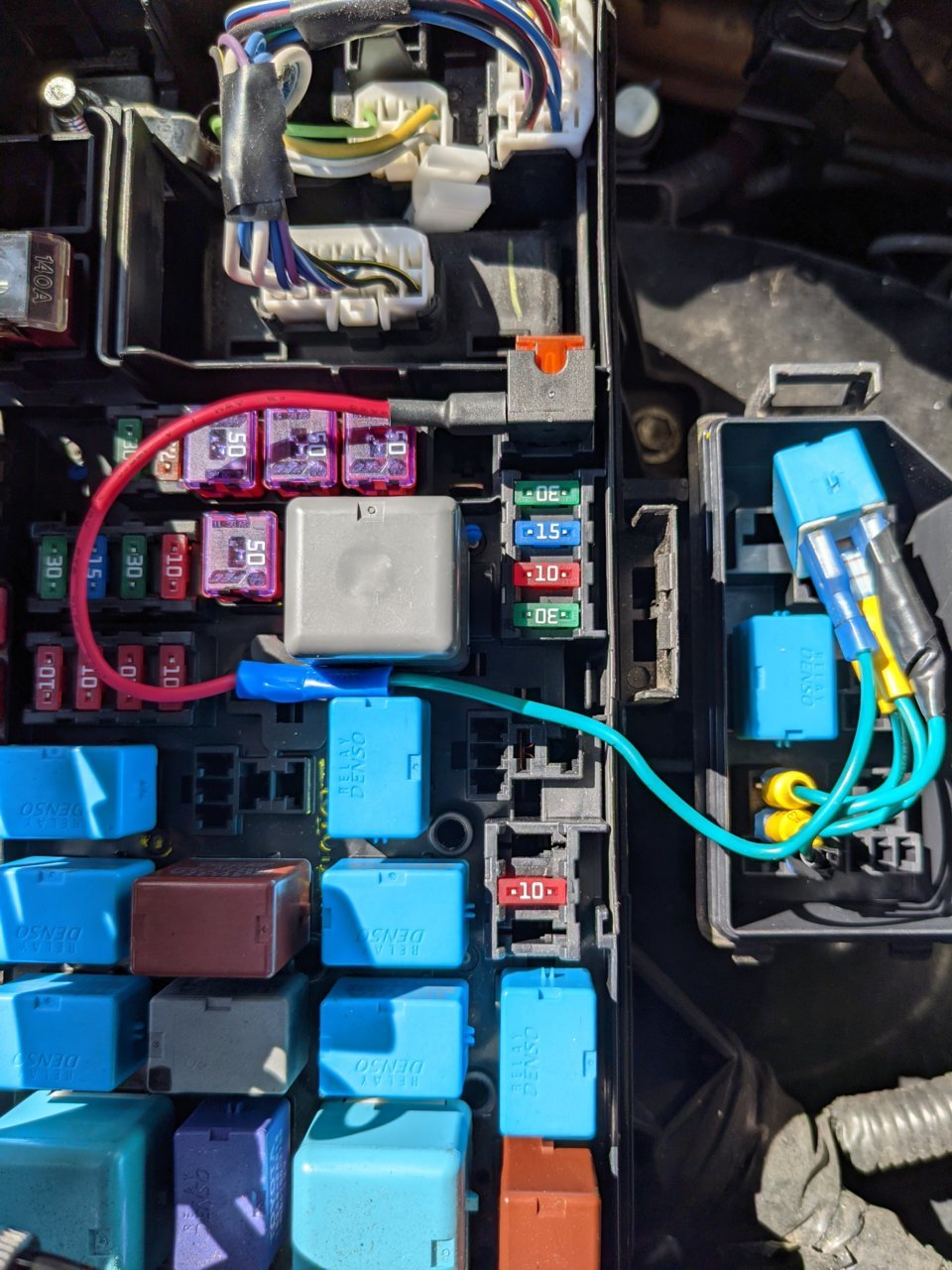

    Did mine yesterday and used an add-a-fuse to tap into the EFI fuse. Works great, however I checked my driveway camera and sure enough they turned on for a minute at 0143 hours last night. Not a big deal, but I might try a different source that won't do that.

    I just went out and moved the add-a-fuse from the EFI location to the AC (Air Conditioning) spot and they seem to be working fine.

    Also, for those wondering whether the EFI will turn them on randomly. This was last night at 0143.

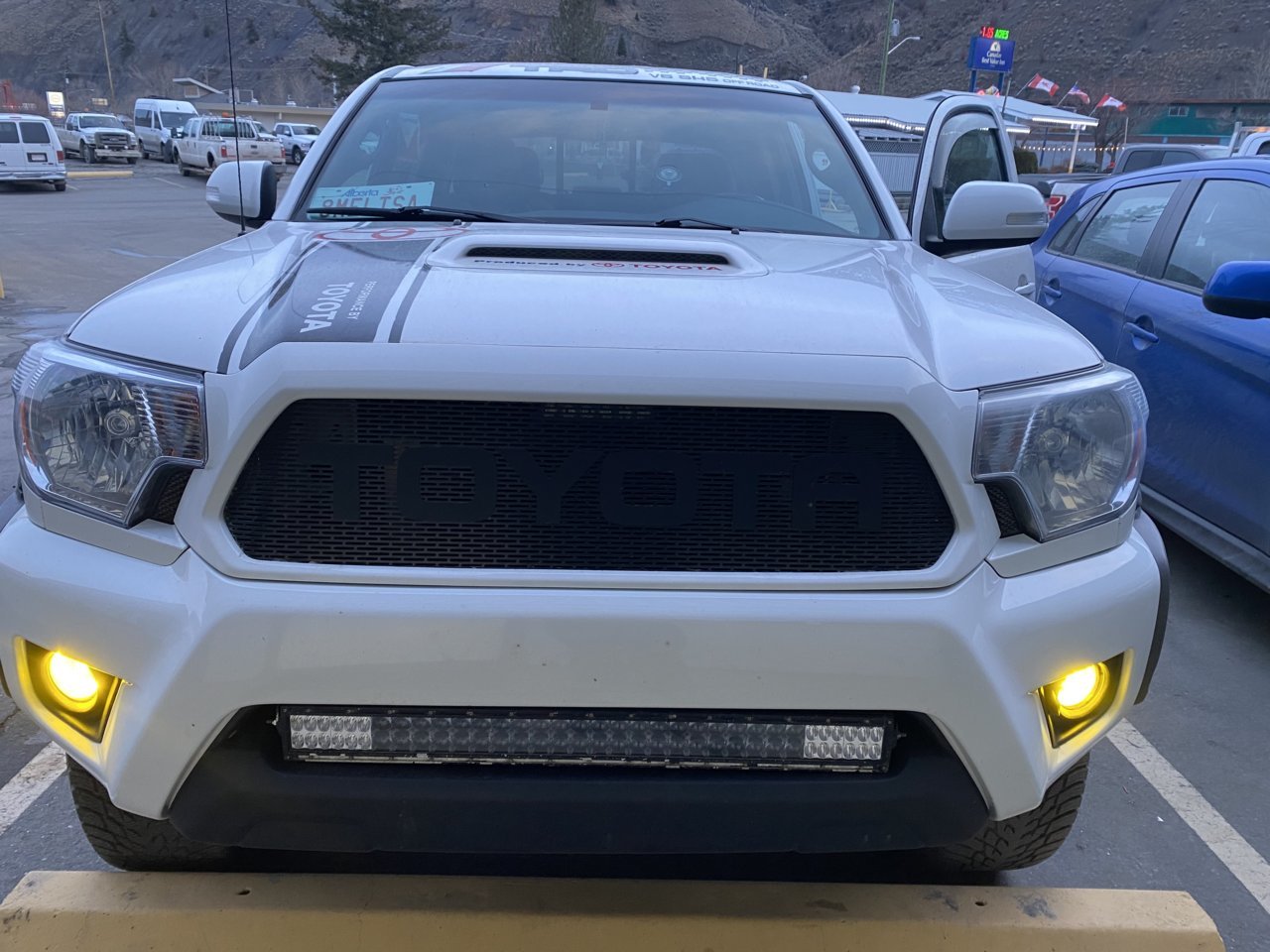

    Can anyone help me out here? I feel foolish now going for the splice option, but I quick tapped into the ac inverter 12V. No fogs, whether lights on/off.

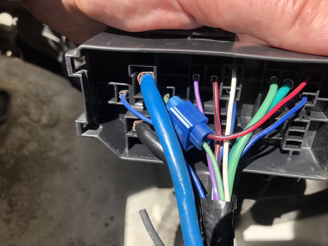

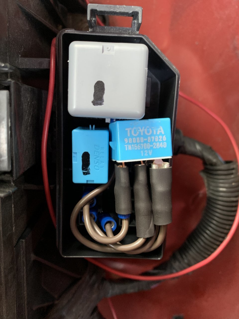

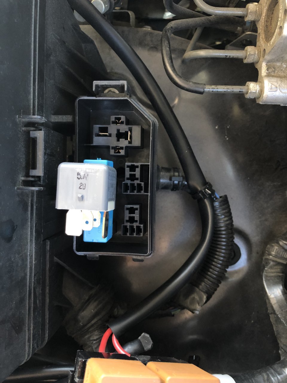

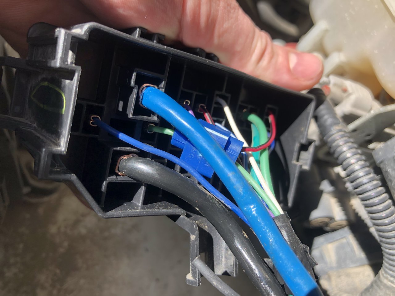

    Help please. My AC relay has 4 spade connections. Does the bent spade connector on the brown wire double into the box with the relay? Thanks
  15. Nov 3, 2021 at 12:51 PM
    #1075
    nd4spdbh
    nd4spdbh [OP] Well-Known Member
    Oct 7, 2013
    #114055
    14,601
    SoCal
    13 DCSB TRD OR v6 Auto
    Yup, both spades will end up down in the female socket of the spade connector that is the bottom most in that picture of the AC relay. GO SLOW when putting the AC relay back in as it will be a TIGHT fit with two spades in there.
    szidls[QUOTED] likes this.

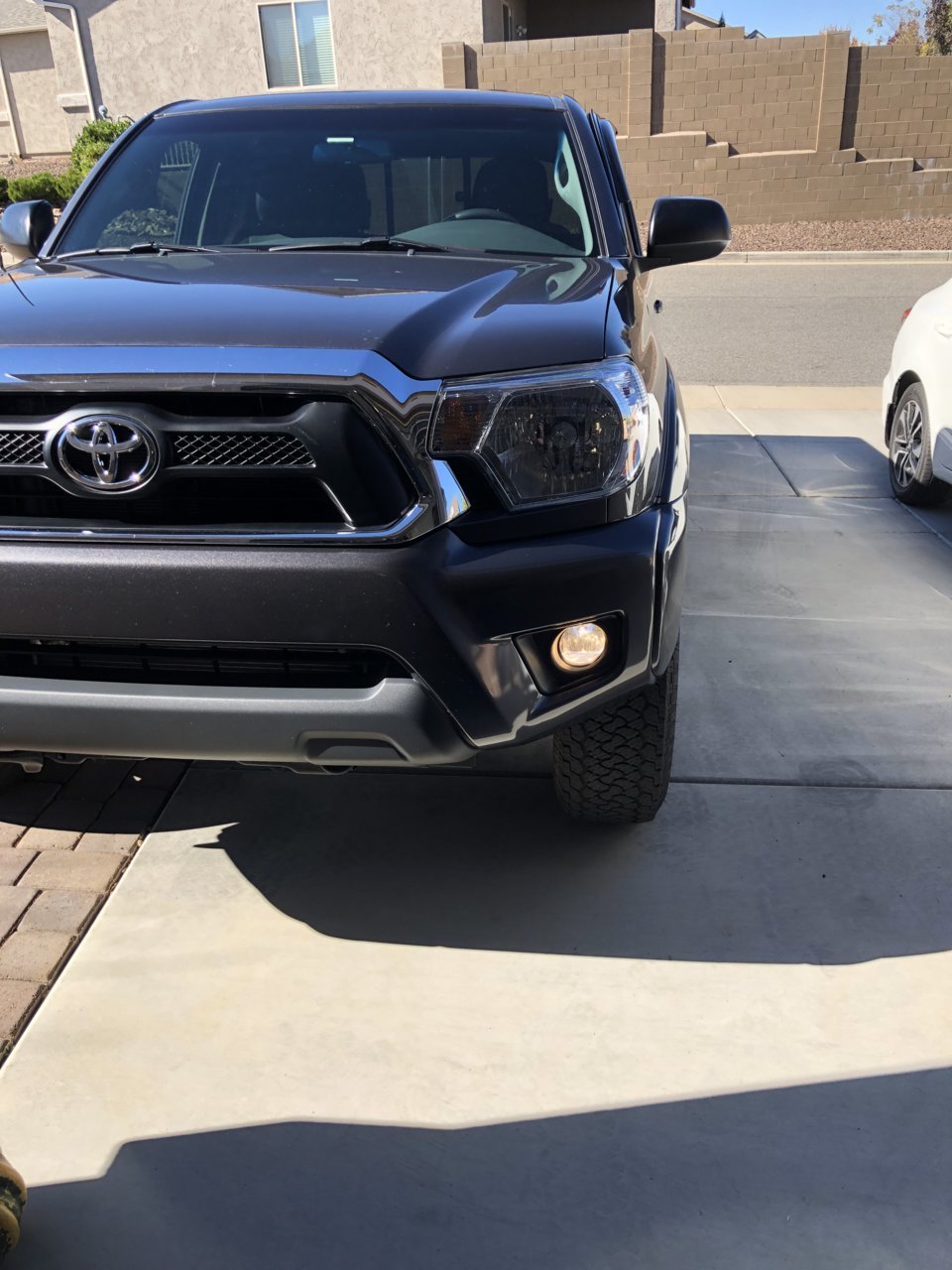

    508C9035-DB17-41D3-A526-D236A2970E0D.jpg 973BA17D-7CC3-4910-9728-0F5D2803423A.jpg
    Did this mod today. Works great. Thanks OP!508C9035-DB17-41D3-A526-D236A2970E0D.jpg

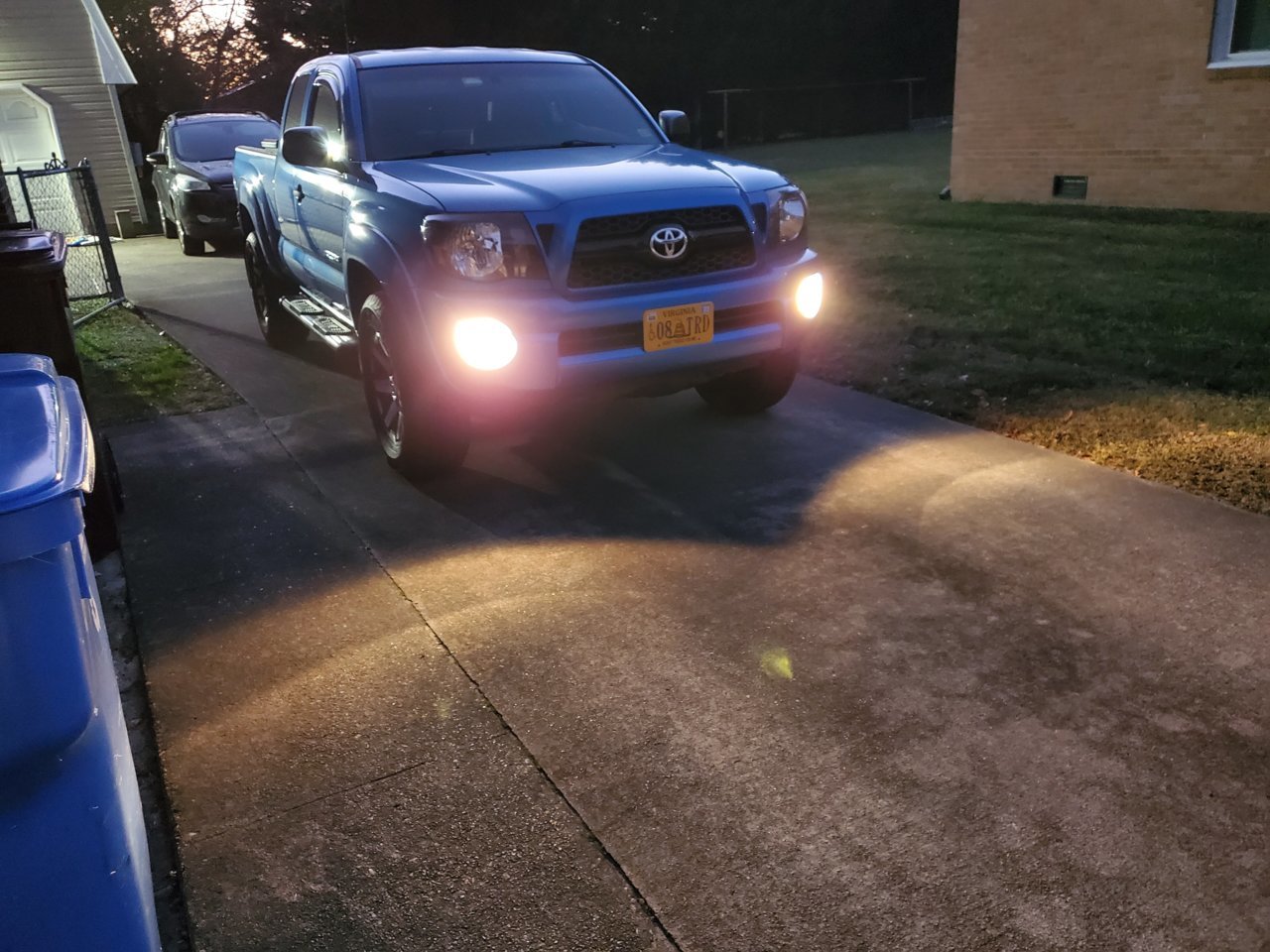

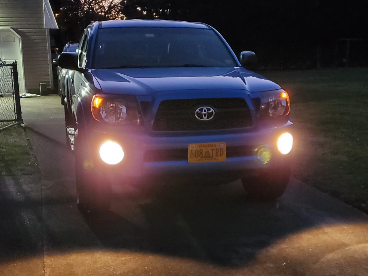

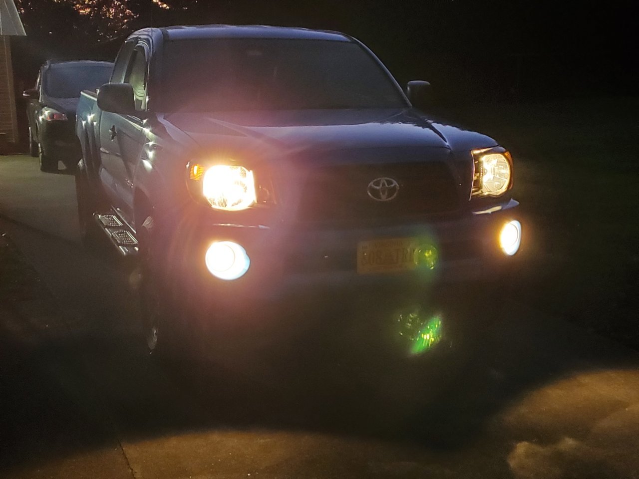

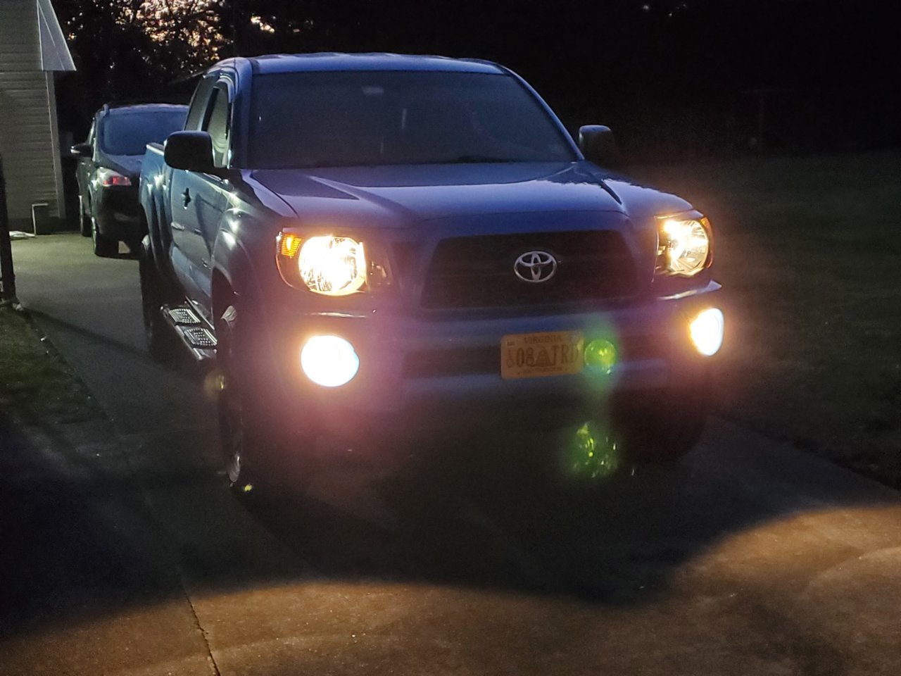

    I just did the "bent prong to acc source" with an inline 5a fuse that took a whole 5 minutes on my 2008 with all in one fuse box. All I need to do is yank the wire and straighten the prong to go back to factory. No worry about fogs popping on and off during the night. Quick and simple.
    Fogs only:
    Fogs with parking lights:
    Fogs with low beams:
    Fogs with high beams:
    eherlihy likes this.

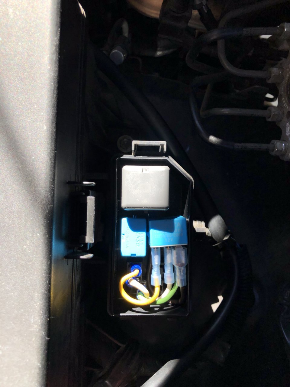

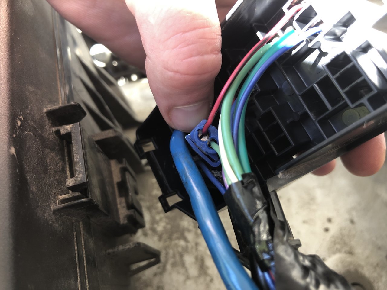

    Did this mod about 6th months ago and just this week I noticed it quit working. I investigated the relay box first and discovered this below.
    Is it as simple as something touched together and caused the burning? Or is it a deeper issue? Where do I check to make sure all is functioning correctly.
    I remade that connector strand but this did not solve the issue. Will I need to replace this relay box? Thanks for any help!
