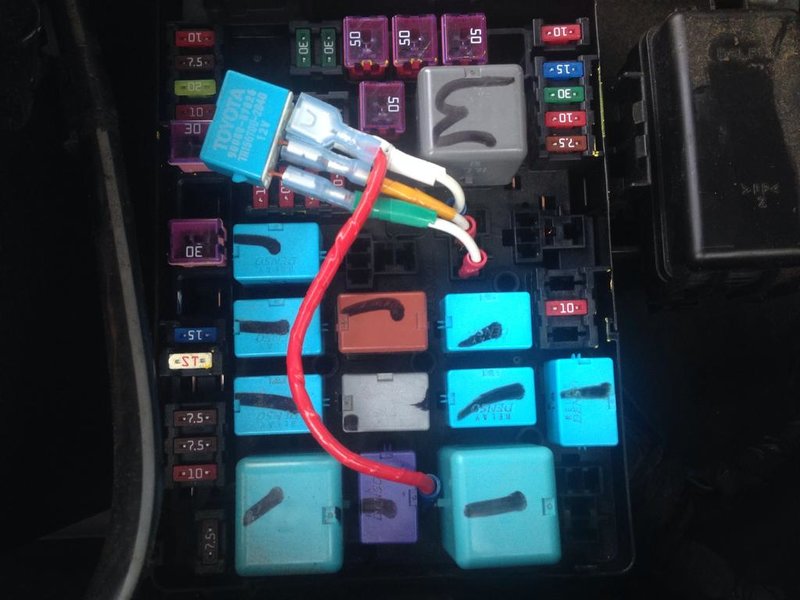

    connectors should never be used in a non insulated state!
    But glad it worked out in the long run, you probably didnt fry the original relay.

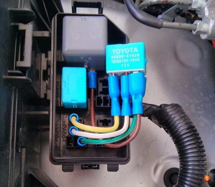

    You can do the same thing from the AC relay in the lil accessory relay box to the right of the main box and you FR FOG relay.
    Your relays are in just slightly different locations than the new setups. Also you could possibly pull from the EFI relay as pictured in previous posts but i am not sure if you would get randomly turning on fog lights.
