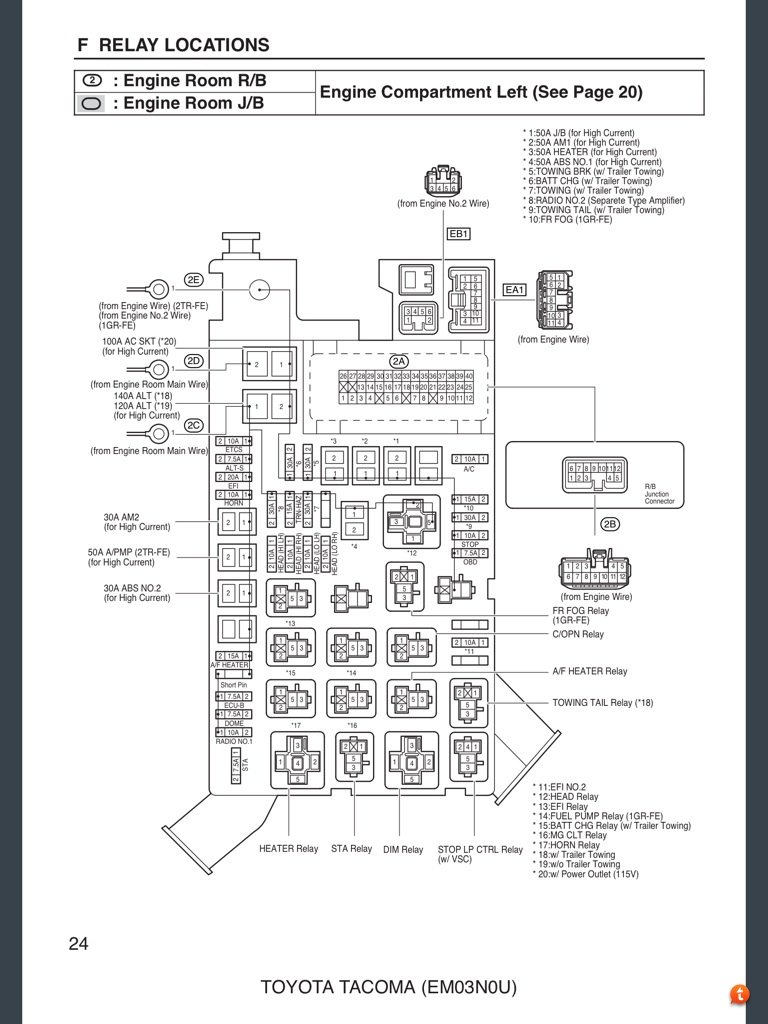

    Did this today on an 07 via the EFI constant (13 in the pic pin 3). No problems.

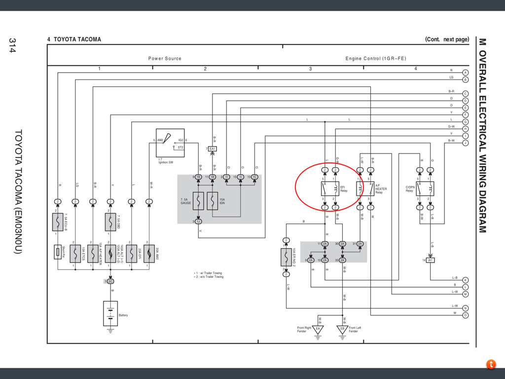

    Not to be an ass but to verify you plugged the relay back in when you checked on pin three correct? If not you won't get anything. See the attached schematic.

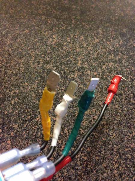

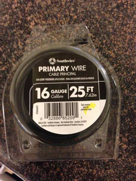

    Ok, just did the mod. I know I had a few questions such as where do I get male and female blade/spade plugs and wire now instead of ordering them online. So I've posted what I purchased and some other photos that may help you out. I'm not gonna lie this is only my second modification on my 3 day old new truck but my god I love this mod already!!! ND4SPDBP....you sir are amazing thank you for posting such a great and reversible modification!!! I did have to do this twice, the first time I cut down the male plugs too much and they wanted to slip out. I also made the wire too long and after crimping well....you're kinda SOL. I was also excited and rushed. The second time I slowed down and it went much smoother. I wish I could have found male plus without the hard plastic cover it would have made it a bit easier.

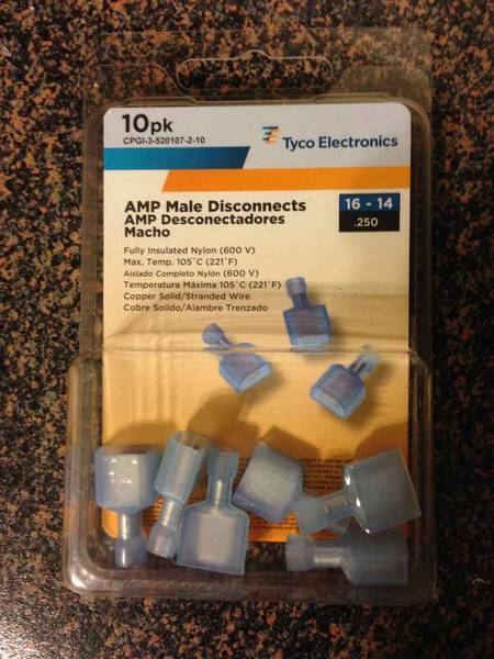

    Here are the Male plugs I used. The Female look just like them. I bought these at HomeDepot in the Electrical section.
    The 16awg wire that I purchased. It's braided. Its a small spool. It's also from Home Depot. They had other colors if you don't want black.
    Here's the Electrical tape I used to color code the black wires to try to match the original colors as closely as possible. I used red in place of brown. Also purchased from Home Depot.

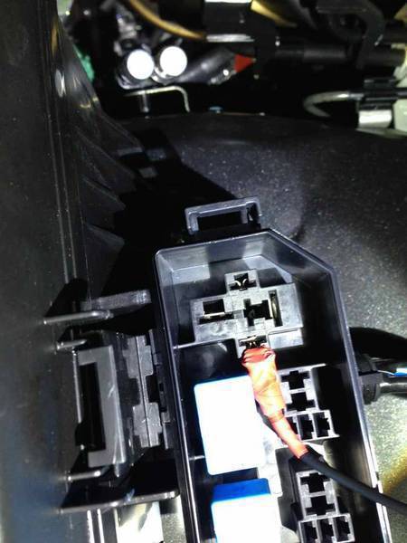

    Here's how I inserted the Red lead into the AC-DC converter. I have a 2014 DBLC 4x4 Sport/Tow. I did check it with a volt meter this lead stays on with the 100/400W switched outlet on or off. You will have to cut down one of the male plugs. I used a grinder to do this particular one but was also able to do with with some side cutters as well. As you can see it does not go into the same channel as the original male prong on the AC/DC converter relay it goes into the little "half channel" just in front of it [​IMG]
    Here's a picture of my finished wiring. You will have to cut off the blue plastic from the male connectors if you use the ones posted above. I found a little dremel cutting/grinding wheel to be the easiest to use. But I was also able to do it with a small wire side cutter it was just a bit of a pain in the ass. I then wrapped the ends with electrical tape to try to cover the "crimp" and the tiny bit of exposed wire to not have a short. [​IMG]
    Hope that helps some of you out. ;)

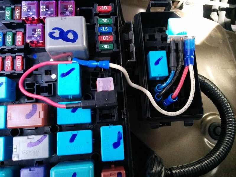

    As I have been a bit anal about this whole thing and not wanting to mess with other relays, I opted to use an "add-a-fuse" to the switched EFI fuse holder with a 3A fuse for the fog lamp connection (smallest I had). I also used std 1/4" M & F connectors for the wires on the wider in-line side of the relay and 3/16 connectors for the narrower, parallel end, rather than cut anything down.
    It works great and is easily reversible, if needed.
