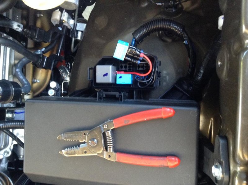

    SO with the 4 wires on the fog relay, can you still close up the lid on the relay box?

    Mine is closed..it's more of a pain to open it than to close it.

    So I just completed this mod myself, and it works great! Had a bit of an issue as I the female connectors that didnt have the rub covering and my hook up wire was a bit stiff and too long. But wrapped the female connectors with electrical tape and managed to get the wires bent to fit in the box. I have heated leather seats so I had an extra relay in the box to work around.
    Great mod info and pics, I am very pleased with it. Will be even better once I get my amber fog bulbs.
