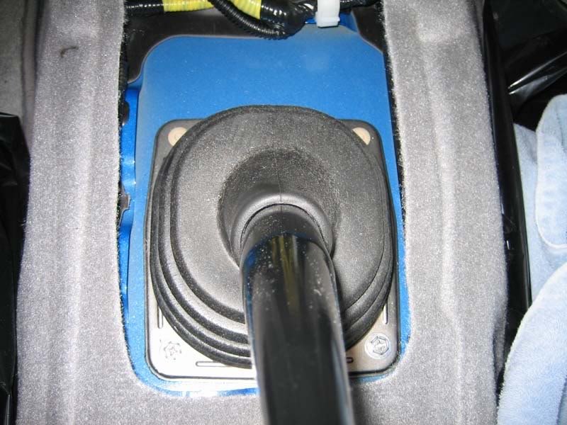

    Shouldn't the drain holes be sealed? I know for me having a manual, there is basically a big hole where the shifter is. Dunno if the automatics are the same way.

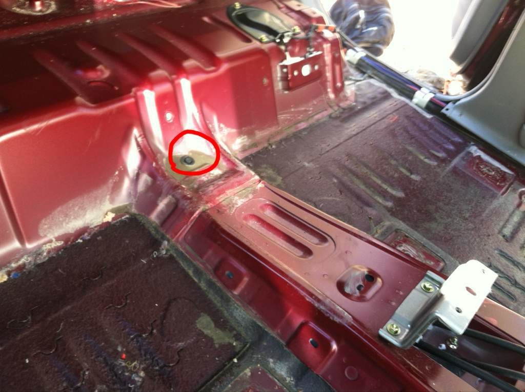

    NOTHING came through the door seals actually. All the water was under my carpet and in the door kick plate channel things. The only place that leaked on the top of the carpet was near where the seat rails bolt through the carpet once the sub carpet area filled up haha.
    The drain plugs are idiotic. The only thing holding them in is the carpet. If you put an entire truck's weight on that plug with just the carpet holding it down, you're gonna get leaking. Now if the plugs were on the bottom of the cab, it would force the plugs to seal tighter. My truck leaked from the plugs mostly. You can see the large accumulation of mud and sand around the plugs, which I have circled in the first two photos.

    This is the hole around my shifter
    Edit: there is a boot, but I doubt it would hold back much water if I went deep enough.

    I'm very surprised you don't have a boot for that! Don't go fording water!
    Edit for your edit: that boot looks like it'll seal ok. I would throw a bead of silicone around the base when bolting it to the trans tunnel. Maybe a pipe clamp on the boot where it goes on the shifter?
