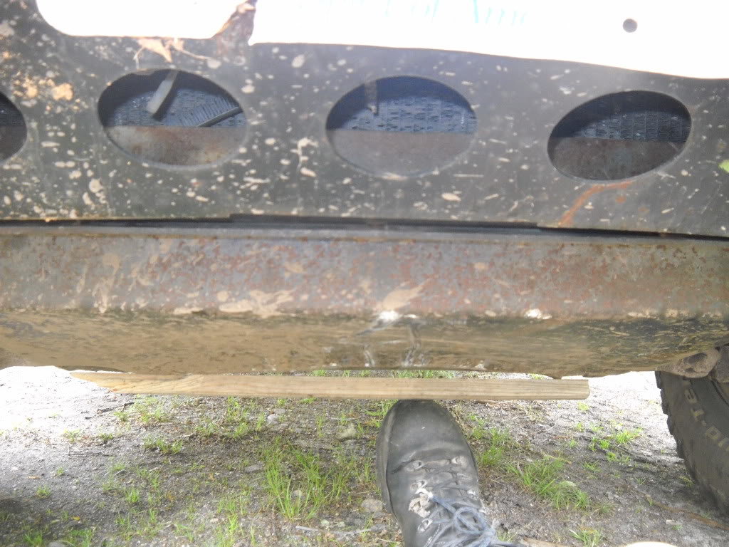

    bud built uses 3/16th. I have bashed mine pretty good and had it supporting the whole front end a bunch of times. and only put a few small dents in it. Untill I fell off a big ledge at gretchans and landed square on the center of the skid hammered it out its a little fucked up but its pretty good. I wouldn't use 3/16ths for a tcase skid just because you have so much unsupported area, you would be bound to dent it in.
    This is before I hammered it out.006_c303e4b53cf10996c99d282ee6d71d7cc9bdfd88.jpg
