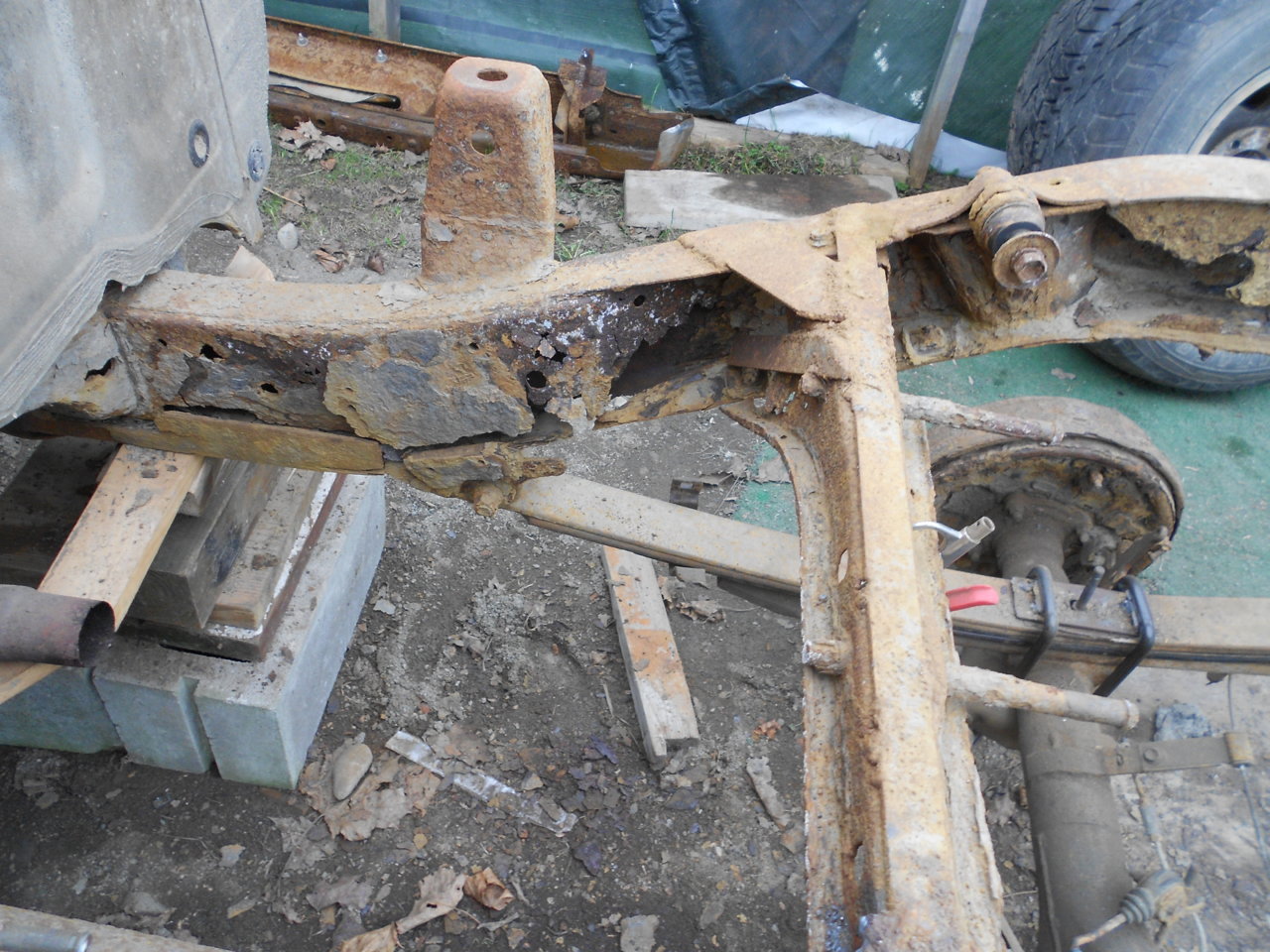

    The background: I bought this truck 6 years ago, 2002 base cab 4x4, 2.7 liter. When I bought it the previous owner retired it for frame rust, it was just starting to fall apart. Six years later and half the frame is air. The original plan was to patch it up, get it inspected and run it for a year or two. Well, I was looking for something else to drive, something old, pre-smog, but I never found the right deal, so I kept putting bandages on the Taco, fast forward to today, there's not much I can do other than stop it and repair it.
    I was going to throw money at a new project, a pre-smog ride that I never found, now instead I'm going to throw money at the Taco, this will be that story.
    You folks are going to think I'm crazy when you see this frame, most will probably think it belongs in a scrap yard.DSCN1244.jpg DSCN1243.jpg DSCN1242.jpg

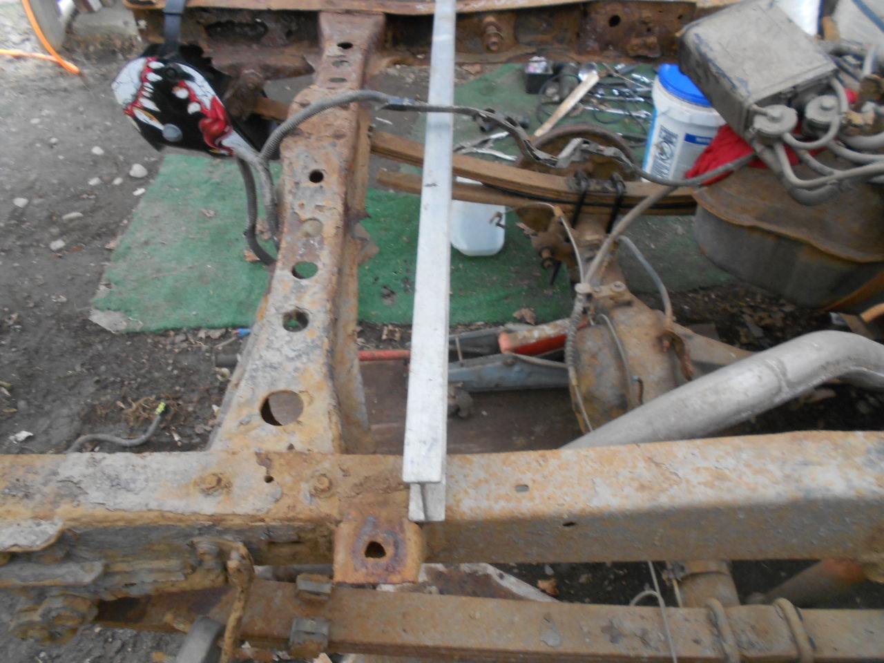

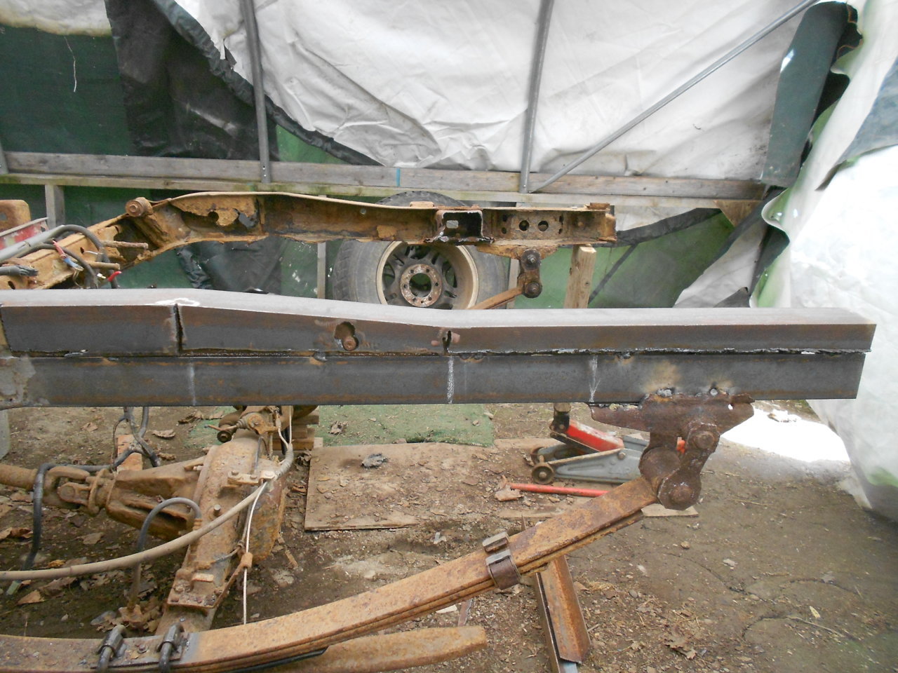

    Bottom photo shows a broken leaf, I completed the repair and added a pair of torch 2" lift helpers. Also note broken and patched cross member and material missing from the bottom of the frame rail. More photos to follow.
    Can the star type wheel in the background be ID'ed? I don't think it's stock, it's a 16" tire?

    I have to work on my frame a bit as well, not quite as bad but salt belt blues (I treated the frame myself for over 10 years but have been lax these past after Toyota sprayed their goop)
    I think that wheel was a "southern" special maybe? I've seen it before but am drawing a blank

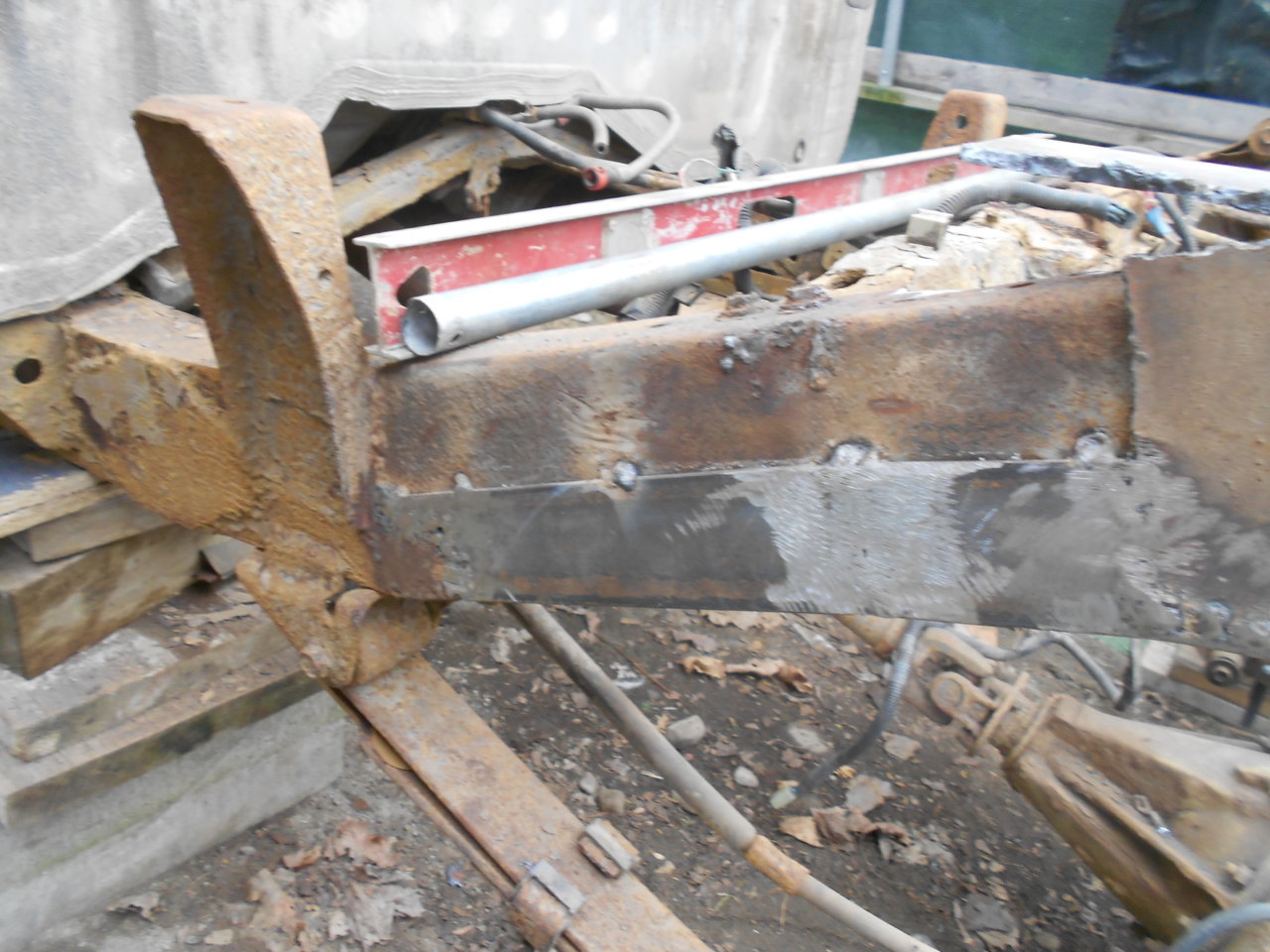

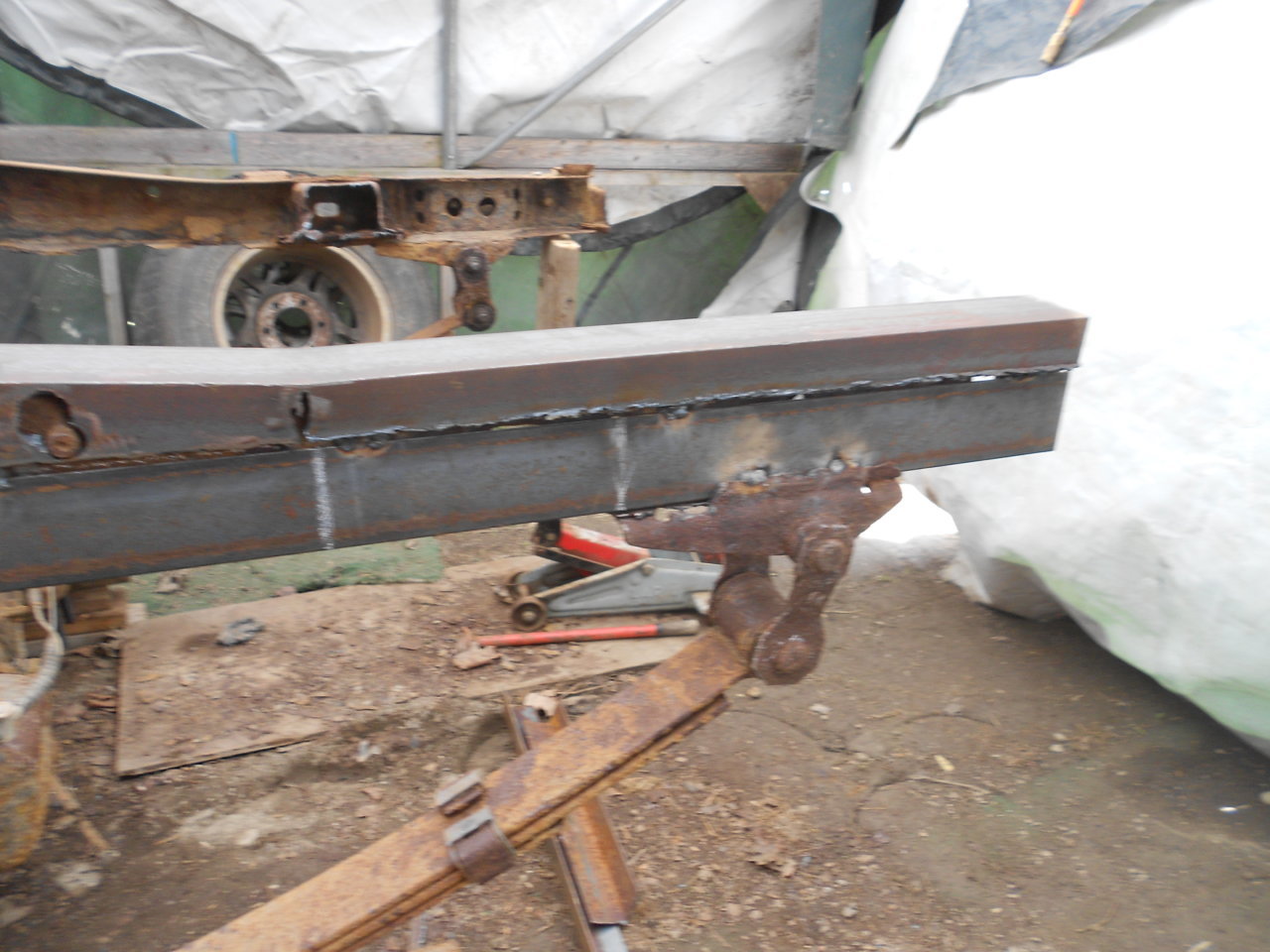

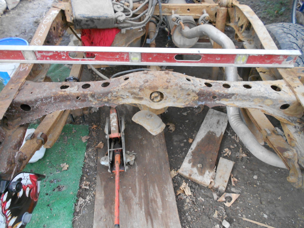

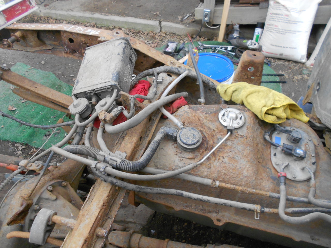

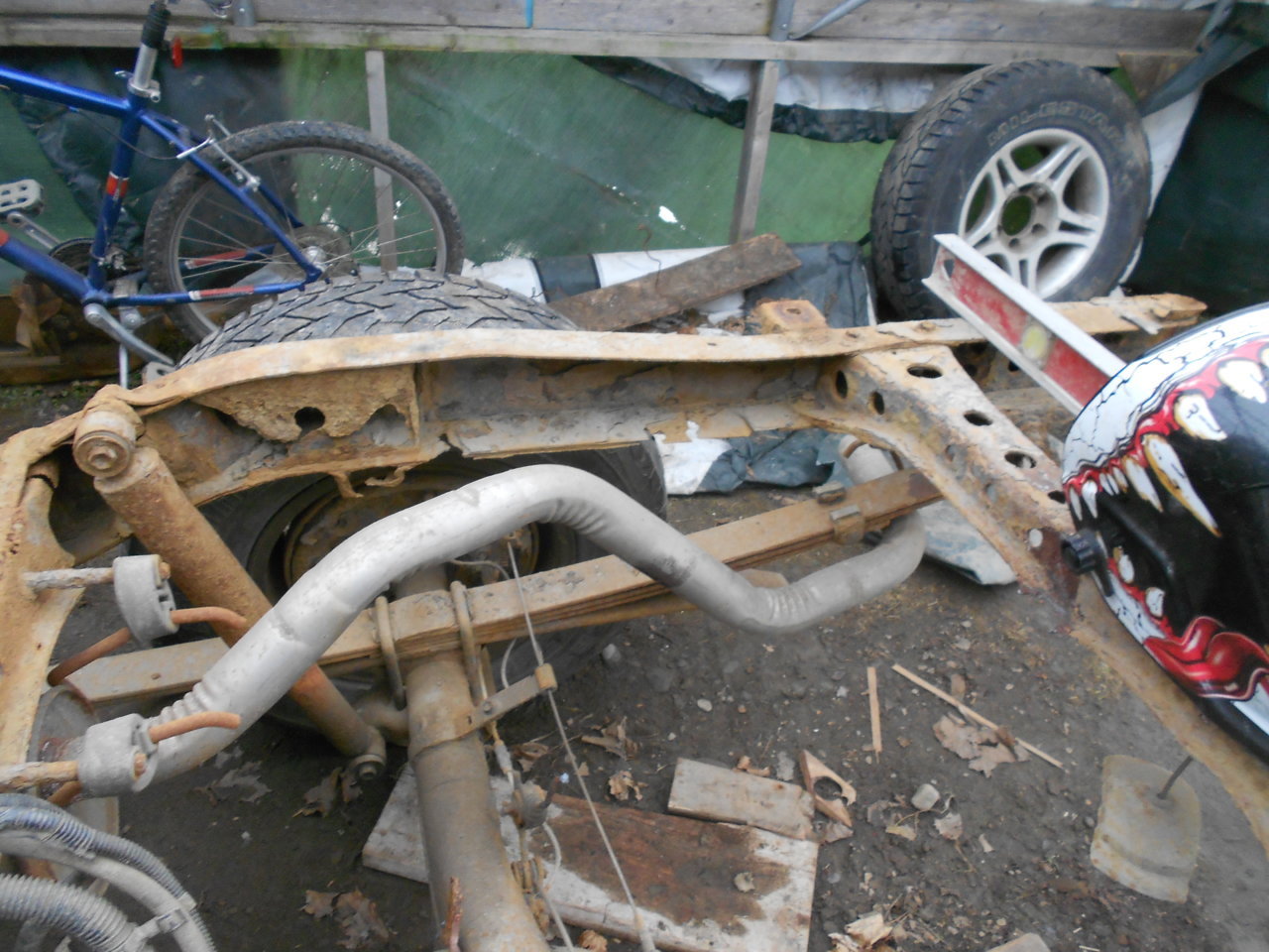

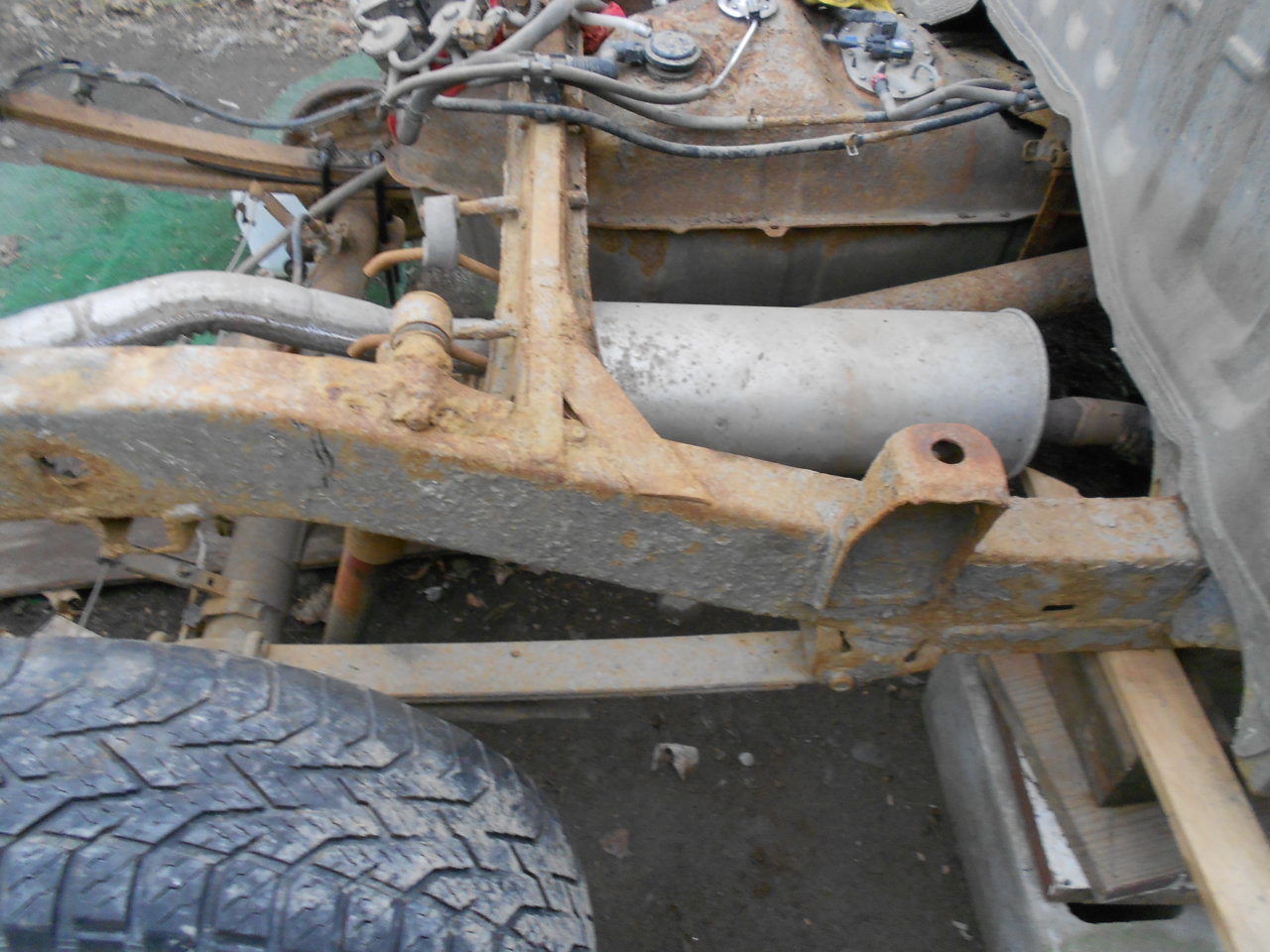

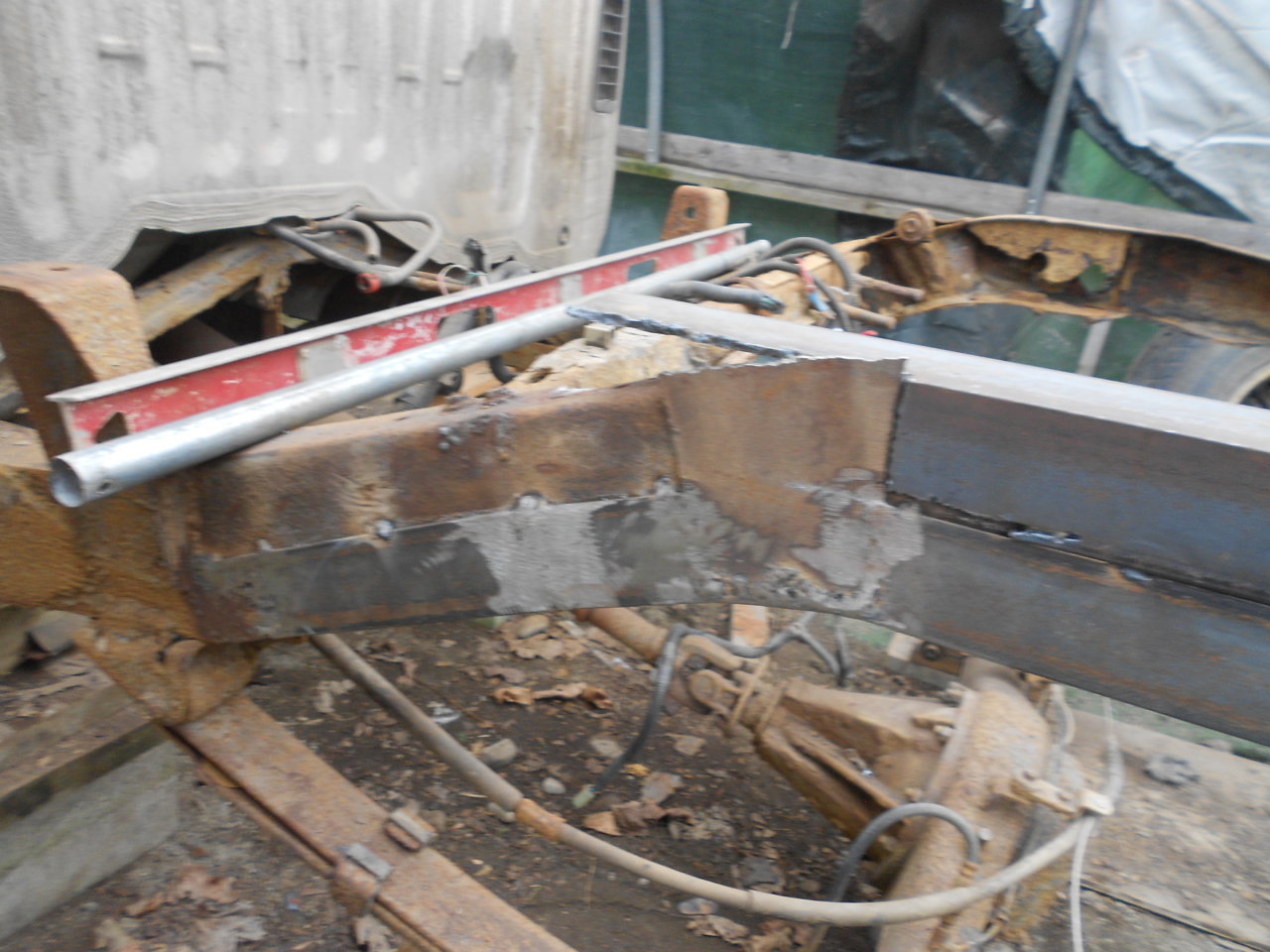

    Photos from today, camera battery needs to be replace, the lens needed assist in closing.

    I'll use the side that's fitted as a pattern for the other side, everything gets tacked before final squaring and leveling and stitch weld. Gotta get both sides to match then use the bumper as a width spreader, after that some boxing and install new fabricated cross members.

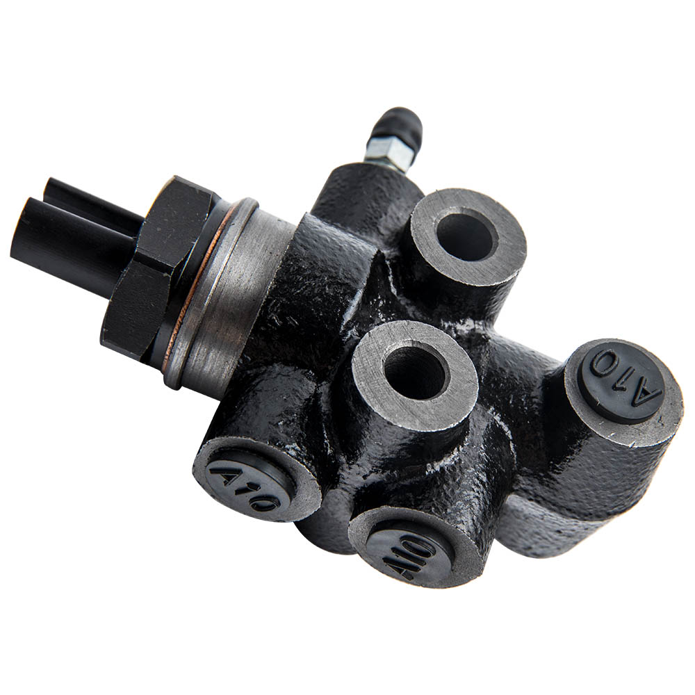

    I think I might have it nailed down. The three rubber plugs with A10 on them.
    The one furthest right goes to the rear end / rear brakes supply.
    The one in the middle is the bypass return line.
    The one furthest left is pressure supply from the front.
  14. Jun 28, 2022 at 3:25 PM

    Now my logic.
    I think the engineers or designers intended for the valve to be self explanatory. There are two ports that are inline, and one port positioned at 90 degrees rotation from the two inline. When bolted to the frame the port that is alone points towards the rear end, it points across the frame, inline with the rear axle, the other two ports point forward. I'm going to assume that the one pointing at the axle is the supply for the axle.
    Now the two that point forward are stacked when the part is properly installed, an upper and a lower port. At the front there are two junction blocks, the block closer to the rear end sits lower than the block that sits forward of it, the rearward (lower block) is traced back to the master cylinder and is pressure supply for the rear brakes, the other block, the forward block that sits slightly higher traces back to the front brakes pressure block. I think it is just as it looks, the higher block goes to the higher port and the lower blocks goes to the lower port.

    I got the new valve at Amazon, it was on sale one night and I bought it, today's listing has it under $30.
    https://www.amazon.com/gp/product/B07N4LH9YX?ie=UTF8
    For replacement brake lines I'm using coated steel with stainless fittings. Going to buy some stainless tube in the future, see if I can work with it.
    My plan is to mount the BPV or brake proportioning valve under the hood, and route the lines accordingly, by doing that I only have to have one line to the rear. In effect I'm extending line from the rear end to the valve and moving the valve forward, shortening the other two lines.
    I'm not going to use a BPV weight adjuster, I'm going to run it as unladen, the stock configuration, no load on the valves plunger. I'm doing the rear disk conversion too and those are sometimes noted as locking up when unladen and a BPV isn't used, I've read posts both ways, some say no problem and some say lock up.

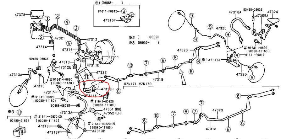

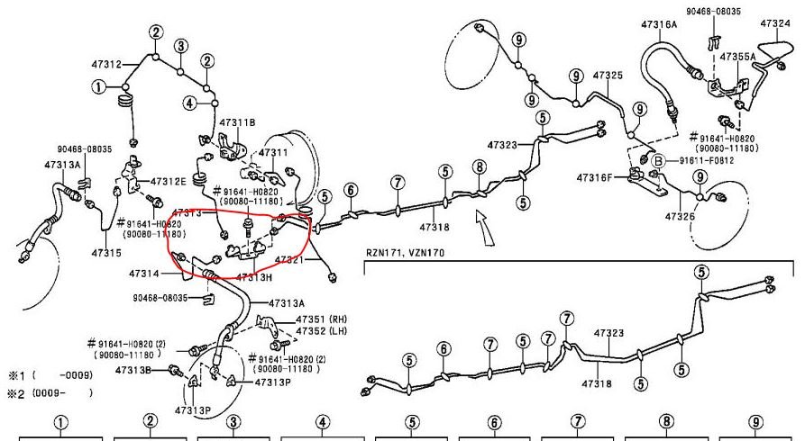

    Looking at the toyota diagrams, it looks like those two blocks differ between ABS and non ABS models. I'll post em up here in a minute. It looks like on the ABS models like ours, the forward (higher) block is a 90 elbow like in your picture, but on the non-ABS models, its a T-junction.
  20. Jun 29, 2022 at 5:36 AM
    #20
    Jakuku Pahwheenis
    Jakuku Pahwheenis i provide useless forum contributions
    May 27, 2022
    #398083
    1,098
    J Phoenix
    South Carolina
    2003 Xtracab 2.7L 3RZ-FE 4x4 manual 245K+ miles
    Here's the ABS diagram, junction blocks circled in red:
    And the non-ABS diagram:
