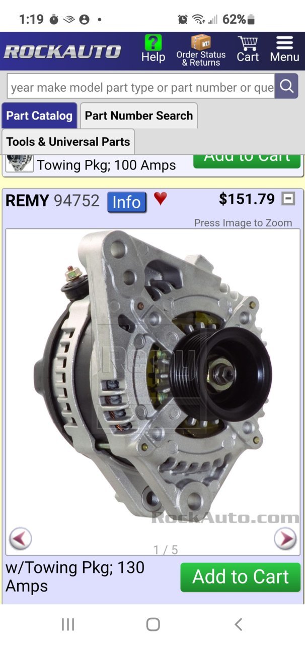

    What would be the part number for a 07 Tacoma alternator that has the towing package.
    I’m assuming it’s different than the “normal” ones

    Scottsville Kentucky
    17 Double Cab M/T TRD Offroad Blazing Blue Pearl
    Redline custom leather shift and e-brake boot. VFTUNE Super Full Otto cycle, octane learning, premium fuel.
    You can usually get them from a parts house for about the same since rock auto charges shipping.

    '18 Taco Sport, '14 Ranger
    and many times they'll have a core charge, so it can be even cheaper.
