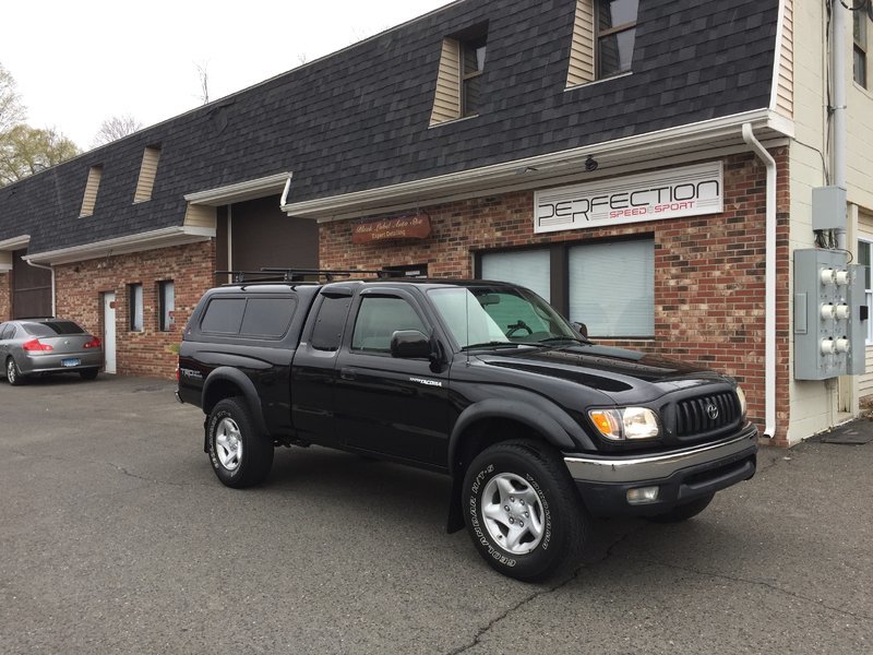

    Hey all,
    Purchased my 2004 Tacoma Xtracab 4x4 TRD Package back in Dec. 2015 after almost a year of looking for something relatively rust free and stick shift. Saw the ad for this and jumped on it. Looking back I am beyond happy with the investment because this truck has been great and has taught me a lot so far..

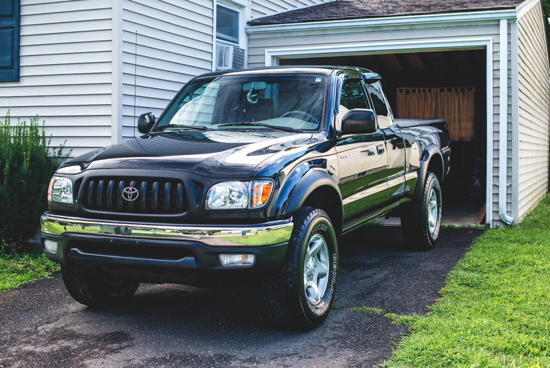

    Truck when I purchased it was 100% stock minus the vinyl tonneau cover for the bed and side steps. It had 99,700miles. First thing I did when I took it home was remove those side steps since I'm no grandpa :p:
    [​IMG]12/31/15 by neatoneto, on Flickr

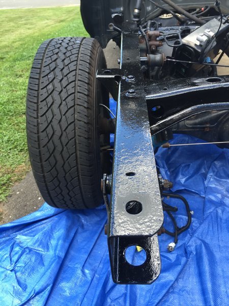

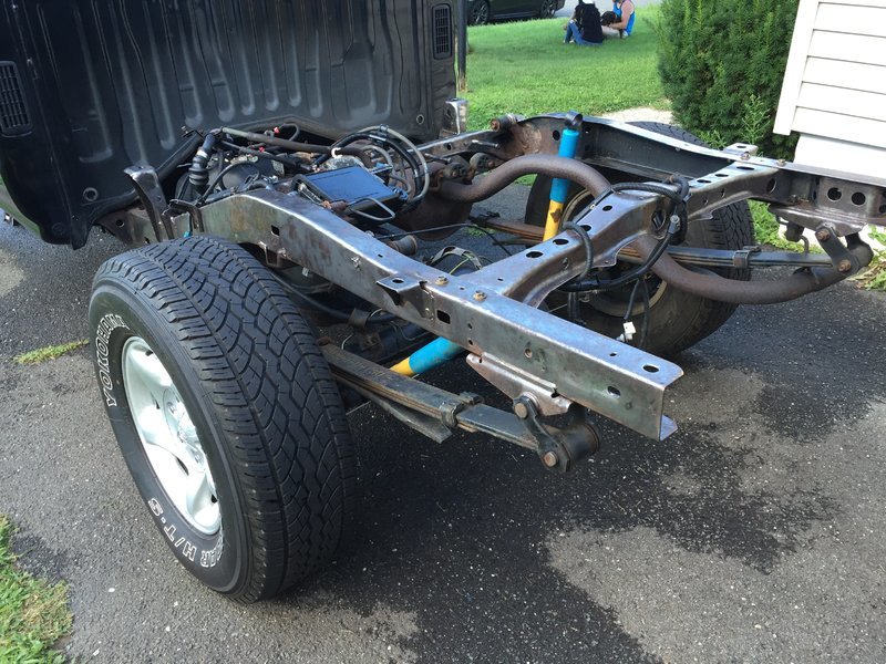

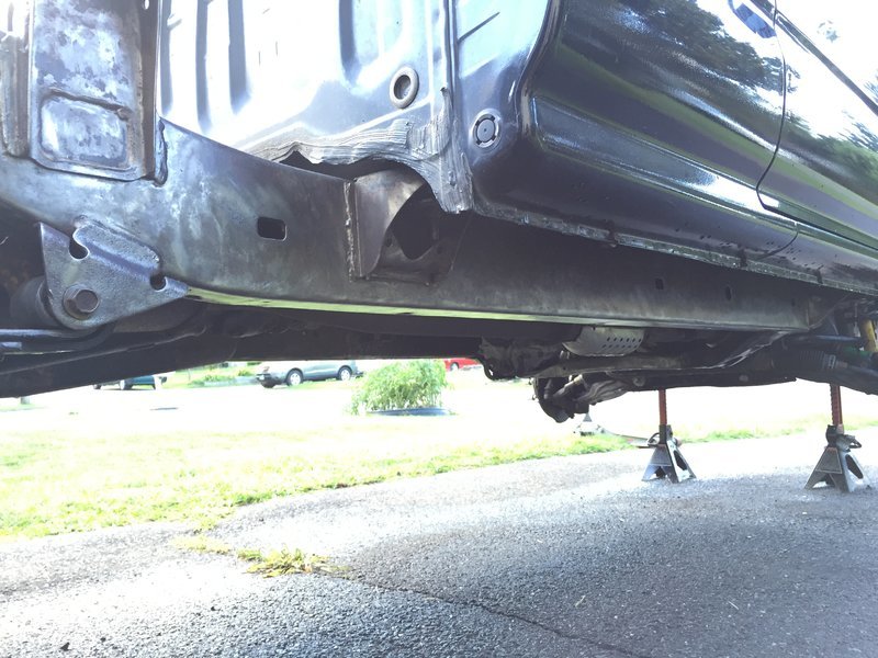

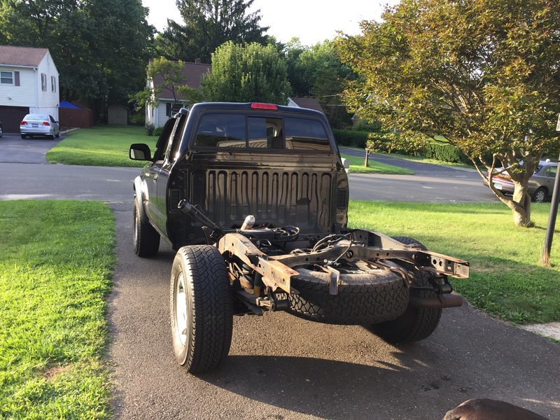

    Started gring down the frame before laying on Chassis Saver. Planning to use my grinder and wirewheel to grind off paint & rust the use a 50grit sandpaper to prep for the paint.

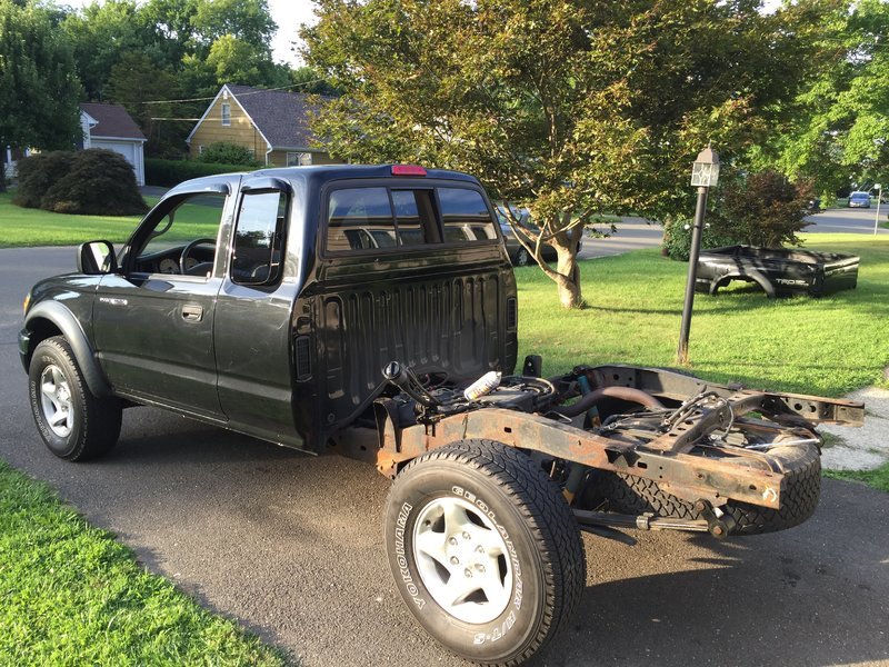

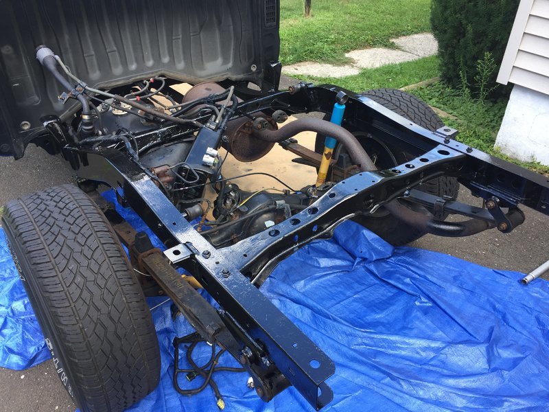

    Grinded/sanded as much rust and paint off as I could. Used Simple Green degreaser after and I wasn't expecting it to shine as much as this!
    Tomorrow I will be carefully laying on the Chassis Saver

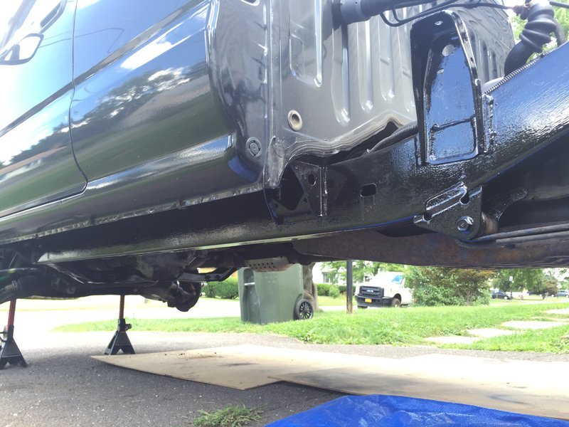

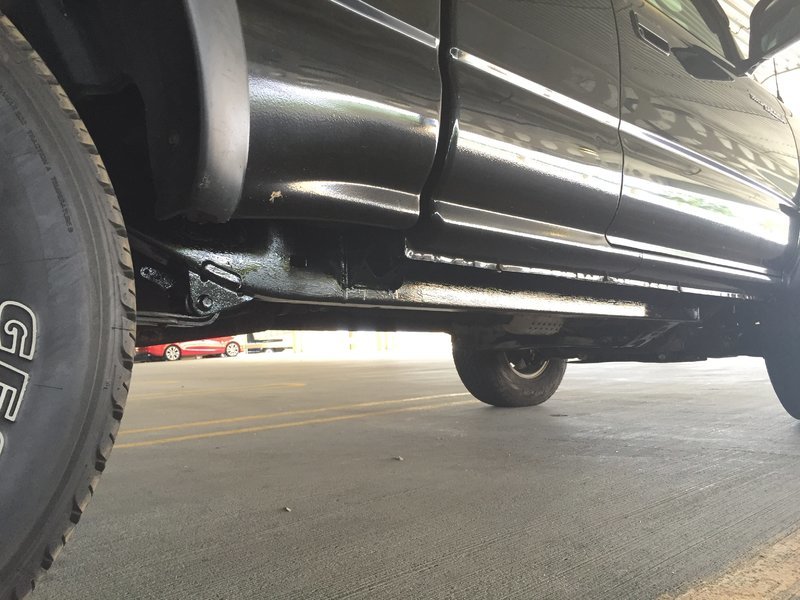

    Laid down the 1st coat of Chassis Saver.
    It is SUPER sticky stuff while it's wet then hardens to a smooth coat after it's dried up. Took about an hour to dry up. Going to give it another hour then do the second and last coat. Very happy with the result. Stuff is very good at coating any loose-ish rust

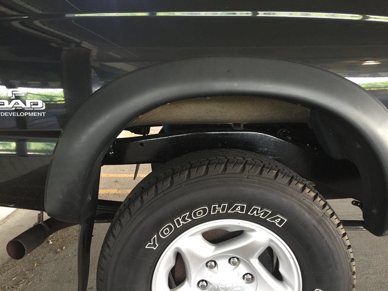

    Finished the second coat. Very content with the result. Waiting a few hours before putting the bed back on.

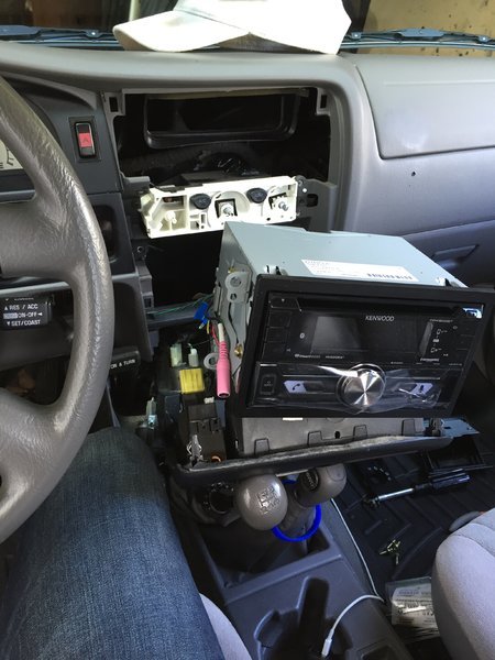

    Added a much needed upgraded head unit. No more FM!

    Thanks man! I lowered one of the straps on the tank to give me enough lee-way and also moved the smaller black box on top of the tank out of the way to get access to one of the cross members. It's a sweetspot for the rust!

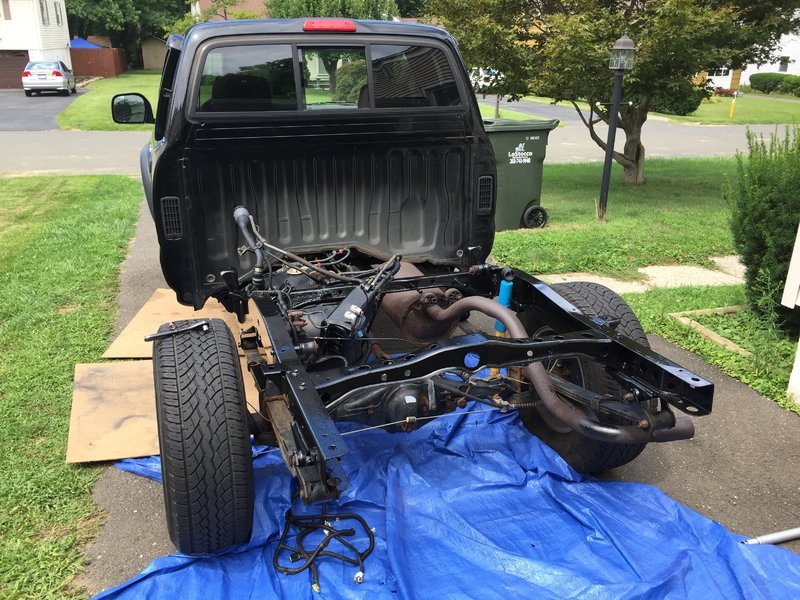

    Trucks back together. Last thing I'll probably get done until the end if the year is a full professional detail

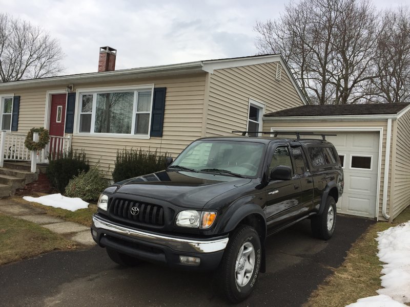

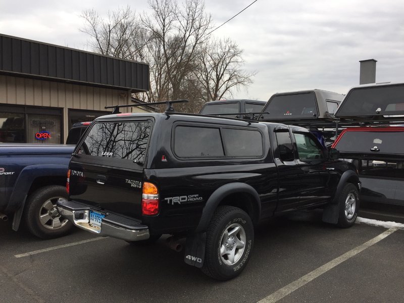

    Finally picked up a Leer bed cap! Looks amazing in person and adds so much more versatility!

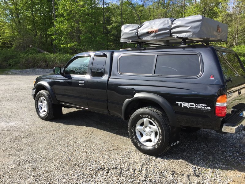

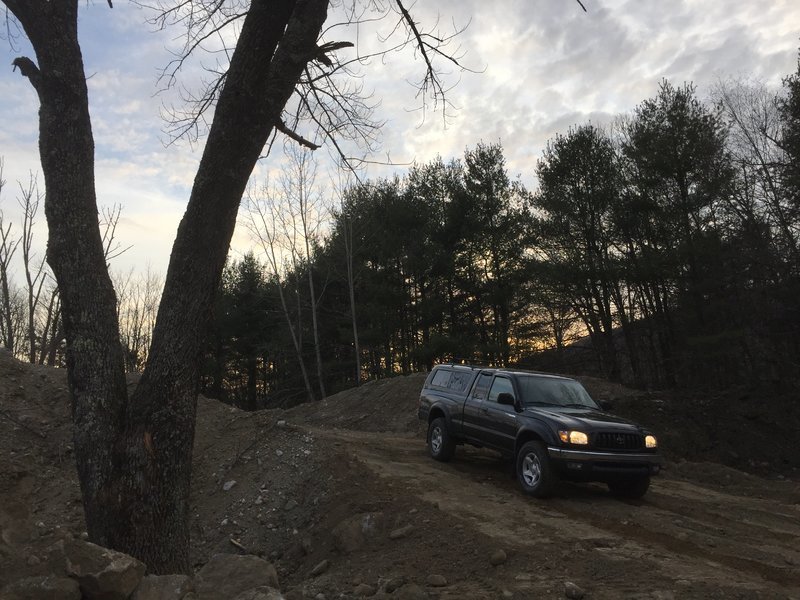

    Replaced the steering rack guide which restored my loose steering back to stock! Gave her the weekly wash and installed my roof-top tent!
