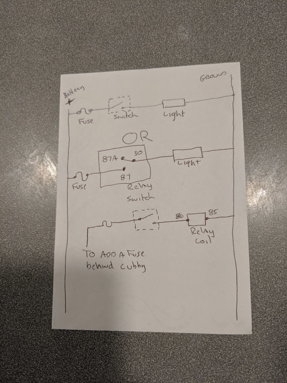

    Welcome to TW.
    Adding a light that's switched is easy enough to do.
    When is this light required to be used?
    Are there wattage requirements for the light?
    And not to rain on your parade with talking the taco with you, but have you considered parts availability in Scotland?
    As for wiring the light, there are a couple different ways to do it, depending upon the size of the light used and the overall aesthetics inside the cab with the switch.
    If you don't care about the aesthetics, you can pick up a toggle switch and wire the light through that. Mounting it wherever you like.
    If you want to use a matching type switch to what is in the truck already, I would suggest using this switch to turn on a relay that will feed power to the light. These switches, generally have a current rating lower than what a toggle switch has.
    Give me a few minutes and I'll post wiring diagrams.

    Ok, wherever you get 12v to feed things always install a fuse as close as practical.
    Rule of thumb, every 120 watts is about 10 amps at 12 volts. The electrical system tends to run slightly higher voltage, so slightly less current. I use 12 v to make the math easier.
    If you go with the relay option, be sure you plug the add a fuse in with the proper polarity. I had one in backwards feeding a charging port. Blew a fuse and the wipers, (chosen location to grab power) would turn on if the charger was plugged in!
    Good luck.:thumbsup:
    Edit: that fuse drawn on the bottom of the ladder diagram IS the add a fuse.
