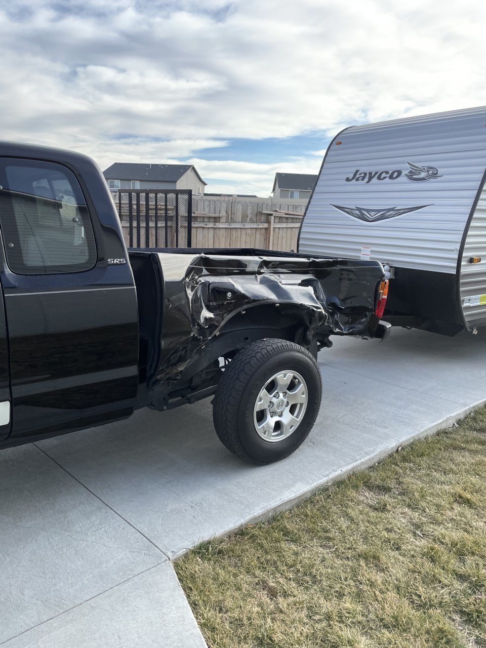

    So I bought this sweet truck a week ago. Got in a T Bone wreck the other day in her. I have been trying so hard to find someone or somewhere to get this fixed. Would anyone happen to know if this is fixable or would I need a new bed. And if anyone had one for sale I could buy. EFD12D19-50AE-4C08-8261-CD1D64049D3D.jpg

    That bedside is not fixable. Whether it's cheaper to replace the bed, or just that side is dependent on whether you can source a salvage yard bed in your area.

    Bed is trashed beyond repair

    Have you had the frame inspected yet?

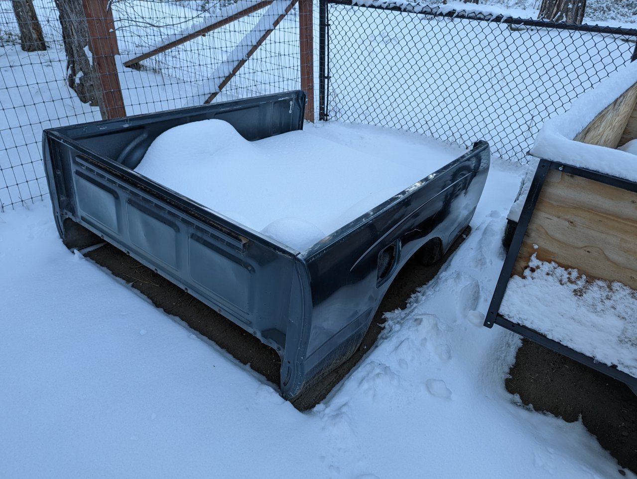

    Hope it works out - bed is easy to take off with a helper - like 5 bolts and the taillights - may want to check if you need the fuel filter neck or something before hand depending on the severity of your wreck
    there’s a couple YouTube’s on it if you get confused

    Also Check under the plastic bed mat, if it was kept on there there’s a good chance there’s rust around the wheel wells, nothing a little weld / rust arrester / bondo can’t handle, but you’ll want to raptor line that asap after gussying it up

    You sure there is no frame damage, axle and leafs still straight? If you are interested I have a green bed. For $500 I am near South lake Tahoe. About 7.5 hours away.

    That bed is WAY beyond reasonable repairs. I suggest searching car-part.com for junk yards close to you that might have a bed that will work.

    Double check for frame damage.
