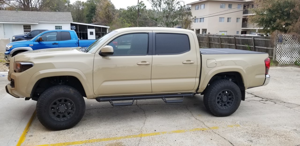

    ^that's a good kit, I just installed one similar except with OME shocks and a single leaf add a leaf. It feels similar to stock but better to me. I got almost 3 inches in the front and about 2 inches in the rear

    Any rake? thinking of doing the same but dont want any rake, i wouldnt even mind the front to sit alittle higher than rear

    I've got about .5" rake before settling.

    It hasn't really settled any more, still about .5" rake which I like. I did the OME 90021 soft ride shocks all around. The suspension feels way superior to stock to me, more firm but better dampening on rough roads/ bumps.

    That is what I paid, and i didn't get UCAs either. It got aligned great and feels awesome now. I can highly recommend this set up if you're not going to weigh the bed down much, because if you were going to add a camper top or a roof top tent then you would probably be sitting lower in the back and at that point the full leaf pack would be a better option. If you're installing it yourself leave yourself plenty of time, it took me and 2 friends 8 hours.

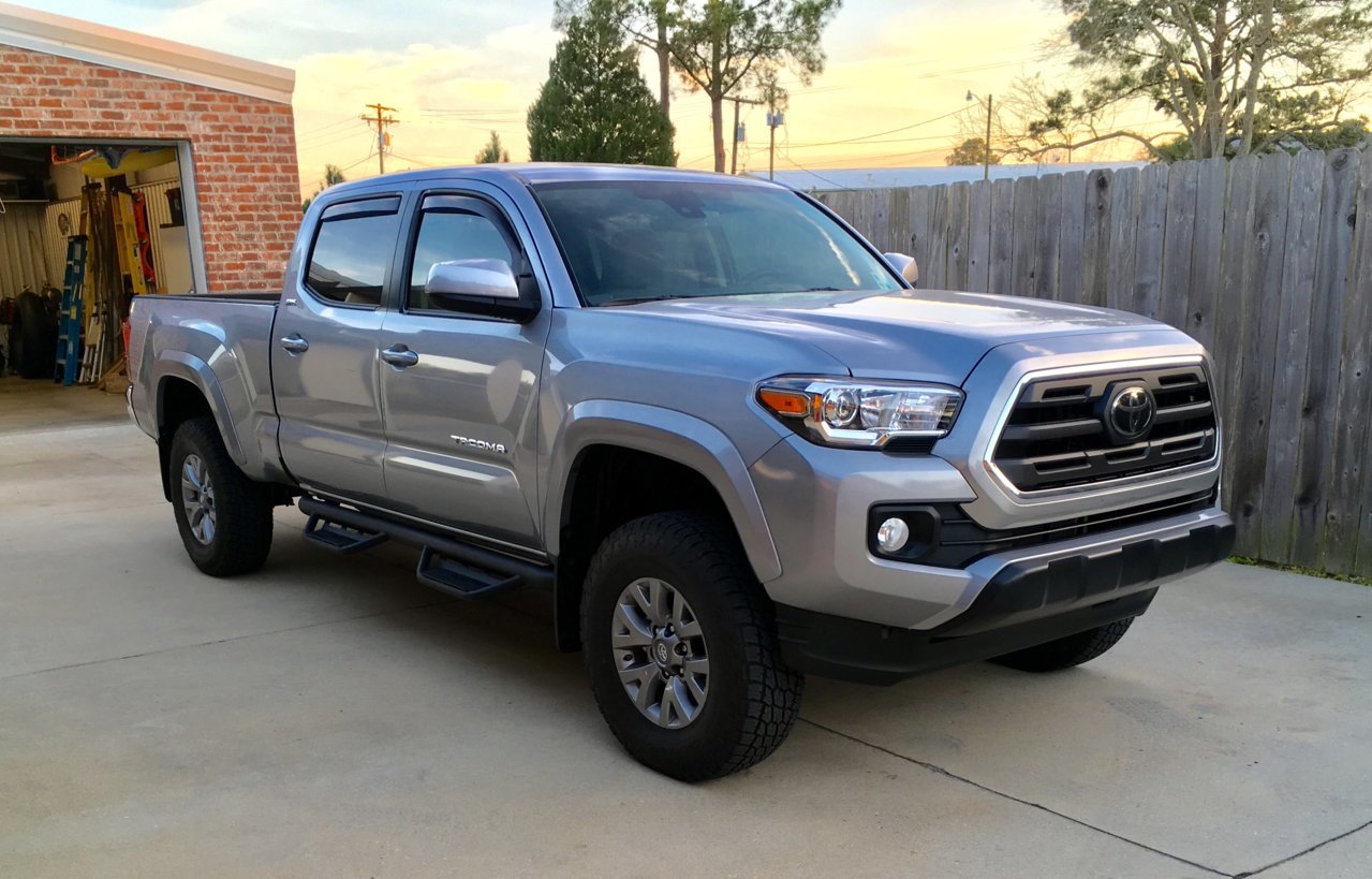

    I just installed an Eibach Pro Truck lift. Gained two inches in front and added 1” block in rear.0FC82A9C-1564-4C69-9B50-DC5385B4D051.jpg

    Nice, looks good. I had a silver sky SR before I traded it in on my SR5
