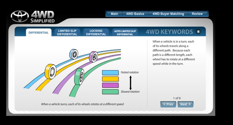

    1. It's ok as long as you are not making "sharp" turns. The driveline will bind because the wheels cannot turn at different rates. I drove from Raleigh to Shoe Creek with Jandrews and had such situations and I used 4Hi without issue, interstates don't turn too sharply.

    A picture for 1.

    The problem lies in the driveline not being able to slip, too much traction at the wheels. If it's a low traction scenario then yes 4wd is fine, just be aware of when you are making turns if the roadway is dry/good traction.

    Terrain that warrants 4wd will also let the tires slip while turning so that you won't damage anything. If you feel like your binding then you don't need 4wd engaged

    You can drive straight on dry pavement in 4HI all you want , it's when you are turning that issues occur
    and you can turn on dry pavement in 4HI , turning sharply is when you can have issues

    The issue you have is that in 4h you always have 1 rear wheel and 1 front wheel turning. If you drive in a straight line on dry pavement, you are assuming that your front and rear tire are being driven by your drive train at the EXACT same speed. There could still be a slight difference in the speed that your drivetrain is turning your front versus your rear wheel, the higher the speed the more difference there would be..... all wheel drive cars can do it because the have a center differential and not just front and rear.
