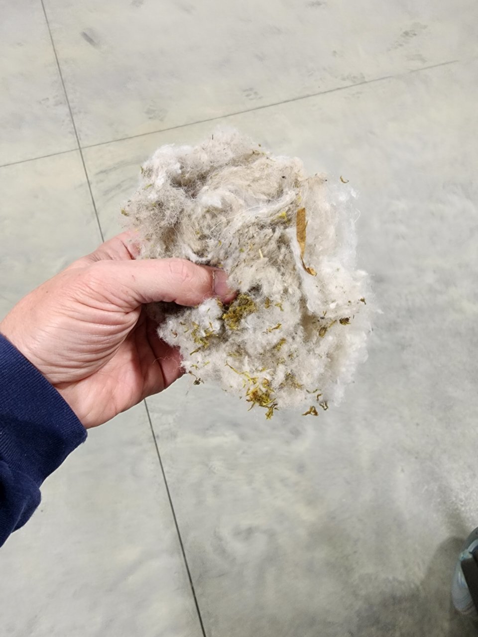

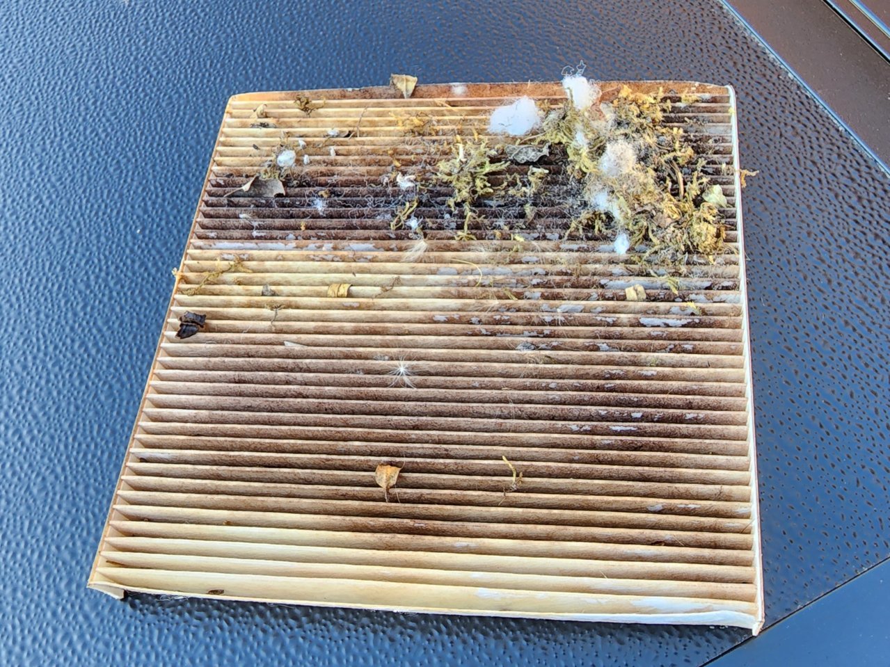

    Monday I brought the Taco out of storage to find that all my efforts to keep the mice away failed. Truck is covered outside and I placed Grandpa Gus scent packets throughout the truck both inside and under the hood. I also frequently sprayed peppermint critter repellent under and around the Taco along with spraying down the truck cover.
    When I uncovered it and opened the hood a mouse promptly asked me what the f*ck I was doing there at the same time I was asking him that exact question.
    I couldn't catch him and didn't see any damage under the hood. I did find that they were nesting on the screen above the cabin air filter. The nest appears to be pieces of the truck cover lining stripped from the cover. I removed the nest, sanitized everything and replaced the cabin air filter. I also placed the Tomcat mouse poison blocks under the hood.
    They have been actively consuming the Tomcat blocks. Today, 3 days later I removed the cabin air filter to inspect. The nest is not rebuilt but there are a lot of mouse droppings on the new cabin air filter. I will be replacing that again once I know the mice are abated.
    I plan on adding sticky traps under the hood today. Any other suggestions?

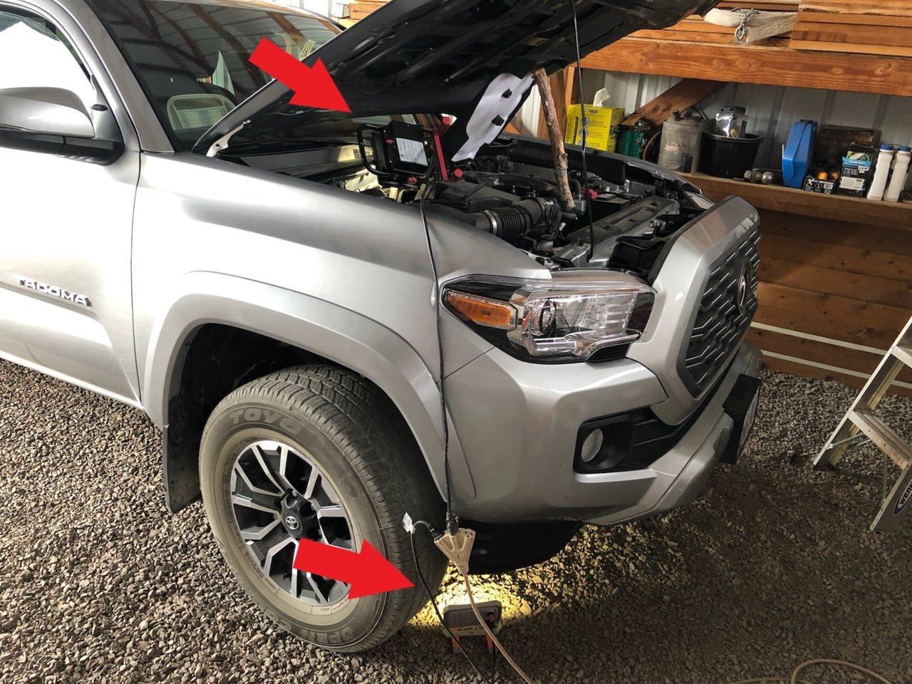

    Make sure you wash your hands really good. That's nasty stuff to be touching.
    I posted this photo on another thread. I use two LED work lights, one under the truck the other under the hood shining down along the fire wall.
    The bright light deters them and other than traps, this is the best solution I have found, and I tried what you did as well as other stuff.
    Edit: I should add I do not like poison. It may kill them, often inside the vehicle or house but, they will stink and dead mice attract other mice. Plus, if you have a cat or dog, or other wildlife around, there's a chance they'll get poison too.
