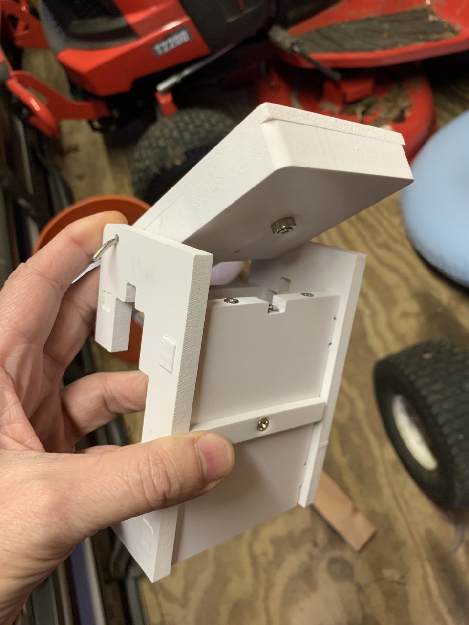

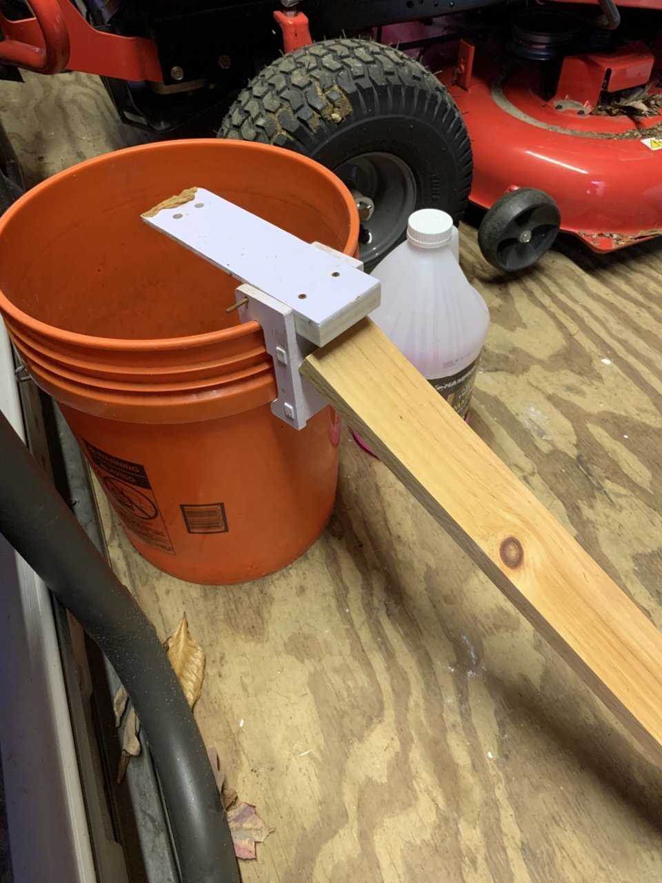

    Don’t know if you want to put a bucket inside your truck but this is what I use in my shed. Cheap easy and I like that it resets itself. Has a magnet on the under side so they can walk out to the end before it releases and drops them in. About 4” of pool antifreeze in it.

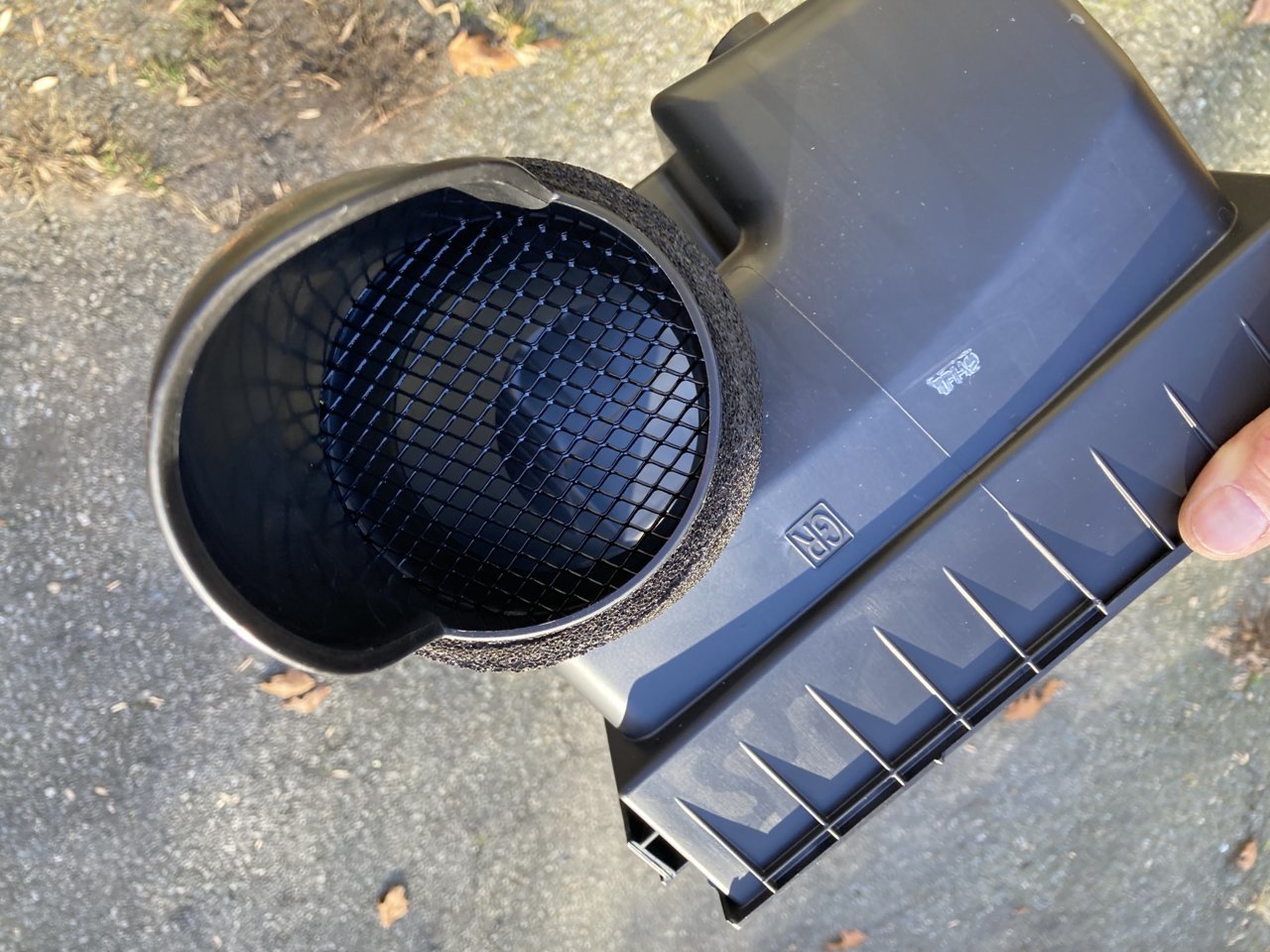

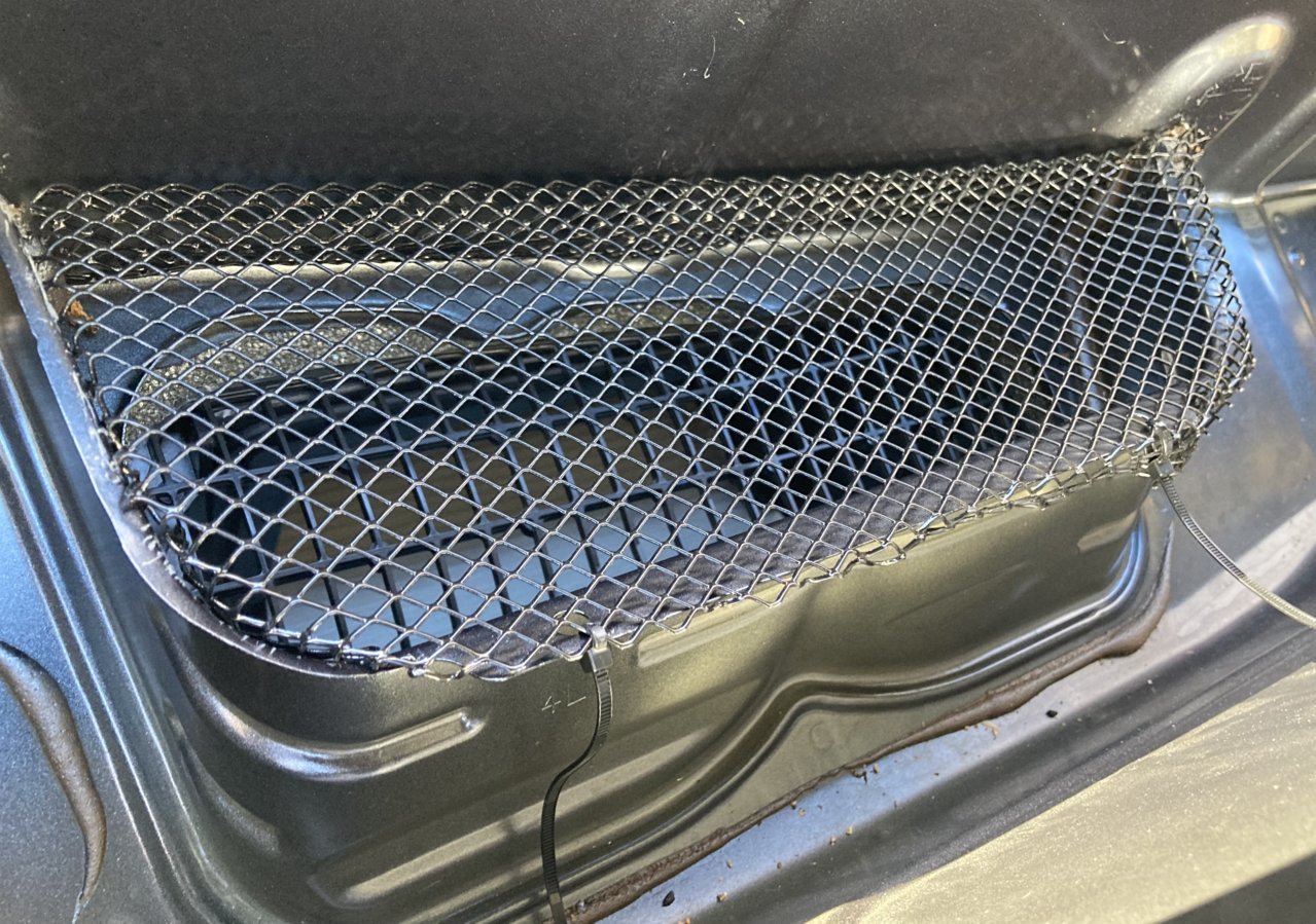

    C1E98721-1ED9-4799-97D5-6CCC09052D71.jpg Here’s a start…have had my SR5 two weeks. First thing I did as I live in the woods…gutter screen from Lowe’s. Mice can get through the makeshift screen above the air filter in the cab through the cowl opening. Can’t get through this. Also put it in the intake. I’ve had them in there before. Another trick I picked up stationed in Germany is predator urine. You can get fox or any other mouse predator urine. Small spray in a different area every week or so. Haven’t had an issue. Did this to the wife’s Outback and my old Forester.
