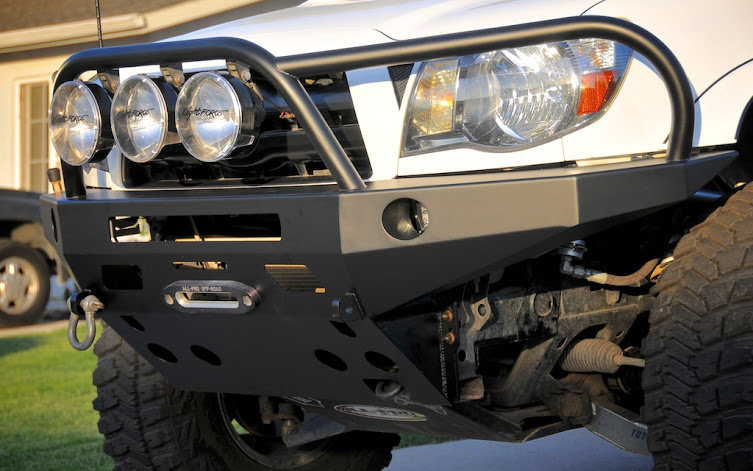

    Hi a buddy of mine will be going over seas in a 3rd world country and he was wondering what bumper would be best for overall protection, but mainly for escape and evasion. Imagine you get into some crap in a dodgy african nation and had to push a toyota van out of your way and bounce off a couple small cars; what bumper would you guys want on the front of your taco?
    Thanks in advance. He really needs some good recommendations. He was looking at ARB.

    Don't have a ton of first hand experience, but the ARB is designed for impact with animals, objects, etc. It is geared more towards expedition and protection than high clearance, recreational off road use. I am sure there are some other manufacturers out there, but from what I know and my previous experience with ARB, it would probably fit the bill as well or better than anything that isn't custom made.

    If you are looking for protection then that version of the All-Pro plate bumper is not what your friend is looking for. The ARB is nice but (1) It has no recovery points (2) It's clearance is not that much better than a stock bumper.
    From personal experience get a full one piece plate bumper with beefy headlight guards. My new bumper fixes all of the issues that my last bumper had. It's (1) stronger, (2) one-piece (3) better clearance for larger tires.

    being just a bit nitpicky, but the biggest problem with that AP from just looking at it is that the fairlead is at an angle. Your winch line is constantly dragging over the top of the fairlead.
    With how much space there is, I would have liked to see a more squared off face with the option to mount the winch in the feet-forward position, which is the strongest possible placement for the winch (if you look from the side, feet first means winch is pulling forward instead of trying to rotate forward). It's a minor point and I have only seen one bumper actually allow for that option.
    I very much agree on all Grimm's other technical points. Note also how Grimm's has cutouts for hi-lift usage and a large viewport for the winch line.
