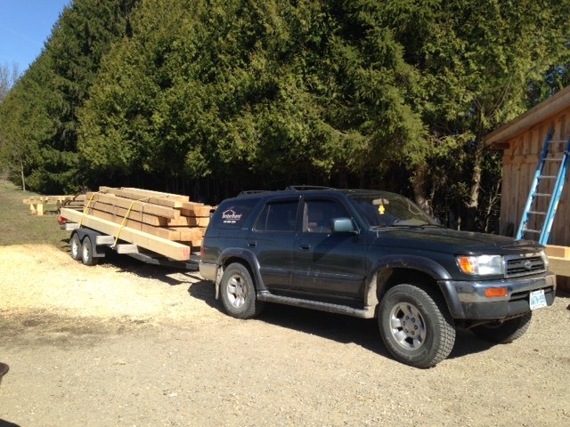

    I used the 4Runner for hauling timbers from the mill before I bought the Tacoma. This load was a whopping 6000 lbs! Most loads were no more than 5000 lbs. It had the 3.4 but was a strong truck... just not real speedy. The truck had rubber stops to limit the sag. Yes It had a brake controller.
