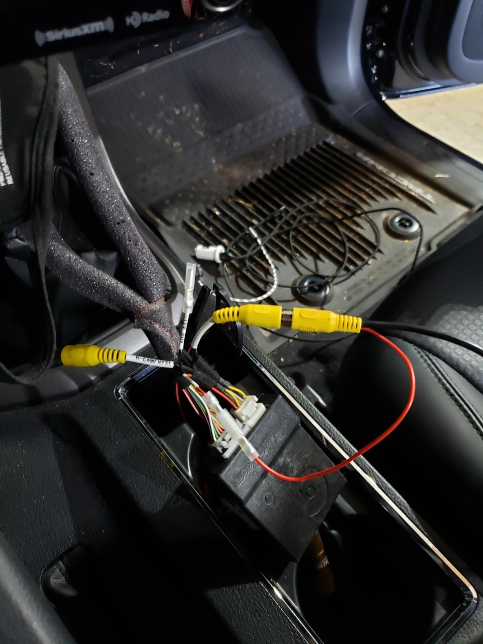

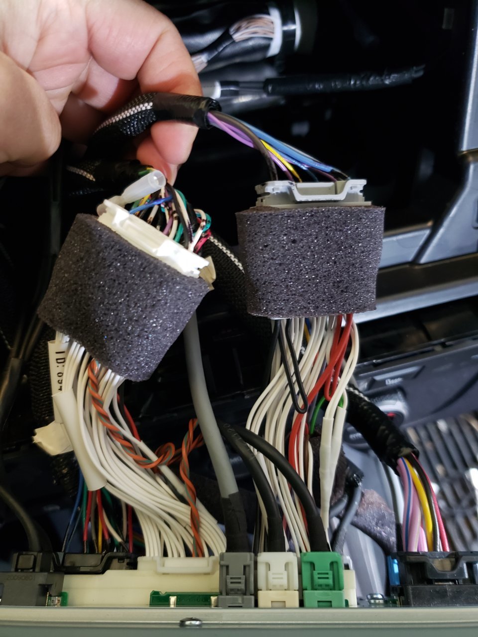

    Tried installing the germes lab camera system and I can't get the thing to work. I've got the latest version for entune 3.0 and a natika camera.
    Here's some pics of everything connected, but no picture (front or rear) pops up once the battery is connected and truck is turned on. What am i missing?
    1st attempt used the red wire near the yellow connector.
    2nd attempt used the black and red wires that were bundled closer to the camera.

    His Germes Lab is not the updated one, so his harnesses look different from the one I got. I checked his channel to see if maybe his camera setup was similar to mine, but it looks like he's also using a different Natika camera than the one I got too.

    Have you tested the video output of the Natika camera into a TV with RCA video in? This would confirm if the camera is even working?
    Use the + and - at t camera to power.

    I didn't, but I did get it working though. Turns out dip switch 3 was 'on' instead of 'off', so once i turned it off everything worked out.
