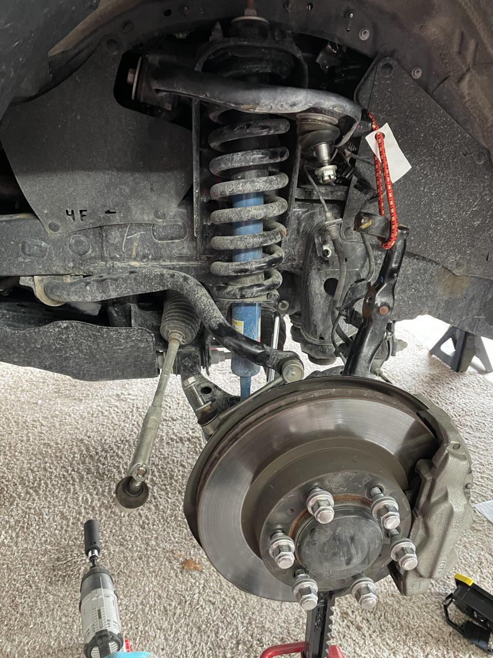

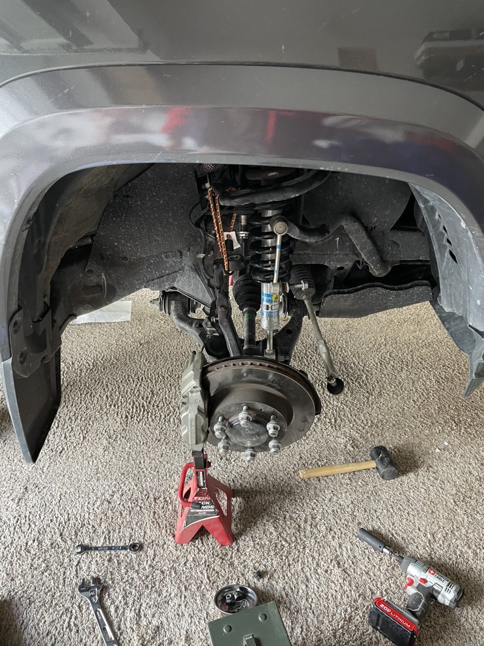

    I did 2:1 on Saturday, cost me around 200bucks. 5100 used ( 8k miles) from TW for $150 and 1inch sold steel block $50.
    If I don’t like the ride quality I can alway back to stock.
