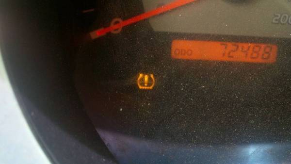

    This light popped up last night and i haven seen it before. i dont have and owners manual so can someone let me know please and thank you.

    check your tire pressures

    TPMS light. I think it goes off if tire pressure drops under 40 psi or somewhere around there.

    Dumbest warning light ever. It looks nothing like a tire, or anything else remotely helpful to identify the meaning behind it. It looks like an oil lamp.

    Thats the random combustion warning light

    it's an exclamation point inside a bloated tire. Trying to design a universal symbol understood by anyone who drives a car is a task I don't want to be in charge of.

    TPMS light, most likely its your spare.

    mines been on for a year and a half lol.

    it's a broken sensor. all tires (including spare) are good. im not paying to replace it. don't really care to pull the light out. so i just get to see it flash every time i turn on my truck. you get used to it. . hell, i'd probably miss it if it went off at this point haha.

    i notice that if i correct my tire pressure after seeing this thing, it comes and goes. then i learned how to reset it... hold that button down under the steering column (makes sense to me)

    Awesome thanks guys. didnt even know the taco had tire sensors. TW all day.

    try holding the button in until it blinks and goes away?

    You can always cure it with a small piece of black electrical tape on the plastic cover.
