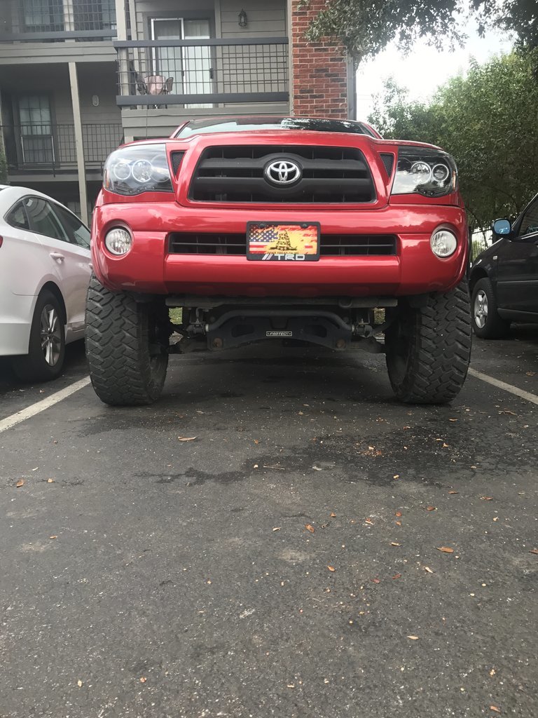

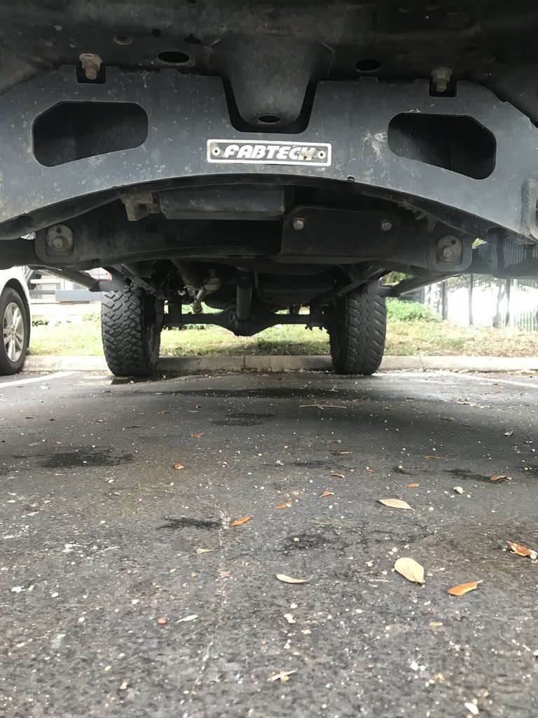

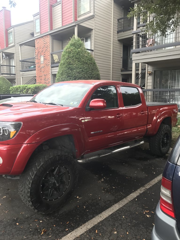

    Put some pictures of your truck from the front/side and your suspension. Also I would like to see what they did with the differential using that kit.

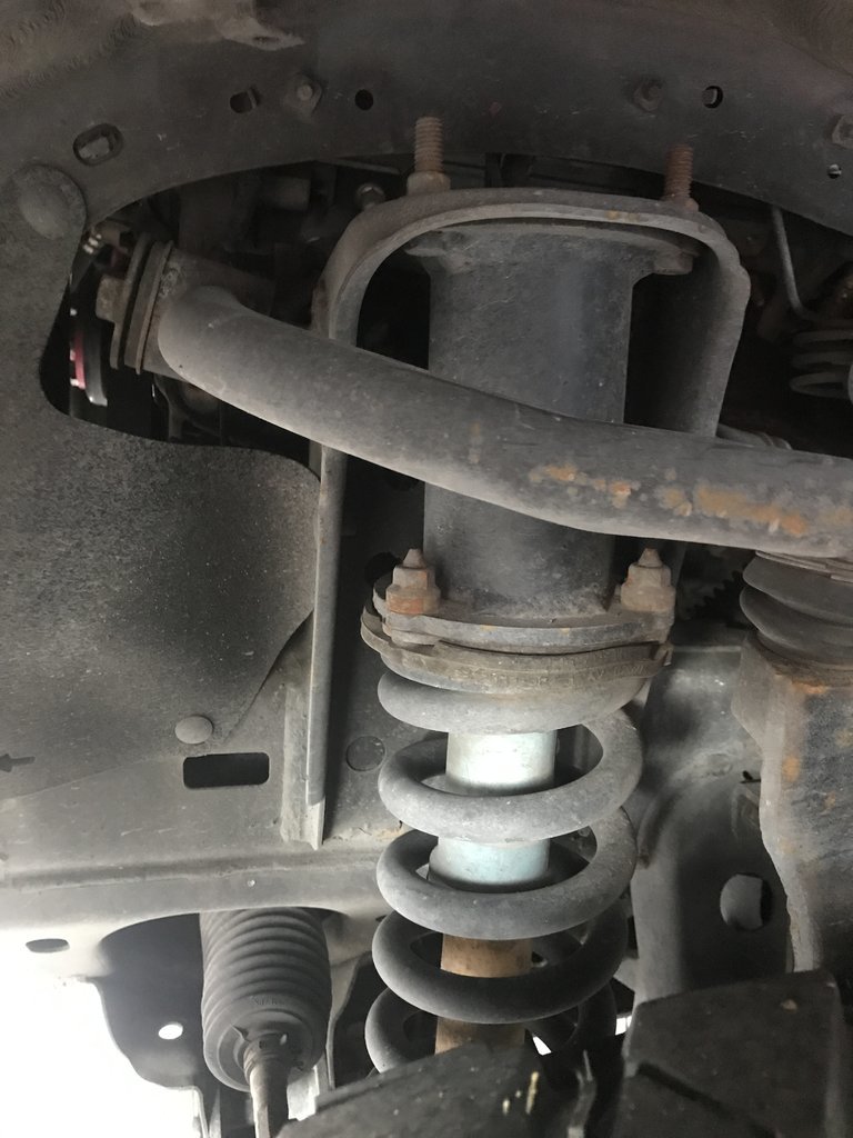

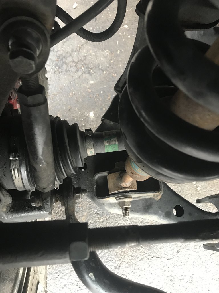

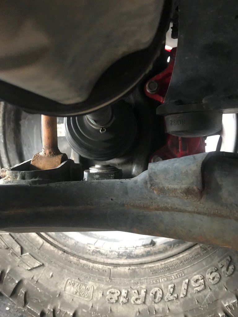

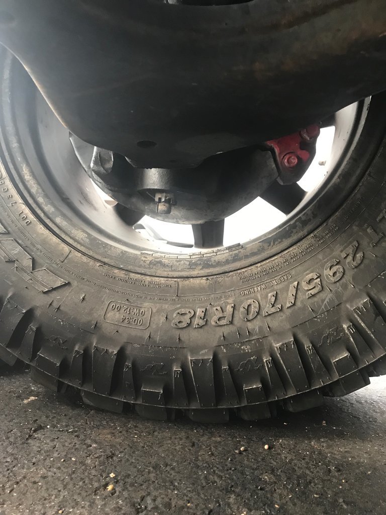

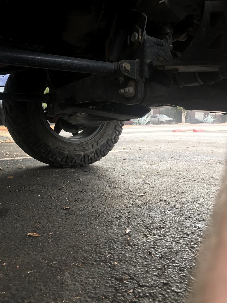

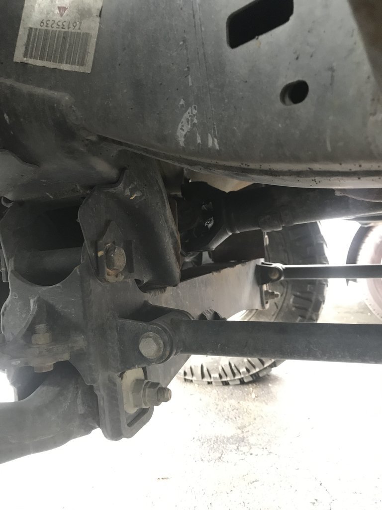

    Here are the pics hopefully it catches all of your angles you wanted to see
  12. Sep 24, 2017 at 3:12 PM
    #32
    TacoTRDSport4.0
    TacoTRDSport4.0 Member
    Feb 26, 2017
    #211746
    15
    2010 burgundy red Tacoma TRD Sport 4.0

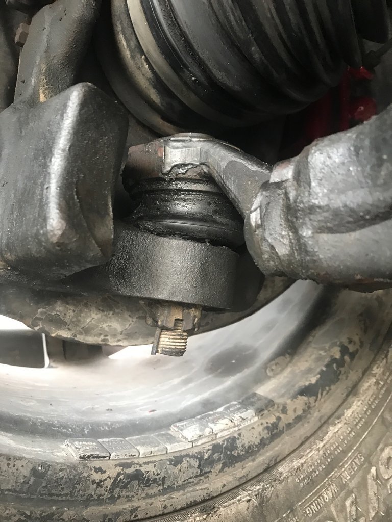

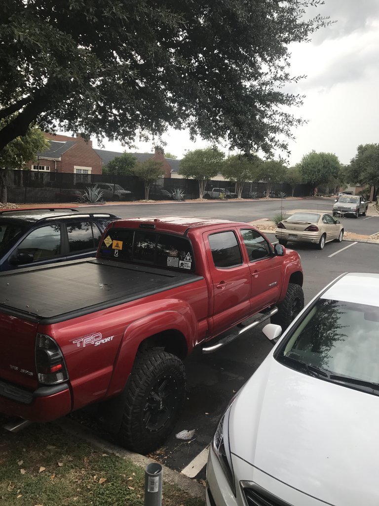

    And the rest of them

    Your first pic suggests a bend spindle.
