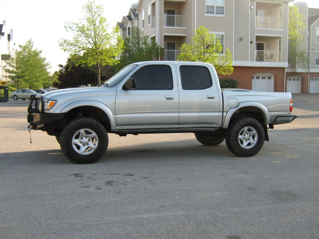

    5100's w/ Eibachs, Front sway bar in trash mod, Diff drop, 265/75-16 Duratracs or 33x10.50 KM2's on 15x8 wheelers steels, ARB front bumper, Warn VR8000 winch, Trailgear sliders, Allpro rear bumper, Sky Offroad E-Locker guard, Sky Offroad weld on differential guard, Savage skid plates w/ Budbuilt cross member, e-locker rear, ARB air locker front, 4.56 gears, bought it from my mom who bought it new :-D
    I have the same bumper and a warn 8000lb winch and this is how my truck sits with 5100's and eibach coils. The tires are 265/75's which are a similar size to 31x10.50's. I also have full skids which probably weighs the front down a little more too.
