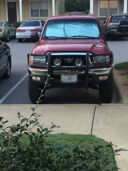

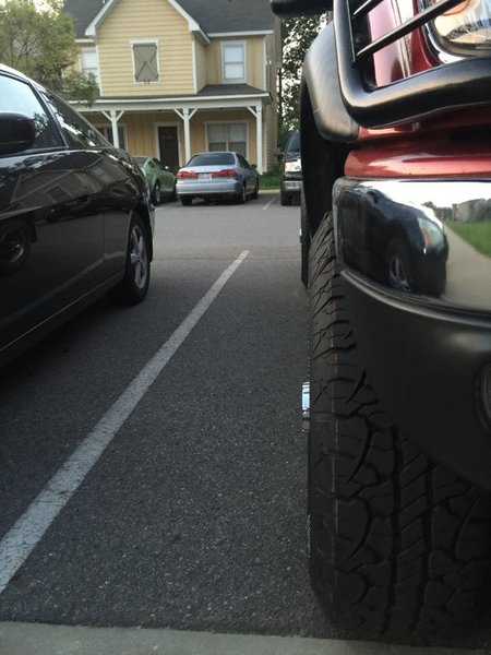

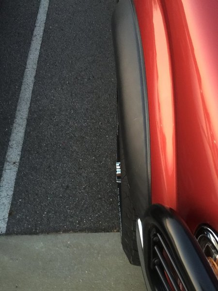

    I just put on a 3" OME lift and new wheels on my 2003 Double Cab in mid July. I am wanting my tires to either actually be a little wider, or stick out of the fenders a little more to give my truck a little wider stance.
    My wheels are ATX AX324 Assault Black w/ Mach Lip; 17x8, +12mm offset, 4.92" backspacing. I currently have 265/70R17 on.
    I want to put on 285/70r17... Will I have any rubbing? Worried about the UCAs mainly. Also do you think my tires will stick out enough (wanting about 0.75-1")? Wheel spacers?
    Anyone with a similar set up, please post pictures!

    You shoulda gotten wheels with smaller backspacing. I wouldn't recommend wheel spacers...

    I have been reading a lot about wheel spacers and I don't think I'm going to get some. Do you know what backspacing & offset to get if you want them to stick out a little?

    i havent heard of anyone having an issue with wheel spacers/adapters under 2" on a tacoma. The 1.25" spidertrax spacers seem to be the most popular and is what i would go with.

    Stock wheels are 4.6 bs

    So will around 4.5 backspacing make them stick out an inch or so? Or do I need to account for the offset of the rim also?
    I don't really understand the whole backspacing/offset thing...

    If you are wanting 285s I believe you will need at least 4 bs if I'm not mistaken

    Yes. 5 is tucked in. 3 is bearing slayer.

    Cool. Seen so many Tacomas with a little more tire profile showing. They have a good stance that way I think. So they must have rims with less than 4.6" backspacing then! Now let's see if I can commit any of this to memory. lol

    If you're a 2nd gen, i think I remember seeing that they have 5 or so bs.

    So what I got from the diagram is that offset will push the rim in or out further in the wheel well... sticking the wheels out a little from the fender
    Negative offset, the mounting surface of the rim is further out (to the shocks/body/ect.)
    Positive offset, the mounting surface of the rim is closer in (to the shocks/body/ect.)
    And backspacing is more for clearing the UCAs???

    I wouldn't be discouraged about wheel spacers just because internet warriors give their opinion. I love my stance.
    I wheel my truck and have been running 1.5" synergy spacers for miles, no issues. As long as they're hub centric and I wouldn't recommend anything past 1.5"
