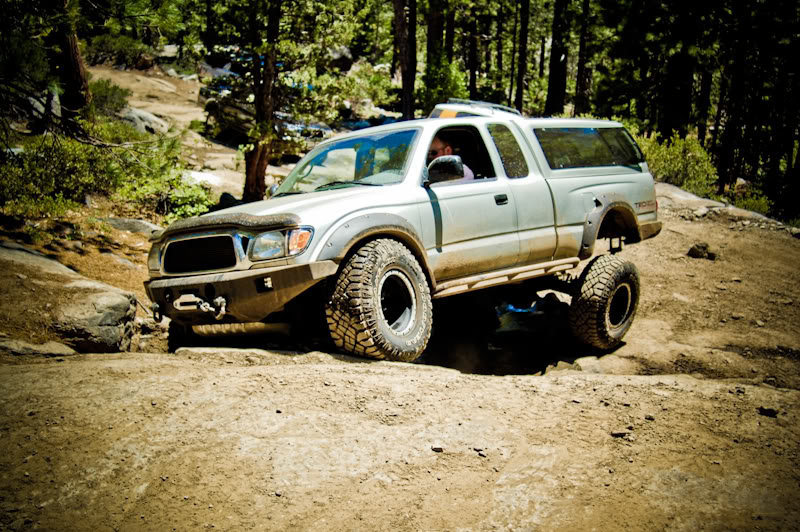

    I'm running 10" 5150's relocated like / \ and I can fully droop the springs and still have shock left over. Really the only way to get full use out of your springs is to relocate your shocks. triangulated works great if you don't want to punch holes in your bed.
    That's just about full droop with brand new Expos they flex out more now that they are broke in.
