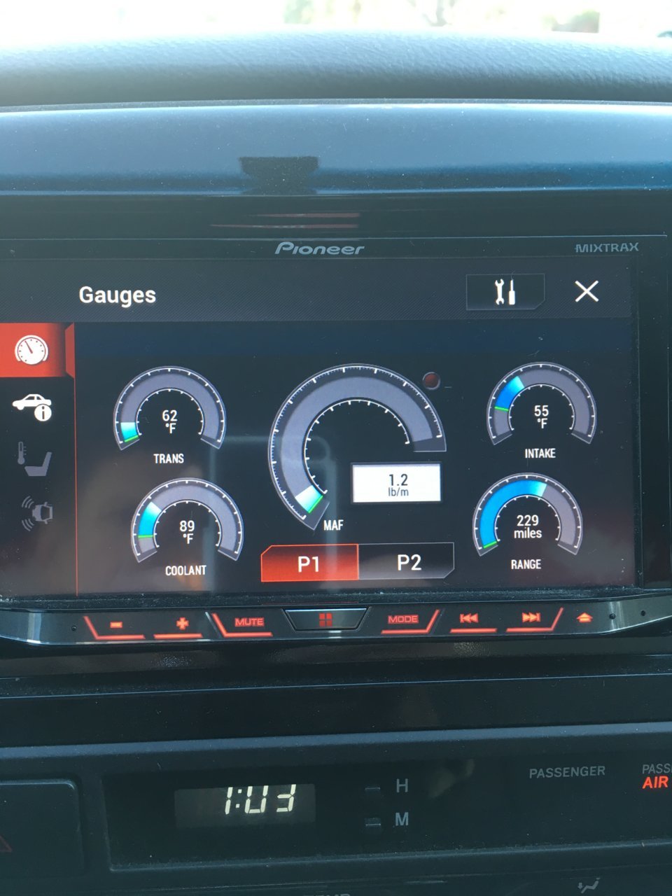

    Use the app OBD fusion then a ten buck OND plug and get temp and everything else you want

    Thanks. I want to keep an eye on what temp it gets up to and how much it will cool down when the cooler kicks in. If it’s not enough after a few runs with the trailer I’ll look into replacing the cooler.

    Damn! I was thinking about just keeping my stock unit until I saw this. I'm assuming that you can display boost as well?
