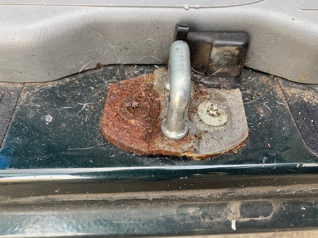

    And not having a lot of luck finding the correct diagram. Anyone know exactly what this TacomaDoorStop.jpg part is called and or have the part number?

    Door striker, dunno the part number. is that the bottom rear door?

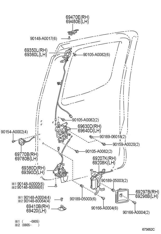

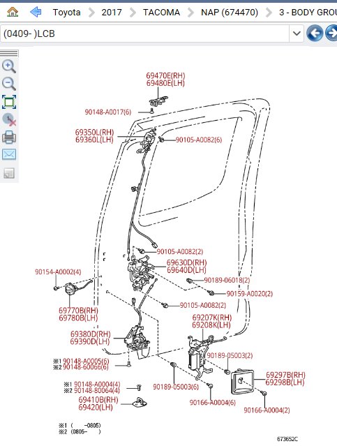

    This may help. A possible part number
    This one may be more accurate. I did t realize that was the bottom of door

    Looks like the rear door striker. 69420-35050 is the correct part number .

    69420, lower strike, driver's side access cab. Thanks guys! I pulled mine off and cleaned it with an abrasive fiber disc on a die grinder, then painted the bottom with Rustoleum. I'll put that back on for now and maybe and get the new one sometime... they are $7.04 online. If any of you do this beware that the bolts are very tight, even with an impact. I sprayed them then tapped with a hammer and even then they bound up before they came out. so back in gently, more spray, more tapping, try again. I got them out without breaking one or mangling the star drive bolt heads. Going back together with anti-seize.

    I use EvapoRust on small parts like that to remove corrosion, and depending on how severe the service it will see it may get primed with POR-15 prior to topcoating. I’m a fan of both of those products — they work beyond expectation.
